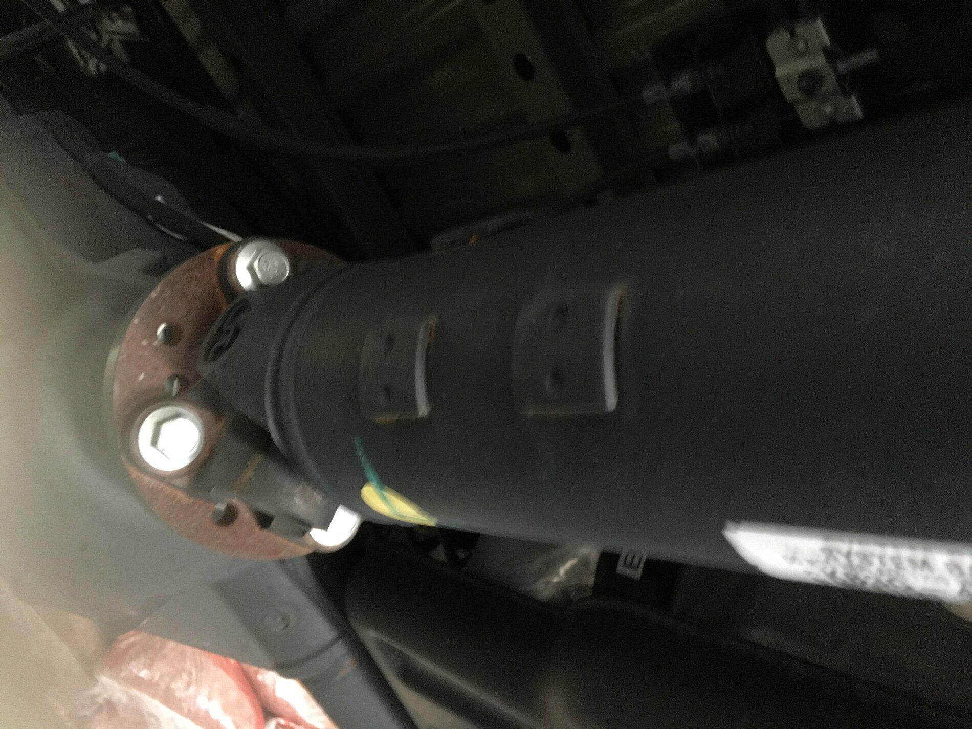

If I had to shoot from the hip (I am a lousy shot), I think you may find a U Joint in the driveshaft is defective...We have has similar problems that were tracked to a U Joint being tight due to a roller being dislodged and trapped by the U Joint cap. Normally this is fairly easy to pull the driveshaft and when laying on the workbench, move each joint through its range of motion. If any joint shows sticking or high efforts....replace that U joint.
The other thing is the driveshaft could have thrown a weight as they are spot welded on to the shaft. Inspecting the driveshaft should show an outline where a suspect weight was thrown, but not always. There is a process you can do wrt driveline imbalance. Get two hose clamps (we call them tangential screw clamps) and install on the driveshaft near the rear axle companion flange with the clamp heads side by side. Mark the clamp head location on the driveshaft with a Sharpe pen, piece of blue tape or what ever. Now drive the vehicle....Probably will be worse. Now clock the pair of clamps around the driveshaft about like a clock, starting at 12, then to 1 and then to 2 and so on, Drive and evaluate at each position noting better or worse from the 12 position. Mark each locaton and make the 12 starting location unique so you know where you are in this process At each mark for clamp head position, note with a B or a W Better or Worse....Okay you now have clocked the twin clamp heads around the driveshaft and are ready to relocate to the location that was best....now here is the fine tuning. When at the best location move the clamp heads equal distance, one head clockwise and one clamp counter clockwise. Evaluate if getting better, move each clamp in its direction equal distance again. You should fine tune to the point of achieving balance. If the clamps are 180° apart....you just wasted your time as the driveshaft is not the problem..... I have used this process with very good success several times when on the road development away from my NVH equipment. Takes all day but what the hey!

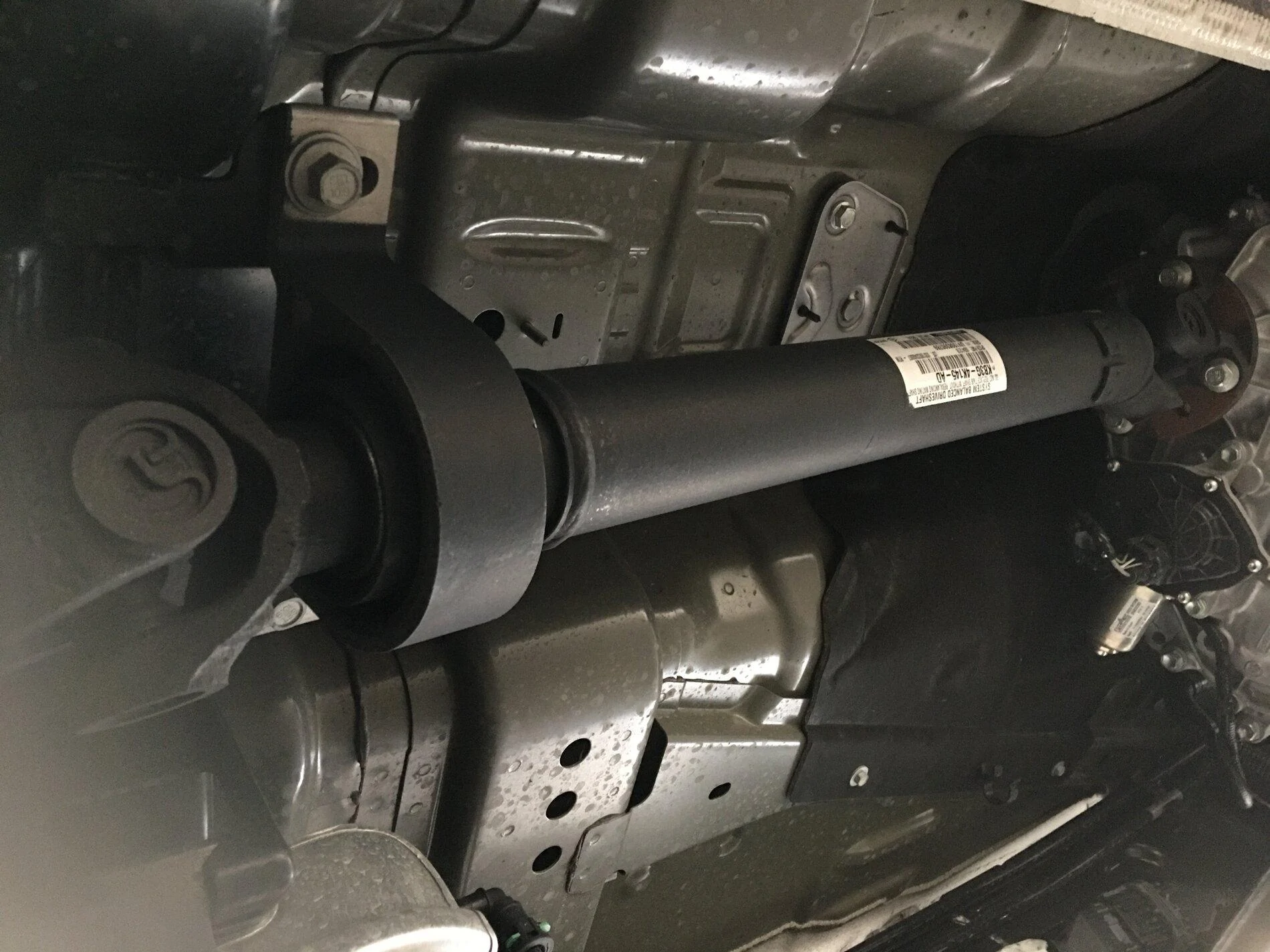

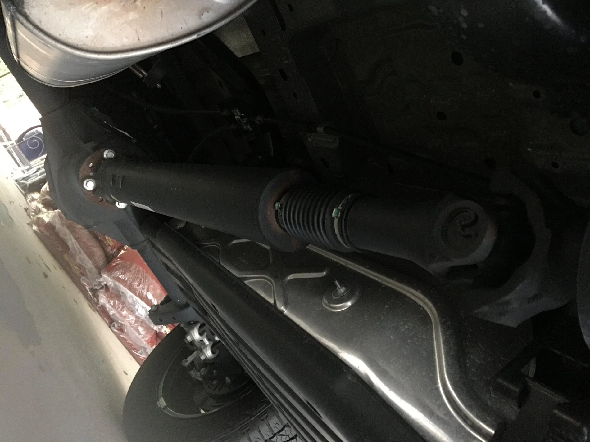

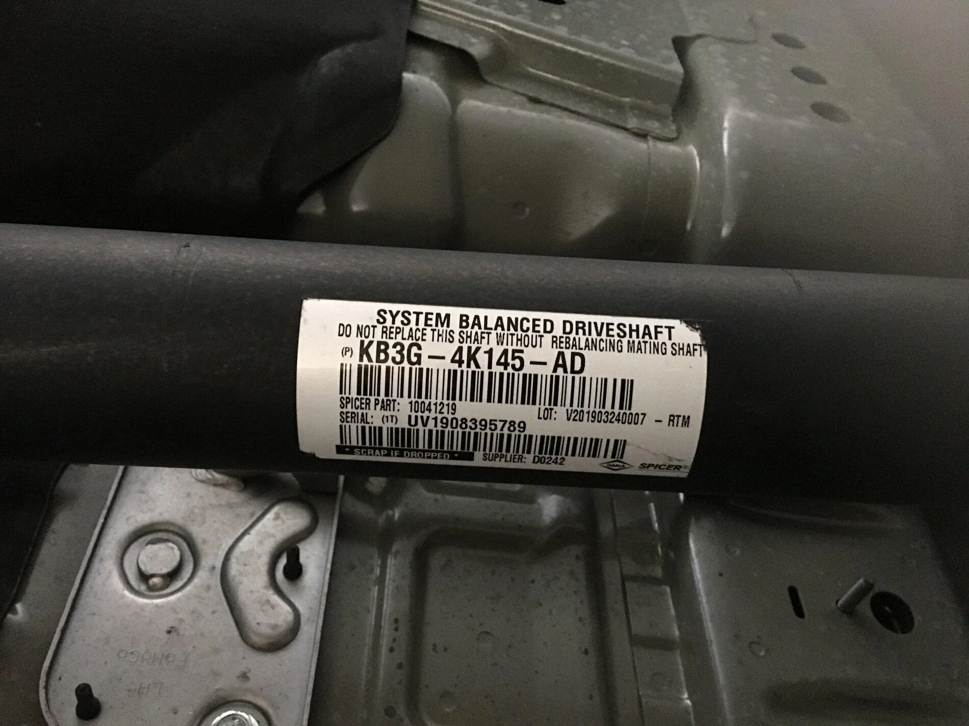

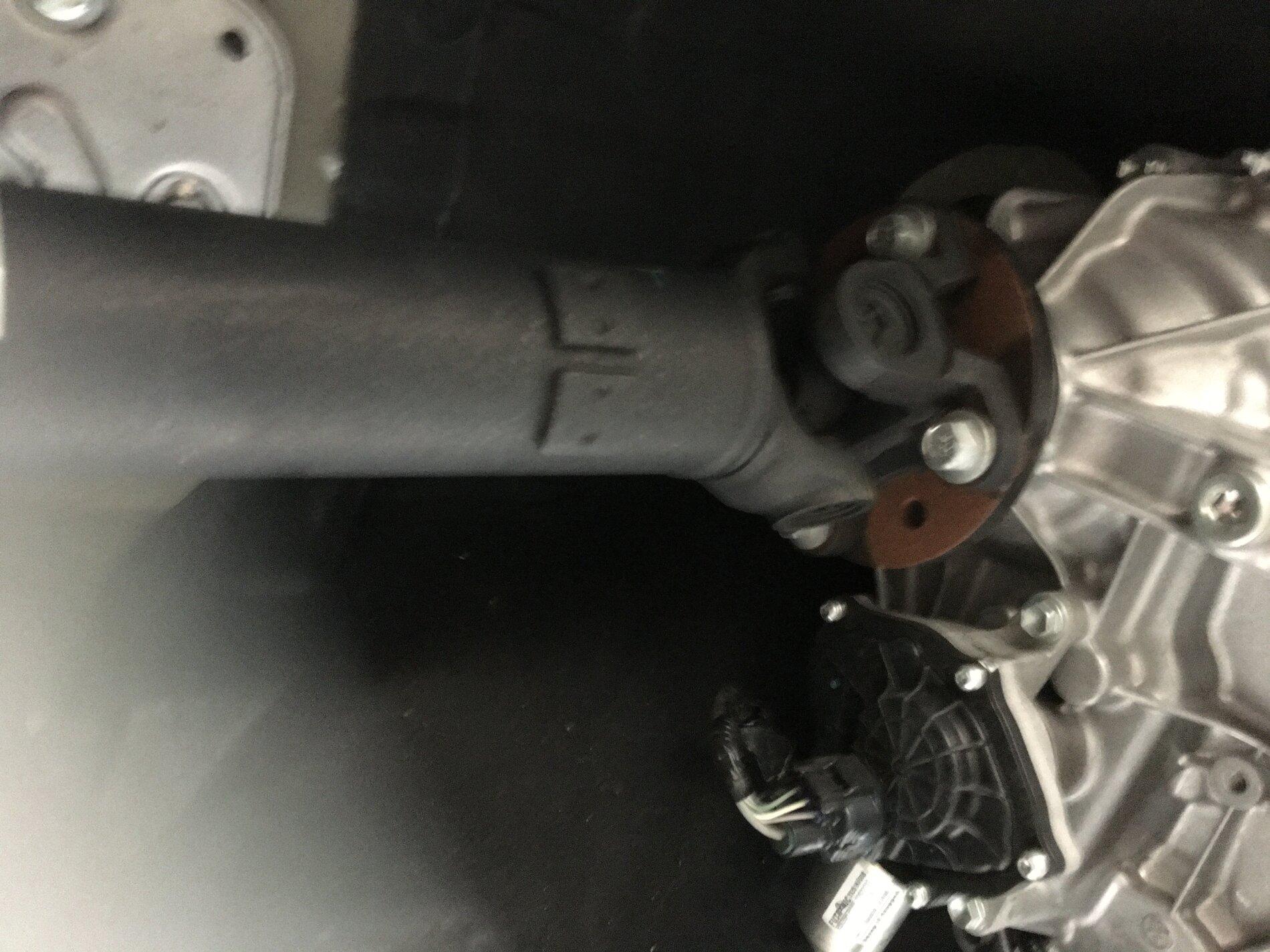

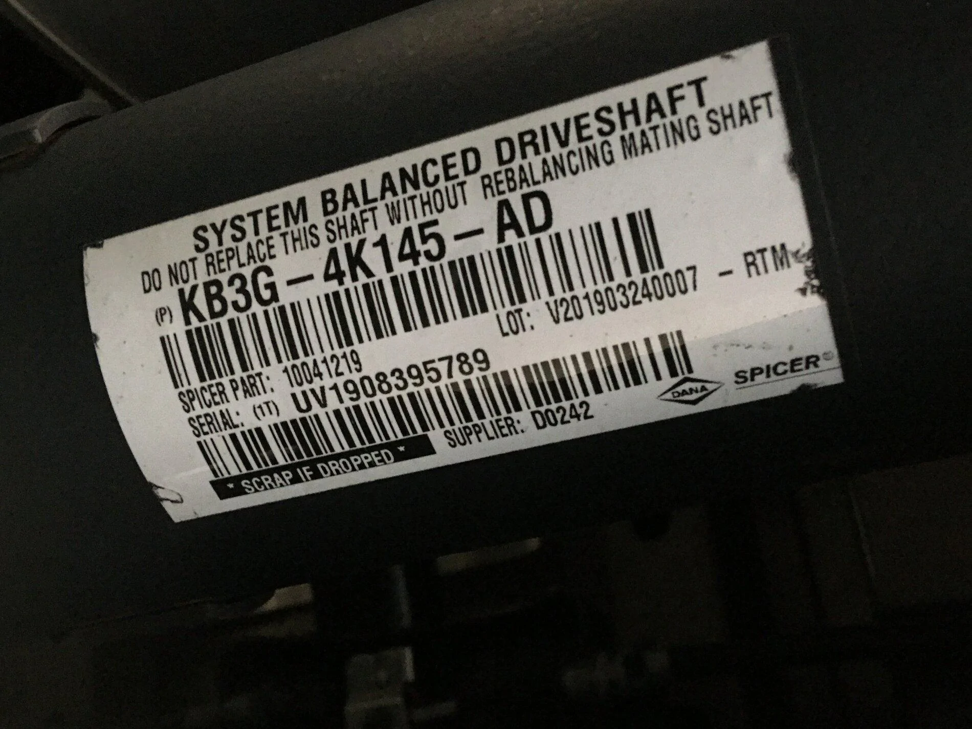

I am taking my Ranger in to the dealer on Tuesday and want to be armed with as much info as possible before I go. I read in another thread where there was concern about the driveshaft being out of phase. I crawled under the truck, and using the photos in the other thread as a guide, my rear shaft appears to be out of phase by about the same amount as the one in the other thread. The front shaft is apparently in phase. It appears there are a fair amount of weights on there and I didn't find any places where any had come off.
I saw parts identification stickers on both shafts, along with a yellow dot with two lines on it. The stickers were spotless, and begs the question, has someone already replaced them? How could I find out? The vehicle has been in service for 7 months and has just over 13K miles on it.
I did not find any places where missing weights might have been. Should I say anything to the service writer about the driveshaft? I intend to make him drive it so he can experience the absolute joy himself. Is my description of the ride being jerky accurate enough to guide them to the problem.

Hi Bill,
Unfortunatly your description is much too vague for the Tech or Service writer to diagnose. Sort of like you visit the doctor and say "I have a pain".... What I advise is to really do a mind dump on the service writer, being as accurate as you can to help radar in on the suspected problem. You do not need to say the driveshaft is the problem as it may or may not be the problem. Describe what you experience in detail. "I am at a stop light in heavy traffic when I start to move, there is a very noticeable shaking of the vehicle until I reach a speed of 20 mph" helps a service writer or tech. Does this occur when the engine is cold or hot or both? The techs have instrumentation that can help them trace the excitation source and you might suggest that these instruments be used for diagnosis. If you focus on the driveshaft for example...you give them an out to say it is normal and they all do this.
When I have been dispatched to a dealership with a complaint vehicle, it is very hard to pry the info from customers as they do not deal in engineering or technical terms in most cases, so I ask tons of questions. Normally this will direct me to the root cause....not all service writers are skilled unfortunately so it helps to give them as much info as possible. Does it happen on the same road every day for example in the same place?
Hopefully you get my drift. The ride being jerky could be wheel balance, driveshaft related, rear suspension or front suspension related, tire pressure related etc...way too vague, eh?
