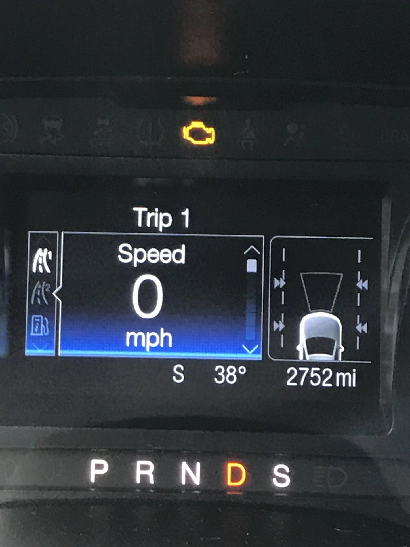

Uh ohhh. This just came on. Truck is running fine and everything works. Guess I’ll be calling the Dealer.

Called my local dealer and he said as long as it was running good nothing to worry about. Earliest they can get me in is next Monday (?!).
Well, this morning the light is out. Guess I’ll watch it for the next day or so and if it doesn’t come back cancel my appt.....

Alan I would still go to the dealer and get it documented. It might be injector code that they expect to fix in the future. Bret
7,085
37,253
Hi Alan
I agree with Bret....get it to the dealer for documentation as my expectation is that this will recur in the future, even if it is an unseated connector some where in the electrical system...

Thanks for the input. Yes, I’ll keep my appt and take it in on Monday.

The light will reset every 3 or 4 key in, engine start events. Interesting that if it is a fuel injector, it's reared its ugly head now. My first CE light came on at 62 miles on the truck.
My service tech told me my CE light had a history dating back 59 days (back to the day it was built). That might be something you ask the dealer is for the history.

My CEL has come on 4 times in last 10 months for injector code,including the first day I owned the truck and came on last week while the dealer was working on the door locks unlocking by themselves. Dealer said Ford is setting up a fix. Bret

I had a total of 38 CE lights over the course of 3 months before the dealer decided to do the TSB, which I urged for because I had already been waiting over a month for a fuel injector to come available.

I will definitely be keeping my appointment as the light came back on today on my drive home from work.

Well in the past we could say check the gas cap....and you would check and it would be loose and you snug it and light would go out...
now we have no gas cap..
Let us know what dealer finds. Good luck.

Picked up my truck this morning from the Dealer.
My CEL was a known code - P02F1 which had a TSB (19-2320) associated with it.
Reprogrammed the PCM and all is good.
