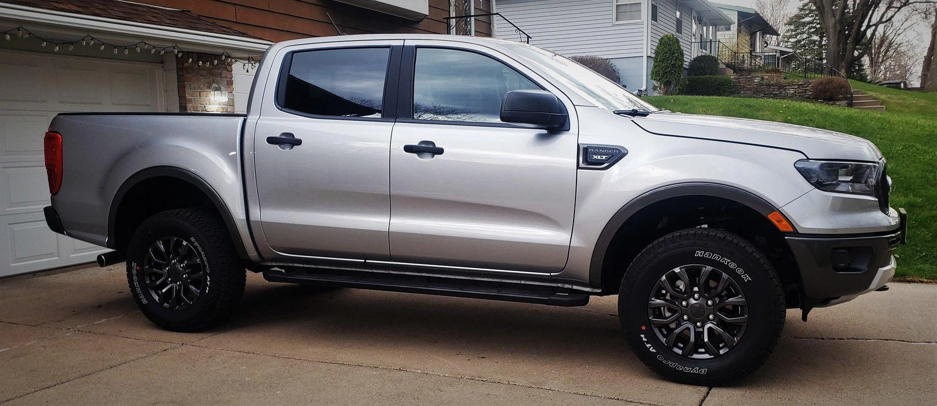

can I add to this
mine was built feb 2020 and I bought it 1 month later
what I feel is a misfire and also you can here it sounds like a sewing machine, it shutters that you can feel and hear, also I have traction light comes on and cuts power when you kick it down on the highway, not good almost killed 20 people when I could not complete a pass, I took it to the dealer and they told me it was the bigger tires and I told him to actually do some diag before just blaming the mods, so he took the tires off my truck and swapped with a new truck and still does it.
according to him, mine and 2 of the trucks on the lot do the same thing. he told me ford said that's normal, hahhahahhahhaha. I have been in shops for the last 30 years and that aint normal.
also I have a 2019 ecoboost mustang and a 2019 explorer 2.3 that are both super smooth motors, so these problem we are having are not normal. all dealer tell you they have never heard of the problem you bring to them, also if there is no light I can assume they will not look for miss fires because ford wont pay the time,
