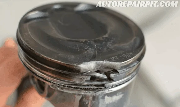

This is the kind of damaged caused by pre-ignition or 'pinging'. Still think 93 octane isn't worth the price?
Nope I don't. The severity of the detonation that caused that damage wouldn't have been prevented by using 93 octane.
The bottom picture looks like the damage that would have been caused by Low Speed Pre Ignition (LSPI). It is a phenomenon that can happen in direct injected turbo engines when you have high boost at low rpms. It is so severe that it will rattle your eye balls and scare the crap out of you if it happens. It can be exasperated by using motor oil with a high calcium content, that is why it is very important to use only SN+ or SP rated motor oil in a DI turbo motor. They have been formulated to minimize the chances of LSPI.
Should have seen this piston I pulled from my '72 Honda motorcycle in high school. Started pinging badly, then blew a hole in the top of the piston.
I never said it wasn't worth it. I said Ford shouldn't rate the engine for 87 if that ^^^ is going to happen.
