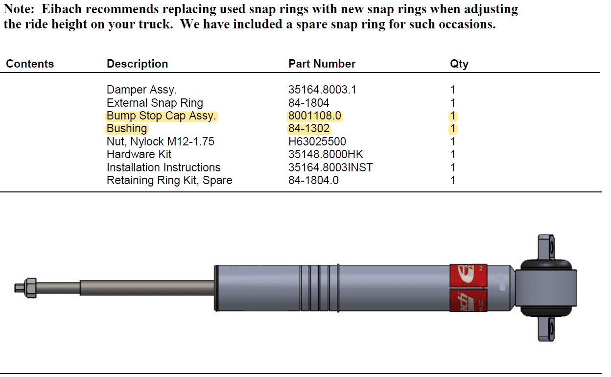

Well, after Stage 3 lost my first order that I placed on Black Friday, the Fedex truck finally dropped off a box from Eibach on Wednesday. I opened the boxes, which are marked correctly with 2 fronts & 2 rears, to find I received 4 fronts. I called Stage 3 and they told me I had to send an email to their RMA department, with pictures, and that I should hear back from them in 1-2 weeks to find out how to resolve this! Totally unacceptable! I have never in my 56 years received the wrong item and had to wait to get an RMA and most respectable businesses would ship out the correct item as soon as my RMA items shipped. They laid the blame on Eibach, but I reminded them I didn't buy them from Eibach, I bought them from Stage 3 Motorsports. I am guessing at this rate it will be at least several weeks before this gets corrected. Well at least I have the fronts, I hope they are for a 2019 Ranger.
Did anyone receive 4 rear shocks?
MotoWojo
Jan 13, 2019
324
412
Mustang
Looking at the 4 "front" shocks I received (incorrectly), there is no hardware in the 2 boxes that were marked as rears. The 2 boxes that were marked as fronts have everything except what i highlighted below, can anyone tell me if they received those items?
