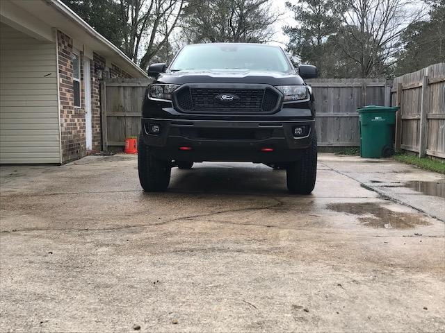

@Kellan81 that looks great! Did you use the Eibach shocks or blocks in the rear? My replacement strut is supposed to arrive Monday so hopefully I’ll have time to put them in soon!
Didn’t use the eibach shocks/blocks for the rear. I wanted to see how it was going to sit before I decided to purchase blocks.

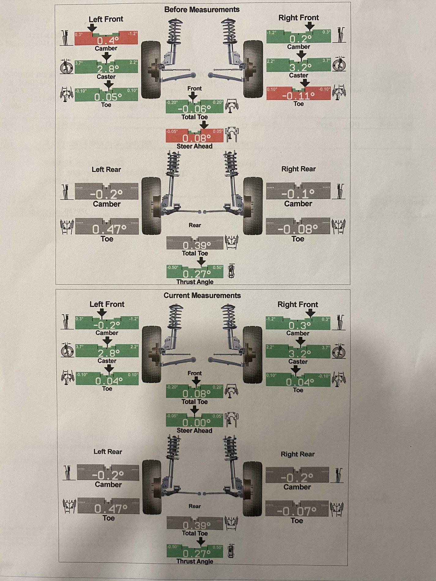

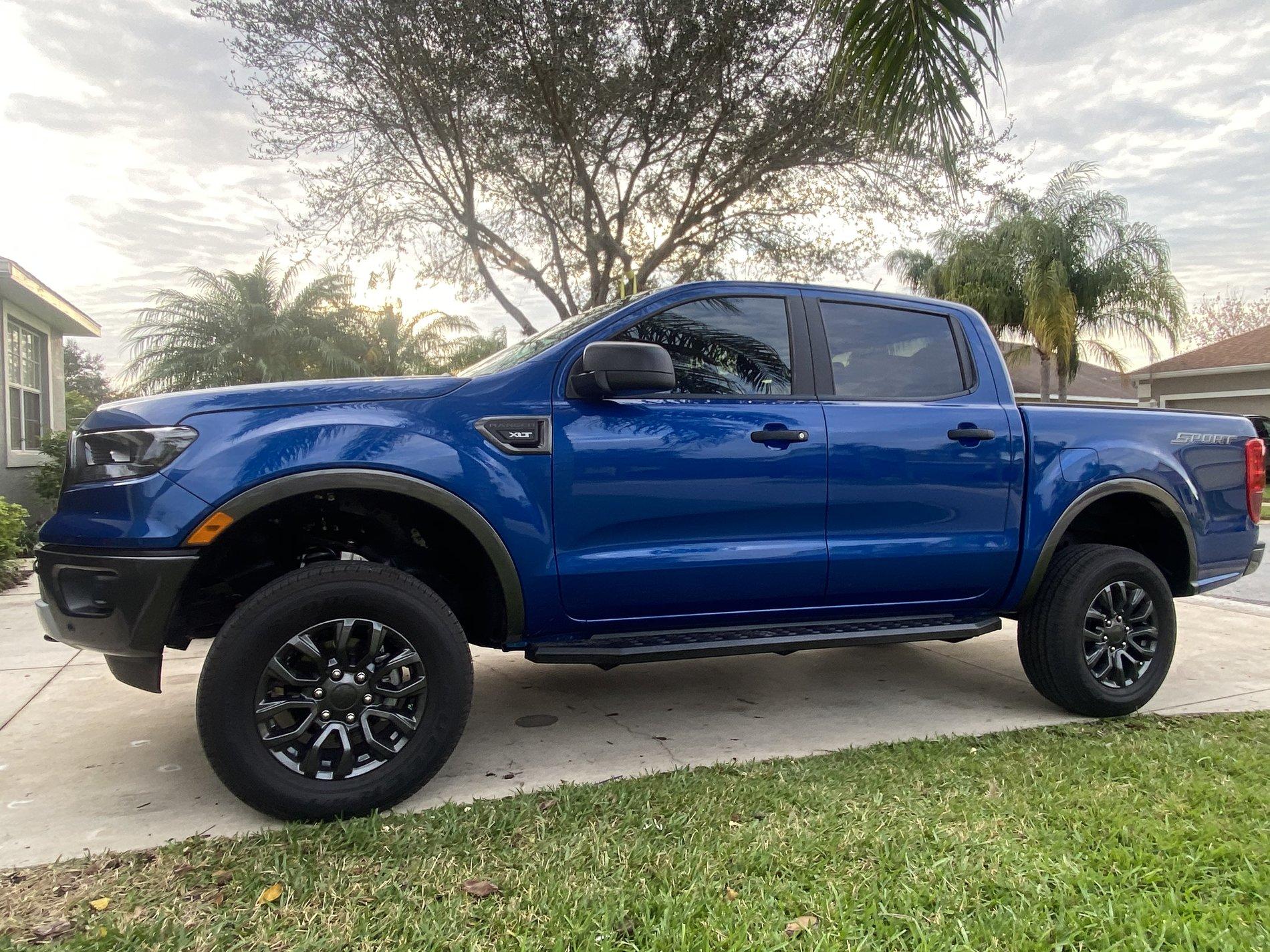

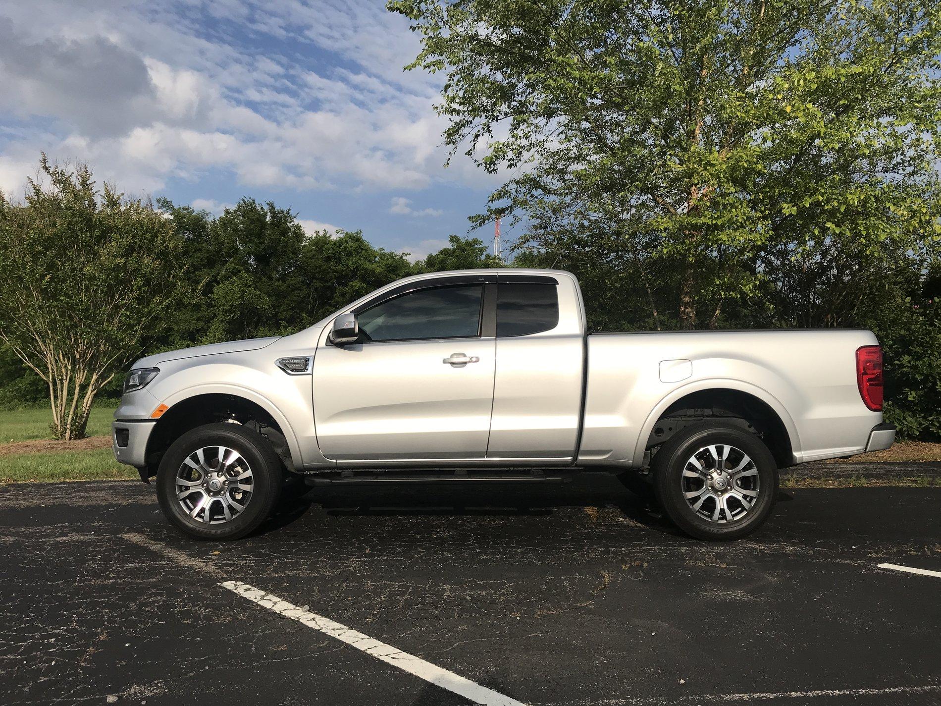

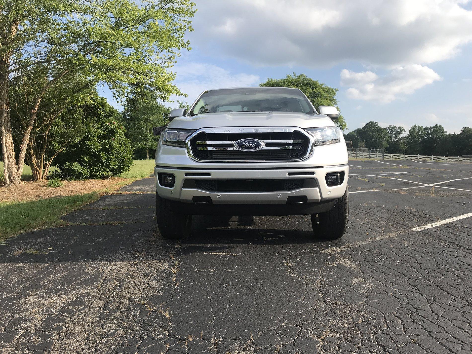

Put the full 3/1 on last night. No problems on the 2wd and no problems aligning.
Here is what it looks like on factory tires. New tires coming later this week.

Hi Jordan
I think you are okay, but you do have a caster split and if you note any pull to the Left, you might reset the caster to less split if possible...

That looks great! What do you have coming for tires?

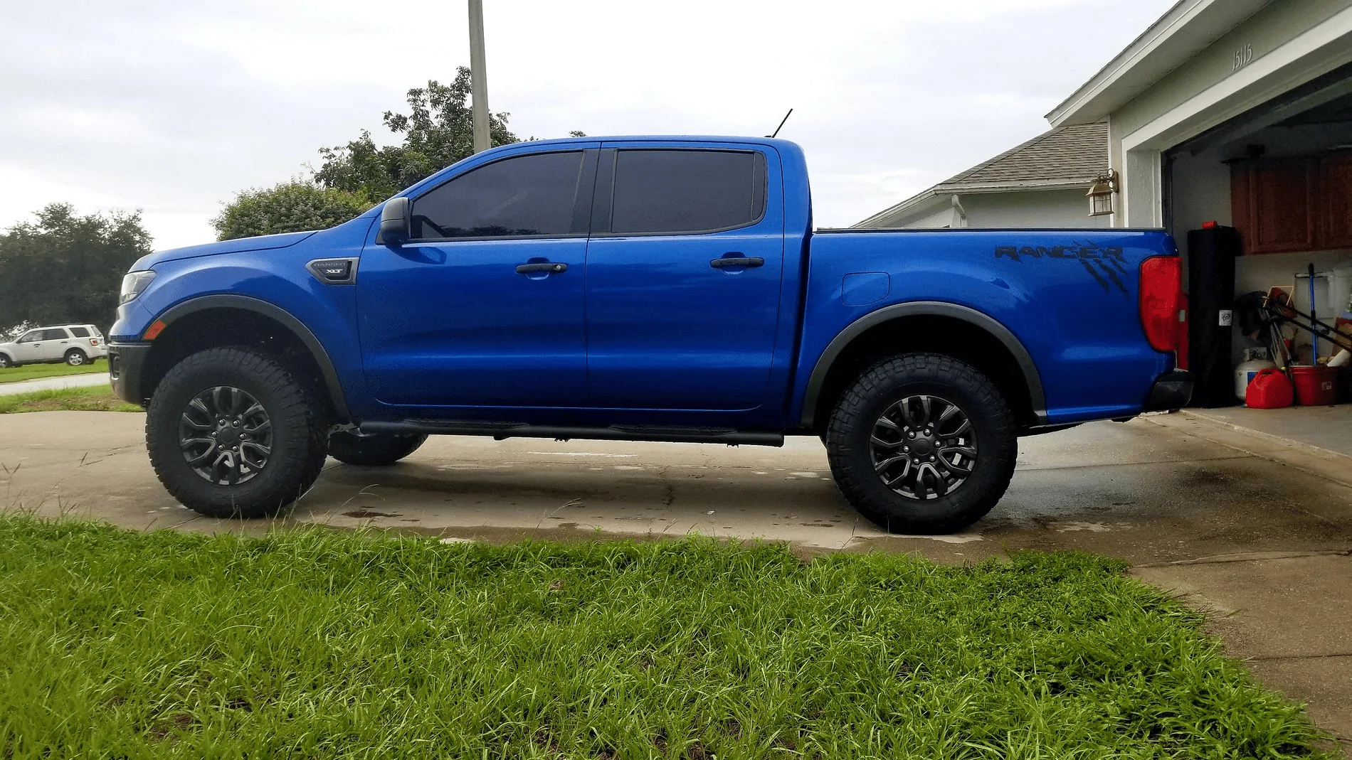

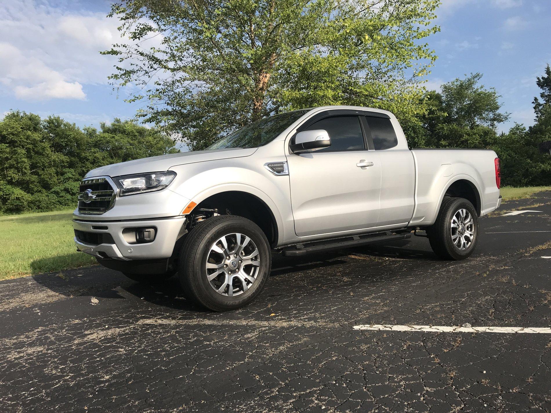

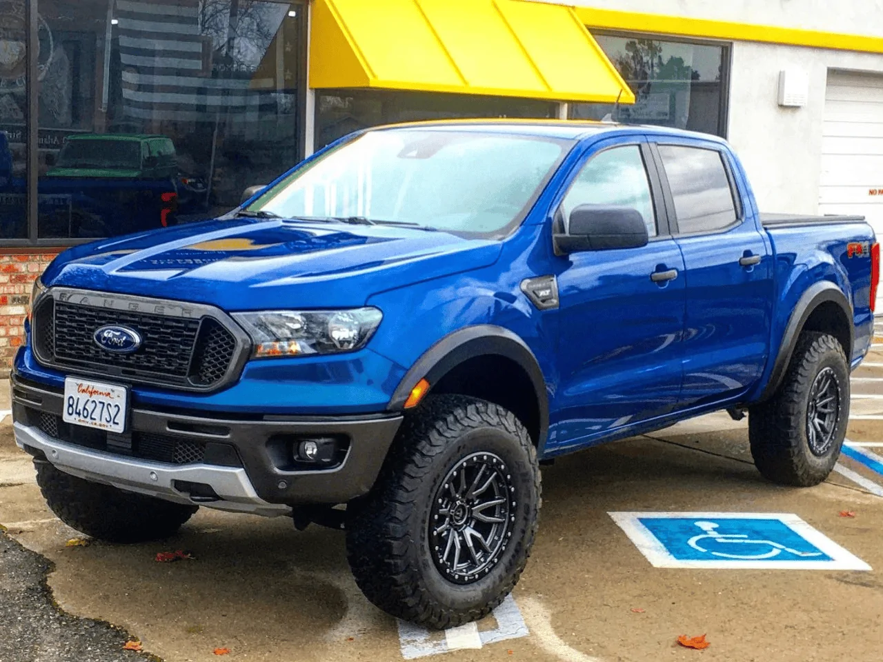

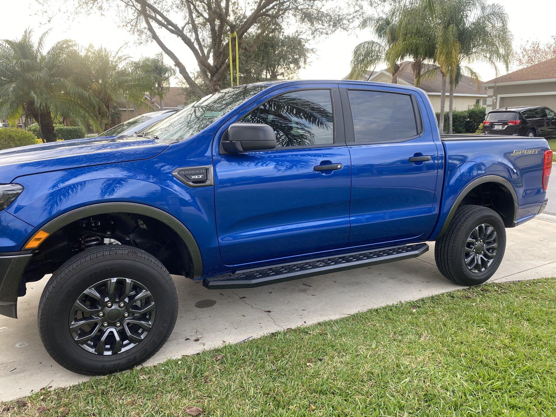

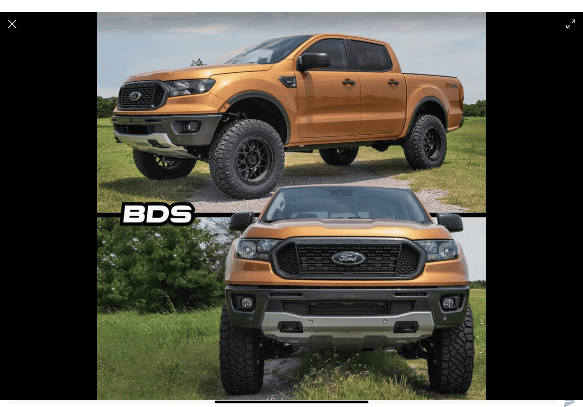

I am really struggling to decide.
It’s going to be ridge grappler P raged tires in one of these sizes.
im either going to keep the stock wheels and go 285/70/17 with 1” spacers(first picture)
Fuel rebel 17”s with 285/70/17 +1 offset(because it’s either that or -12 in 17 inch wheels) like @jeb134
Fuel rebel 18’s with 275/65/18 +20
The saber colored picture isn’t fuel rebels but it’s the correct tire size. I’m really struggling on choosing though.

I think 17” wheels look the best on these trucks. Without flares I’d pick option 1, and if you put on flares like in the photo I’d pick option 2. Just my opinion!
