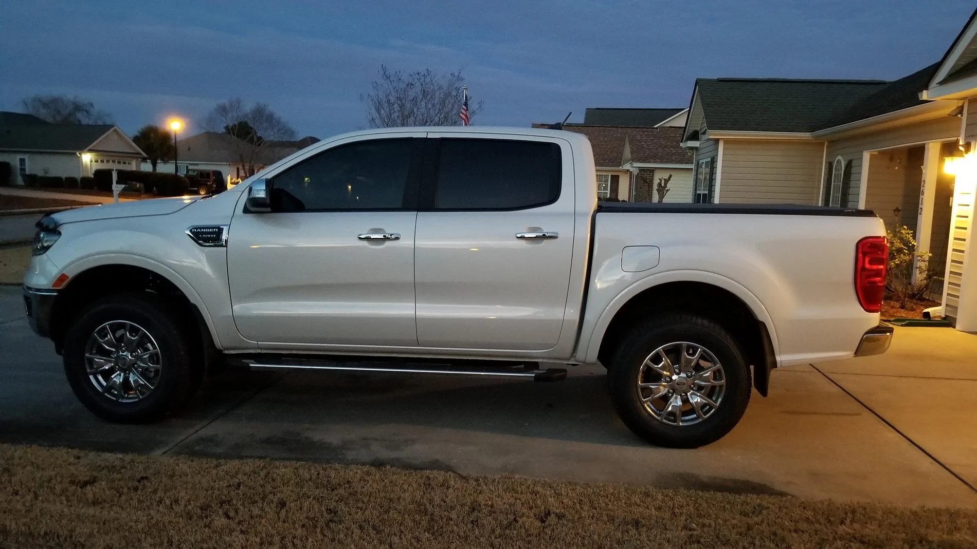

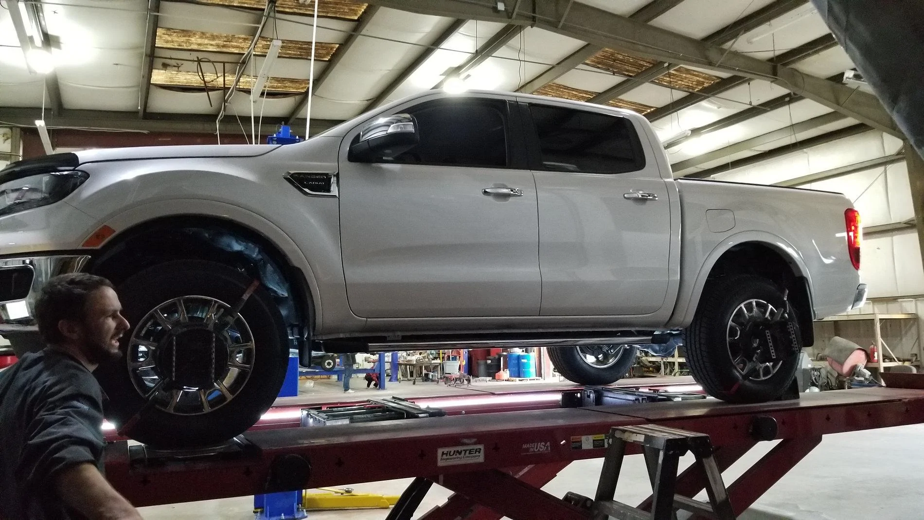

Yeah I wasn't too happy with that date so I looked around asked a friend of mine who does all this business with this particular shop to give them a try.
Soooooo will the Eibach kit fit on a RWD Ranger???? HELL YEAH!!!
But there is a caveat. And it's not the front shocks It is the Rears. Apparently the mounting bushing on the Ranger is smaller than the Eibachs. But the shop was able to mod the stock bushings to make it fit tight,
So this guinea pig is happy to tell you all have no fear when it comes to the Eibach Pro lift Kit. I did not use the Eibach springs. Because those Springs would force me into a 3-inch lift which means I'd have to put a block in the back to level.
So they used the stock Springs and I got my 2.25 inch lift. and now for the best part. The ride has been improved dramatically I tested it out on some speed bumps and some rough roads and it just sucks up the pavement like nothing else. The labor cost was $340. Including alignment. One inch higher in the back than the fronts
Now I know ride quality is subjective. But my ass tells me this is a much better ride than the stock shocks. I just felt better using the shocks over the spacer especially after Ford screwed up my front end and had it clunking. These guys said they found some other stuff they didn't do. I tipped the tech 20 bucks. I will be going back there for oil changes so they can check the alignment again make sure everything is holding.
The rear is one inch higher than the fronts
And now for some pictures
But there is a caveat. And it's not the front shocks It is the Rears. Apparently the mounting bushing on the Ranger is larger than the E box. But the shop was able to fit another bushing in there that fit. So this guinea pig is happy to tell you all have no fear when it comes to the Eibach Pro lift Kit. I did not use the Eibach springs. Because those Springs would force me into a 3-inch lift which means I'd have to put a block in the back to level. So they use the stock Springs and I got my 2.25 inch lift. and now for the best part. The ride has been improved dramatically I tested it out on some speed bumps and some rough roads and it just sucks up the pavement like nothing else. The labor cost was $340. Including alignment.
Now I know ride quality is subjective. But my ass tells me this is a much better ride than the stock shocks. I just felt better using the shocks over the spacer especially after Ford screwed up my front end and had it clunking.These guys said they found some other stuff they didn't do. I tipped the tech 20 bucks. I will be going back there for oil changes so they can check the alignment again make sure everything is holding.

That looks really good Tom,glad everything fit. I never thought the ride was that bad on mine stock but it does soak up the bumps better now with the front level kit. We were out in the desert a few days ago after some rain and the trail was hard packed sand with a lot of washboards and it went over them real smooth.
yeah Dave, The ride is a lot better. I wasn't expecting the ride to be better. I I fully expected it to be a little stiffer but actually, it rides a better over ruts and bumps Very solid feeling. The ranger "bounce" is gone. Dampening is very good. Very very good.
I Included the caveat regarding the rear shock because they did have to mod the stock bushings in the rear but that's not as critical as the front. For anybody thinking about doing this I say go ahead and have it done it's well worth it. I spent a lot on tires and spacers and now shocks but the difference is worth the money spent. I would do it again.
