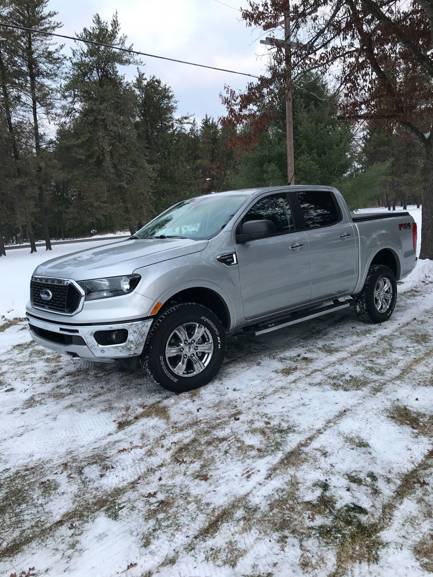

Looking at these same tires on my Lariat stock 18s, any issues with fitment, modifications needed?BF Goodrich Ko2 265/70R18
No issues, just install and go!Looking at these same tires on my Lariat stock 18s, any issues with fitment, modifications needed?

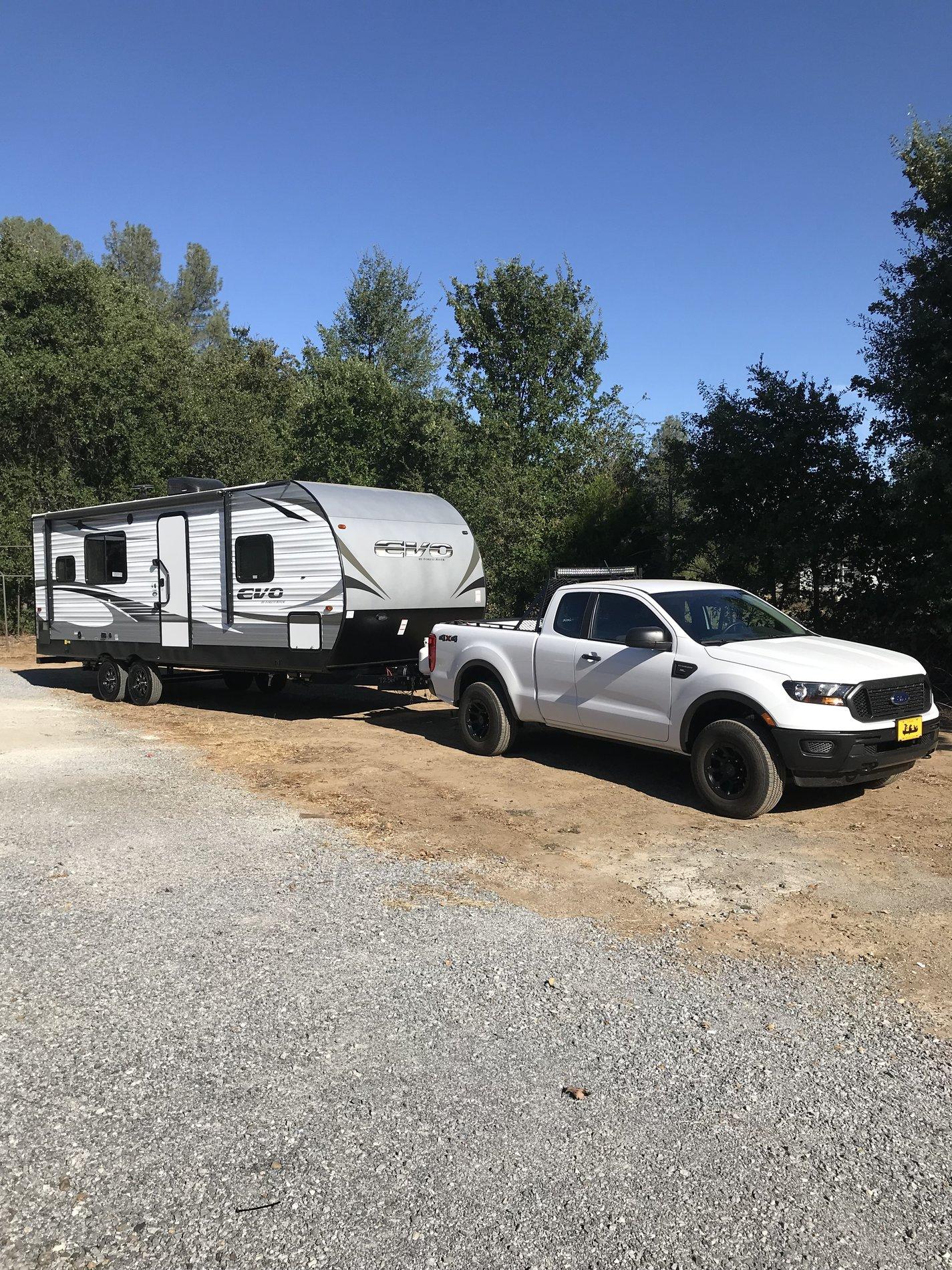

Do you have a towing mirror recommendation? TIASo I have a 23’ Forest River Evo and it’s 5800’ dry. I for one did not like towing without WD hitch, to be fair I probably am towing too large of a surface area than it should be. But I also think the super wimpy sidewall stock tires had something to do with it. Now I have Cooper discoverer st Maxx 10 plys. So between the WD hitch and the anti sway setup it towed ok. Really hoping these tires help, I think they will

Thanks, I was worried about the 32.6" dia without a lift, I will be ordering up tomorrow.No issues, just install and go!

That silver looks phenomenal with the chrome package. I like Chrome. Is it a clean hard to scratch. And the wheels always look clean until you run your finger across them and grab some brake dust. Silver and white seem to be the most popular colors followed by black in the US. I choose white so it doesn't look dirty even though it does have a film of dirt on it you can't tell without swiping it with your finger. I think silver looks good with Black as well. I haven't seen a Ranger with the new black out kit instead of magnetic trim. I imagine the black trim would look really good on SilverWill be towing our 20' GeoPro south for Jan-Mar again this year. Would like to try the new Ranger we recently purchased, rather than taking the F-150 this year. Thank you for your review. We will be putting on higher quality shocks while in the south. My main concern is towing mirrors. You mentioned the Dometic clamp ons and I'm also considering the Fit System 3891 mirrors. Did you find any complaints about the Dometic clamp on mirrors.? Thanks again so very much for your full review.

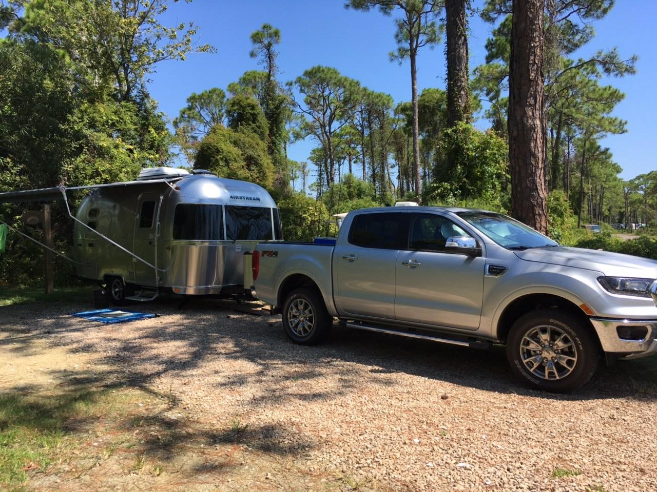

Is your truck leveled or lifted? Looks great with those tires.....No need for sway bar / leveling system, I’ve towed my Airstream flying Cloud 19 all summer with 600lbs camper system in the bed and had no issue. Just make sure your truck / trailer are very level. For those who are wondering the Ranger is an awesome tow vehicle!

Stock suspensionIs your truck leveled or lifted? Looks great with those tires.....

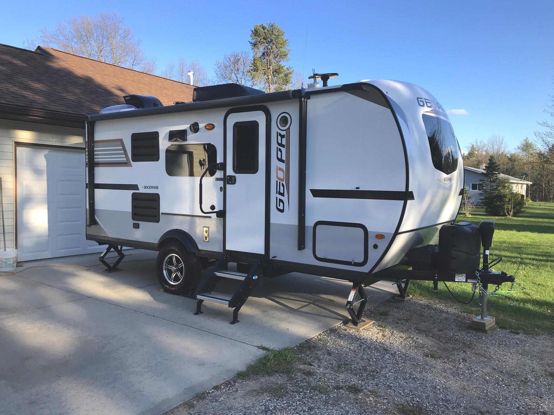

Want to say hi to a fellow Ranger and Geo Pro owner.Will be towing our 20' GeoPro south for Jan-Mar again this year. Would like to try the new Ranger we recently purchased, rather than taking the F-150 this year. Thank you for your review. We will be putting on higher quality shocks while in the south. My main concern is towing mirrors. You mentioned the Dometic clamp ons and I'm also considering the Fit System 3891 mirrors. Did you find any complaints about the Dometic clamp on mirrors.? Thanks again so very much for your full review.
