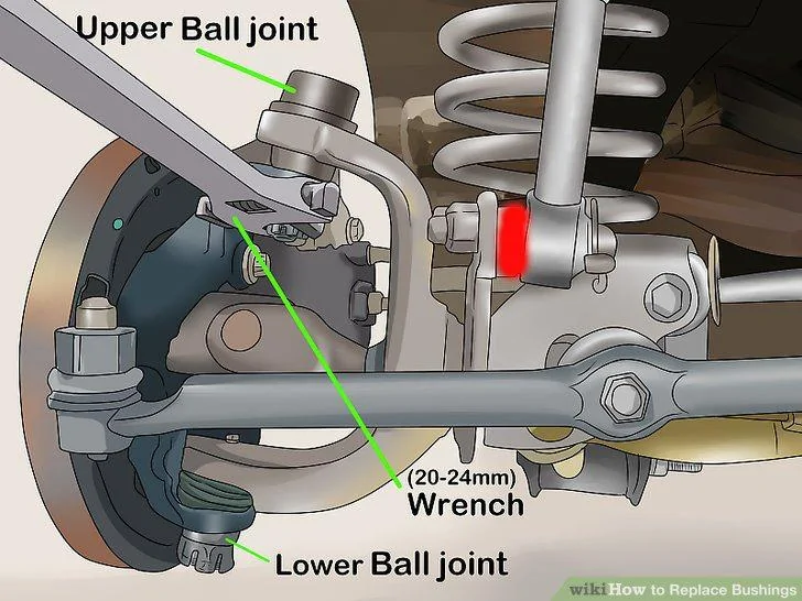

The difference would have to be on the truck not the shocks. And I can't imagine why they would use a different bushing on the shock the two wheel drive. There's some excitement here about the bushing the Notorious bushing. When you look at the picture and you see that it's just a little piece of rubber between the shock and the frame A small rubber bushing to fit a larger Bolt is not hurting anything.
As I suggested above I think most shops would not tell you things like that They would just do them I don't think the guy would have come out of the office to say "who owns that white truck ?" "I need to tell you that we have to drill out your little notorious bushing to make it fit "oh my God okay forget it forget it I don't want it I'm out bye" LOL
Bushing..in red
I thought the Eibach rear shocks would have had the usual rubber bushing through the shock loop and then a metal sleeve inside that like most shocks. Maybe it was actually the metal sleeve that they just opened up slightly.
