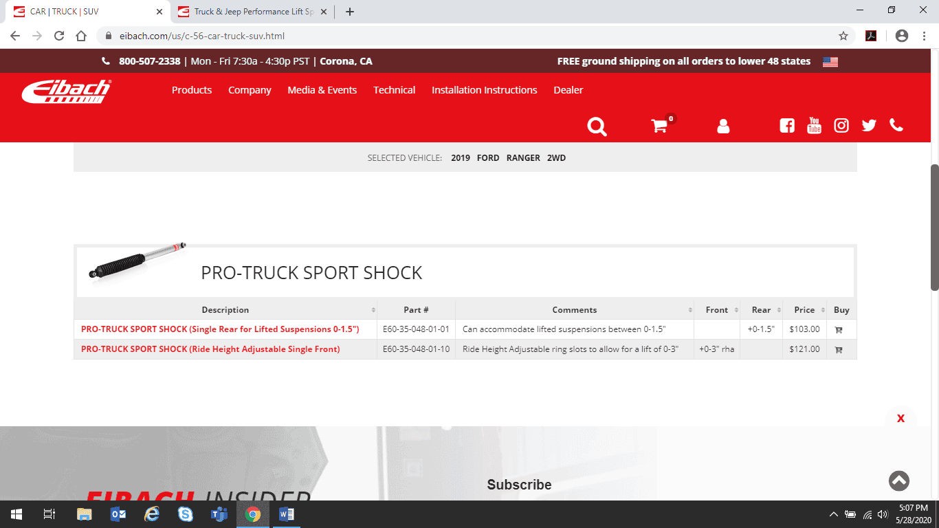

Same eibach part numbers as the 4wd shocks, unless thats what you were saying.
I plan to get these shocks. Anybody, have pics of the .75 lift setting?

Bumping this thread for visibility as I close in on this upgrade. RWD version on mine, and I don't want to second guess the adjustment. I saw another thread on the Eibachs and squinted at the before and after shots as far as visual changes with an eye on what towing is going to do. So, if putting the front adjustable shocks on a 2WD vs. 4WD might result in more lift up front due to weight and mechanics, it sounds like I 'should' be a little conservative in settings - and I don't want to go back in to re-adjust.
There's a three inch difference in wheel arch height front and rear, it seems half that will go a long way in making the compromise.
I'm reading some have elected around one inch while others have gone almost the full extension - which I don't know is wise if I'm using the truck as an actual truck.
If the 2WD experiences a little more lift with stock springs over the 4WD, I'm somewhere between 1.25 and 1.75 in my selection. Towing is the determining factor.

With the Bilstiens, i chose the lowest setting. i was expecting about 1/2" of lift but saw the stock height 35.5", same as with the stock componants. i don't think you'll see much variation from the lift that's stated for the 4wd. i've got a FX2. Definatly do the upgrade though. for a so called off road suspension, the feel was jarring even over small bumps. truck pretty much soaks up the bumps now. i'm seeing the same 3" differential front to rear at the stock height.

I got the exact lift amount that eibach "estimated lift" stated. FX2 here. Agreed that you won't want to experiment and have to take it apart again to adjust lift. They do include 2 extra retainer clips in case you do though.
