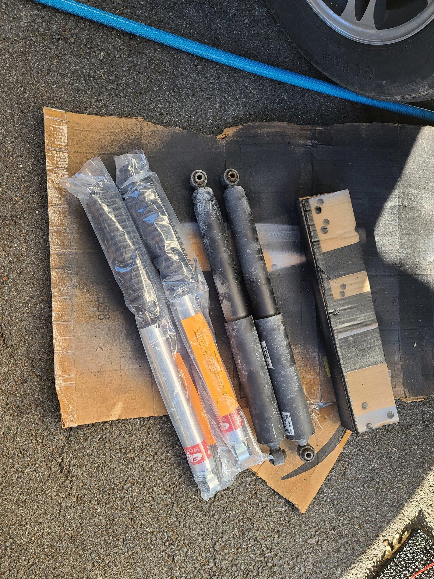

For people installing in the future:
The shocks can be reinstalled in either orientation. I opted for boots down because I read somewhere that boots up can hold salt/grime and also the boots only cover the shaft which is more puncture resistant than the body.
I read on the Eibach site for a different Ford vehicle (mustang) that the shock should be installed with the label right side up, yet if we mimic the stock config on the Ranger, it would be 'upside down.' I peeled the sticker off mine, and installed them as stock, now I am second guessing myself. If you are able to examine the shaft end, there are holes in the boot mount that might allow air/water in or out. I just don't know if having it on the bottom where it might suck up high water like a turkey baster is worse or better with it high up near the bed.

I installed mine with the boots down also. I have the Gibson dual exhaust and I feel like it would have been too close on the driver's side to the boot.

I googled for an answer on the rear shock orientation and ended up boot side down because I saw a photo of an Eibach test rig with the shocks installed that way. I wish the instructions were more detailed.
I had emailed them nearly a week ago - no response. Last Friday called, they were closed for the holiday. So I called today to assure myself I haven't ruined my ride...
The tech says it doesn't matter. We're all correct for our individual rationale.

Mono tube shocks dent very easy and then fail but have improved performance. Mount body up helps protect the tube and also has lower unsprung weight. This said you can still mount body down. Bret

I went boot side down also. Before I purchased these shocks I had a conversation with Jason from Stage 3 (Thanks Jason) about the orientation of them and the stickers. This was his reply,
“The stickers only come one way and are pre-installed on the shock. Because the Eibachs are a monotube shock, their orientation doesn't really matter, and some folks prefer a boot-up, barrel-down setup, which is what you see in the picture.
In general, we typically recommend a shaft-down, barrel-up orientation (which would make the sticker face the correct direction), since you're more likely to puncture the standard steel shock body with stuff you kick up from the road than you are to pit a hardened steel shaft to the point that it tears a seal. Not to mention, the shocks come with a boot to mitigate shaft damage anyway.“
