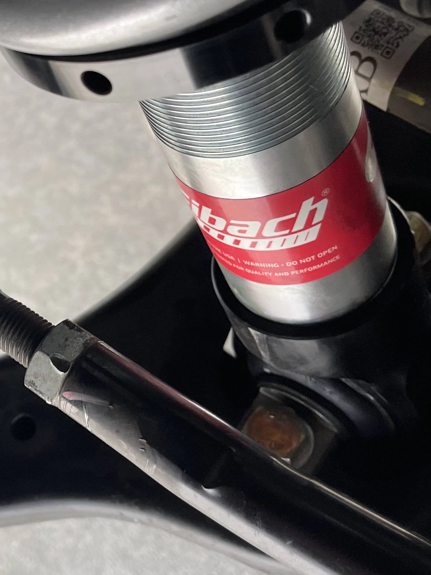

Question for anyone that has done the Eibach front strut install or had a professional install done. Did you reuse the stock lower mounting bolts/nuts? Were you able to install them back in the factory orientation with the bolt pressed through the strut crossbar from the top and the nut on bottom? Did you end up buying new mounting bolts or installing them another way (bolt on bottom)?
From my first install attempt it seemed putting the bolts in from the top would be almost impossible since the shoulder of the bolt is quite a bit larger than the hole in the shock. The bolt does fit if I put it in from the bottom of the control arm with the nut on top but I figured there must be a reason it was designed to go the other way and ended up reinstalling the stock struts for now. Stage3 didn't have any advice for me other than to contact Eibach but I figured I'd go ahead and ask here first.

Interesting, I wonder if the full coilover comes with new bolts whereas the strut only which I purchased does not. I'm thinking I could probably go down to the hardware store and find some to fit. I just find it odd that Eibach wouldn't call that out in the instructions. The other issue with the stock bolts is they don't have a hex head on them so might be difficult to tighten or get loose down the line if they're not pressed in to the shock.

Update after completing the install today. I ended up using some grade 8 hardware from Lowe's. 1/2" x 3" bolts fit perfectly with washers top and bottom. Stage3, to their credit, offered to reimburse me for the hardware even though I feel like the issue is really on Eibach. I would definitely recommend going this way over trying to press the factory bolts out of the old shock and reuse them, if only for the time saving alone.
Some additional tips I learned along the way:
- Unbolt the speed sensor wire AND the brake line from the knuckle, this way you can leave the knuckle hanging without pulling on the brake line
- Use a large hammer to knock the upper ball joint lose before the tie rod, the tie rod comes out a lot easier this way
- To disassemble the factory shock, use a strut spring compressor and then just pull everything straight off over the little retaining ring. At first it looks like the bump stop won't come off but it does rather easily.
- When putting the shock back in, use a ratchet strap to bring the upper control arm down and into the knuckle, otherwise you'll probably need another person to help you here
- Personally, I left the Eibachs at factory ride height and didn't need an alignment afterwards
