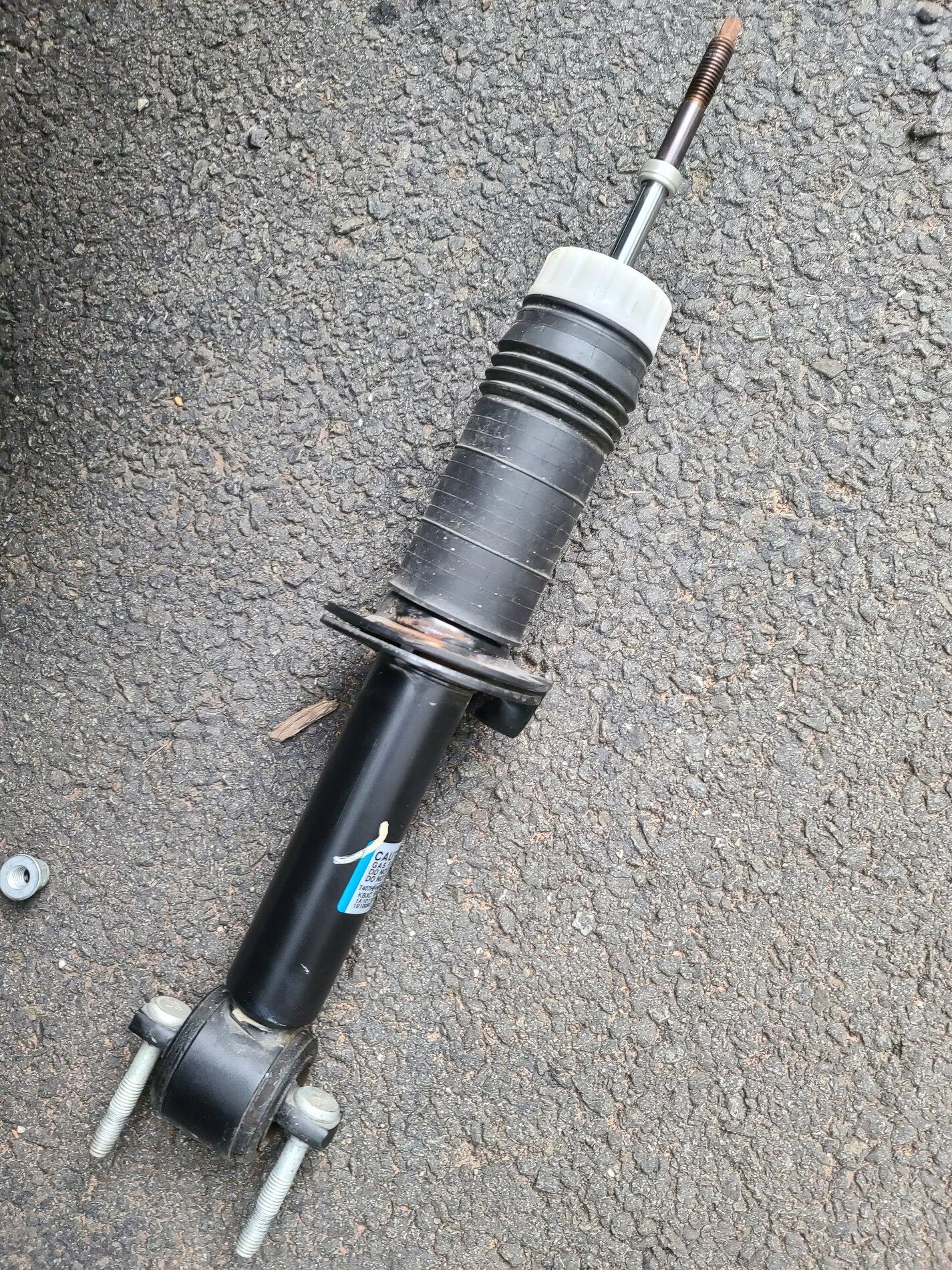

For people installing in the future:
The rear shocks are removed with a 15mm socket. Using an impact gun makes quick work of it. The passenger side upper nut is in a channel that makes it hard to put back in. Try to leave it in that channel!
The shocks won't fall out on their own when the bolts are out, so no worries about getting bonked. Compress the shocks slightly to pull them out.
You will have to jack the truck to get the new ones in though, as the axle droop will help you position the new shocks, which are linger and MUCH harder to compress.
The shocks can be reinstalled in either orientation. I opted for boots down because I read somewhere that boots up can hold salt/grime and also the boots only cover the shaft which is more puncture resistant than the body.

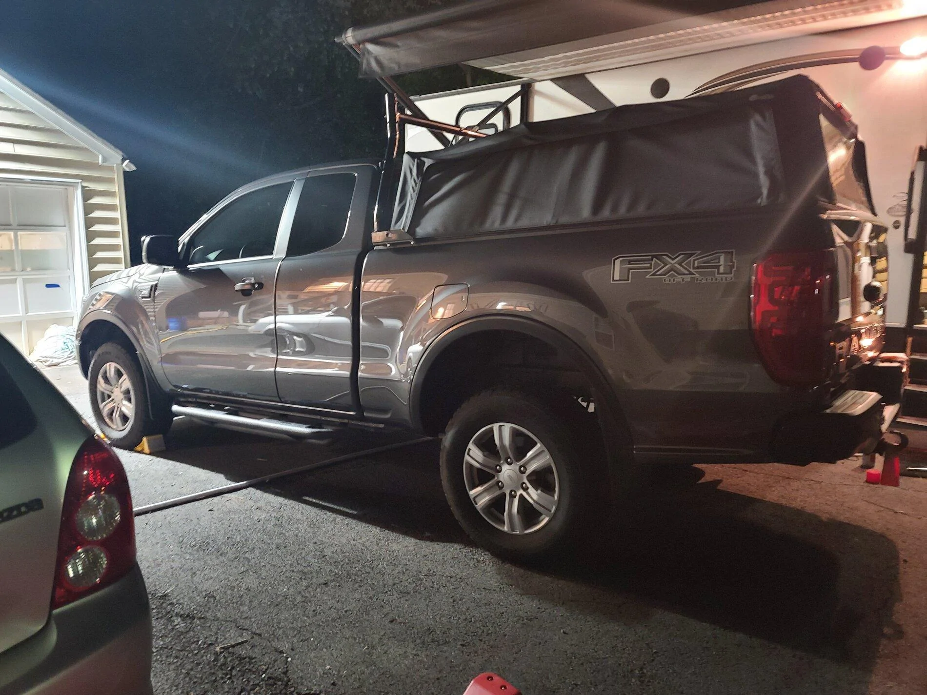

Got my rear installed! Pretty straight forward, tho a long reach jack would have been very helpful.

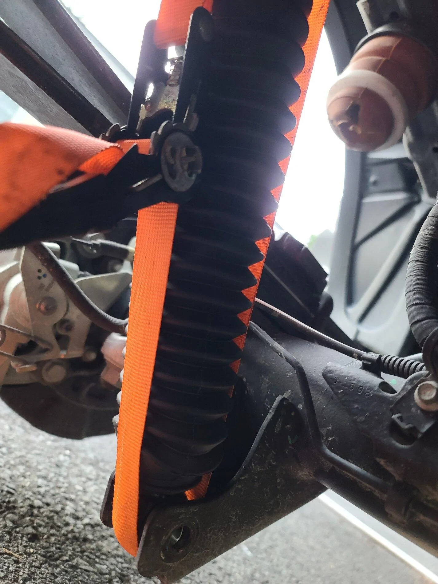

The Eibach shocks are MUCH stiffer than stock. Compressing them by hand is a no go. I used a ratchet strap to good effect.

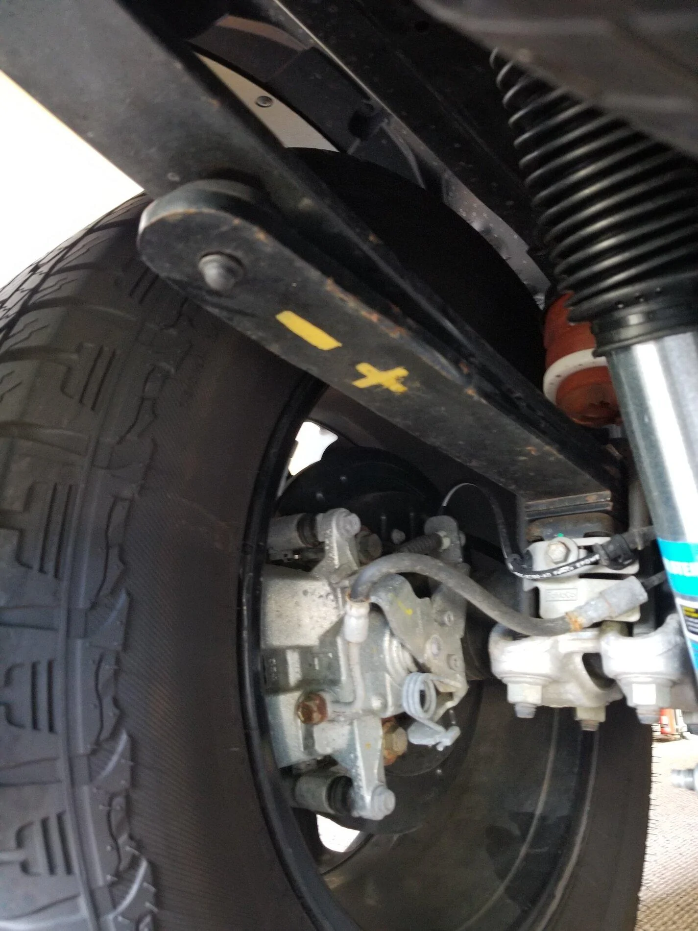

There's no need to force the shackle bolts into place, just use your jack to play with the position of the axle.
All and all, I'd rate the rear a 3/10 difficulty.
Tools needed: torque wrench, a ratchet strap, jack stands, a jack, impact wrench highly recommended, 19mm socket, 19mm wrench (for the bds shackles), 15mm socket for the shocks) and if I'm not mistaken, a 21mm socket (for the stock shackles).
Torque specs from BDS are 51ft lb for the shocks, 76ft lb for the shackle bolts.
The bds shackles gave one inch exactly
So far, even with just the rears, the bounciness, and swaying after hitting a bump is almost gone. Firm ride. But funny looking for now.
