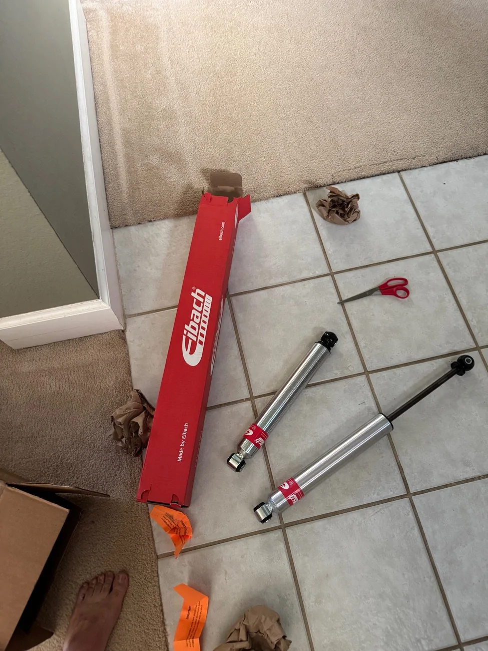

So far I was planning to do the rears first and see if it helps, I received my new Eibach Pro Truck rear set today and one of them was dead -- no rebound at all, it is easy to push down and stays there its been 4 hours and still compressed! so NOT installing tomorrow... I sent a video to stage 3 and I'm still waiting to hear what they are going to do about it ---- hoping just sent me an RMA and a new replacement. --so always check yours when you get them this one looks like its never been installed (not a return as far as I can tell) so its just dead out of the box not to inspiring as far as quality control goes but hey stuff happens. Im glad I checked it.
Man that sucks! You definitely would have noticed when you went to install it, but then you might have already installed the good one first. That's the first I have heard of a bad part from Eibach. However, I ordered directly from them and they sent me the wrong fronts, they were for Chevy. They promptly sent me right ones, took me forever to find a buyer for the Chevy ones.
yea I always assumed eibach was good but here it is -- good one on R and dead one on L -- it was easy to compress one-handed and had been sitting compressed for about 5 minutes when I snapped that photo and a video I sent to stage 3 to get it replaced (still compressed today) .... the crazy part is stage 3 is "having eibach review it" .... seems pretty clear to me! but I'll given them a day or so to hopefully send me a new one and a return label for the dead one

Defects happen. They shouldn't but they do. Eibach will make it right. My shocks have been flawless. The rears do get rid of a lot of that Ranger "wallow".
so far still waiting -- its been 5 days and gotta say pretty disappointed with Stage3 they are zero help with this. The latest plan is eibach to send me a label for the defective one, me send it back wait for eibach to OK a replacement then they ship it to me .for something that was defective right out of the box... so I'm looking at like another week or two probably its pretty ridiculous for something that is this obviously defective at this point Id rather just return and buy somewhere else! But now we are having the "return shipping' discussion ..... apparently I'm expected to cover return shipping for defective merchandise - gotta say I don't recommend stage3 at this point just really glad I did not order the front set yet and when I do, it wont be from Stage3. rant over (for now)
