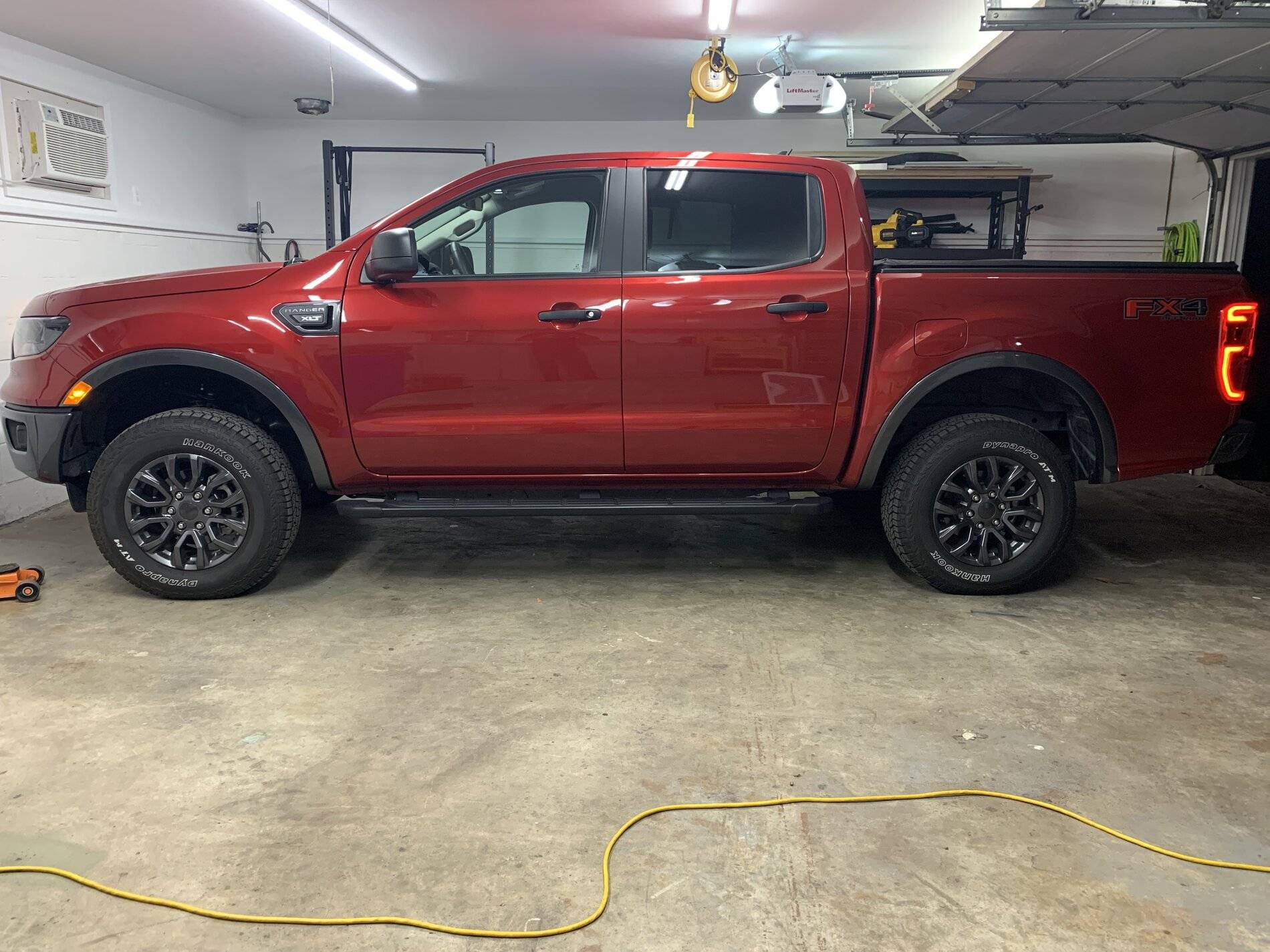

got my coilovers in. 1 hr on drivers side, 30min on the other. (no including adjusting them down)
I have them set at 1.5” of lift, leaving 1” of rake for towing and hauling.
something i noticed though- the driverside required quite a bit more preload, like .5” more, than passenger. i know tacomas got the lean, do rangers have that too when you add coilovers?
im guessing the stock shocks account for the weight of driver/battery/ gas tank?
just seemed like i had to crank alot more on the drivers side that i wanted.

Found the same thing with my DIY Bilstien/Eibach fronts. Had to dial in .350" more on left side than right.
On install, I thought I might have mismeasured or possibly gotten an out of spec spring but nope, it's the same lean that Ford uses a spacer under the left rear spring to combat.

so thats 1.5”. debating on going to 2” or not. tires and alignment are at 12pm today. i feel tires will make the 1.5” look better. (265 70 17 terra grappler )
