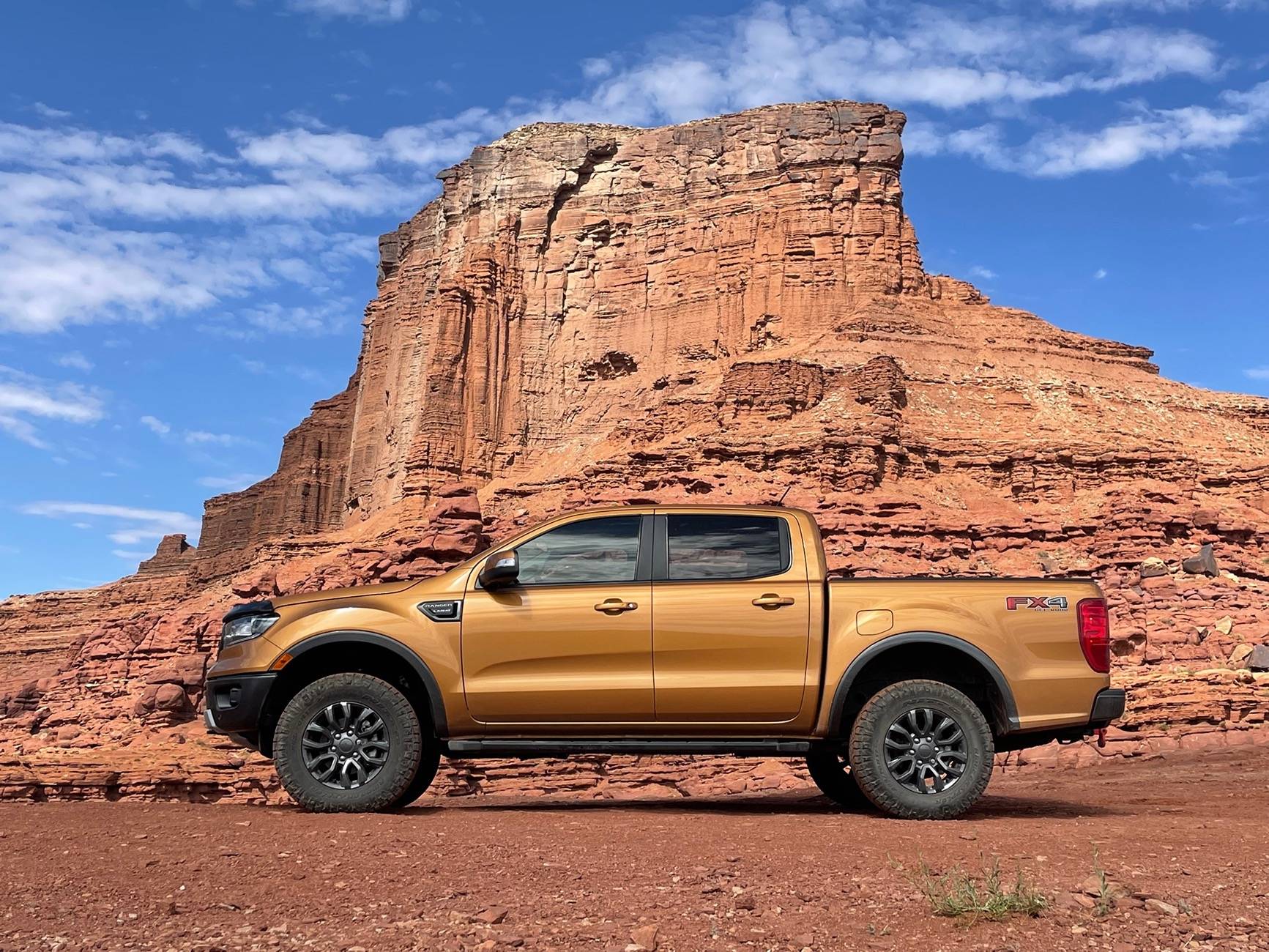

I had them on my '19 set at 2.5". It was very close to level and the ride was great! You can't go wrong putting these on and will wish you did them sooner.
