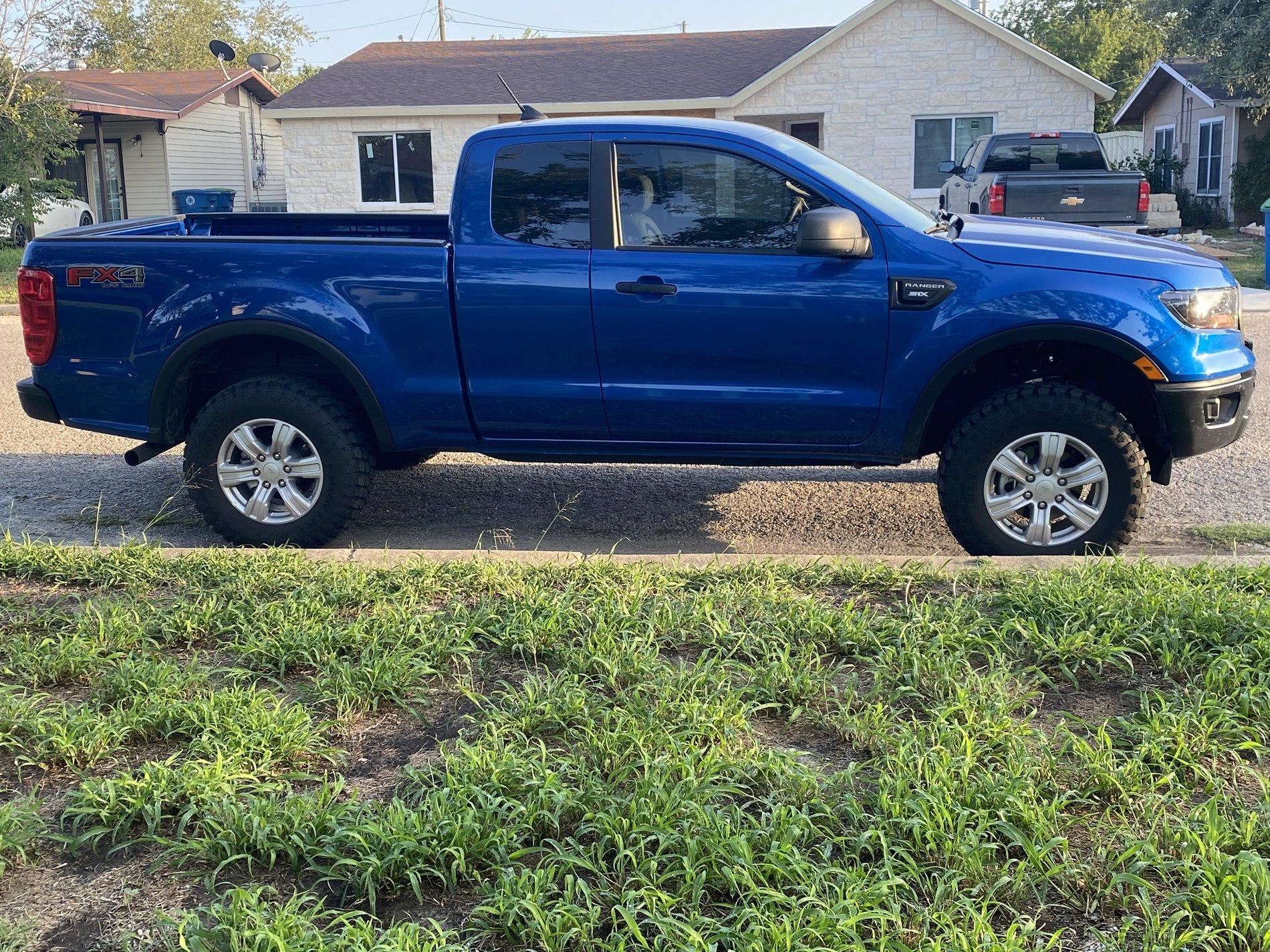

Well guys ordered the new Eibach 2.0 Coilover system. couldn’t pass up the deal Nick @ Peak Suspension has going on this month! If I get them here by weekend I will have it installed and give a review!
I've attached my install images below. Stage 2 is the way to go! Simplified install and made things much easier. The trick is to remove your axle nut otherwise your whole assembly will pop out of its socket.
NIGHT AND DAY DIFFERENCE. That's my takeaway after 4,000 miles on new suspension. Plus my truck is level now!
