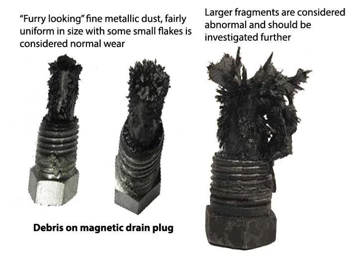

I changed my two diffs and transfer case fluids at 20k. All three came out grey, like grey milk, and their viscosity was all but gone. All three magnets had so much metal dust on them they were no longer collecting any more metal.
Owner's manuals are deceptive, you have to know when to trust them and when not to. This is a time when not to.

It was 'grey milk' color just from all the metal dust, no water. It's viscosity was good, going by feel between my fingers. In this instance I didn't need an analysis, it was obvious, my three drain plugs looked like the plug in the middle of this photo. So packed with metal it wasn't collecting any more. I've also started putting strong magnets on them as well as my oil filters.
