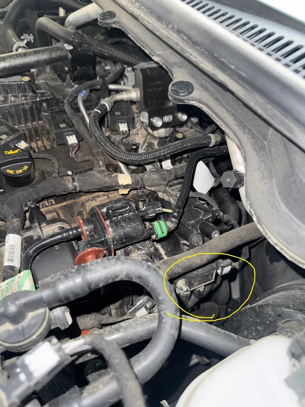

This is what you're looking for, for those new to the DPFE game:
So, I am new...where do these EGR valves reside? I am sure under the hood but a little closer please. Also, I have 56,000 miles and have to my knowledge never had it changed nor am I experiencing any performance issues. Am I just lucky? Thanks in advance, Jim

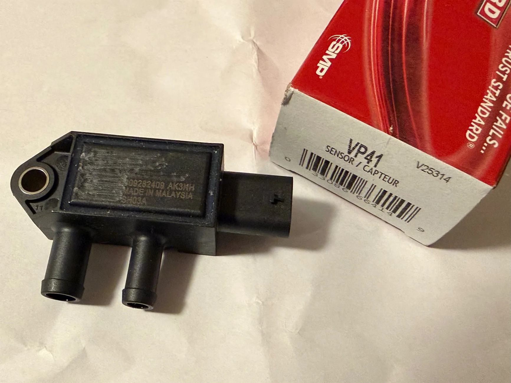

Got mine in today! It indeed looks like a Ford part with their name scratched off. Being a technician at an independent shop, this is not out of the ordinary. If the aftermarket cannot make or find a part cheap enough, they will get them from the OEM supplier.
Odd that they don't even bother scratching it all off now. The ones I got were pretty thoroughly scrubbed.

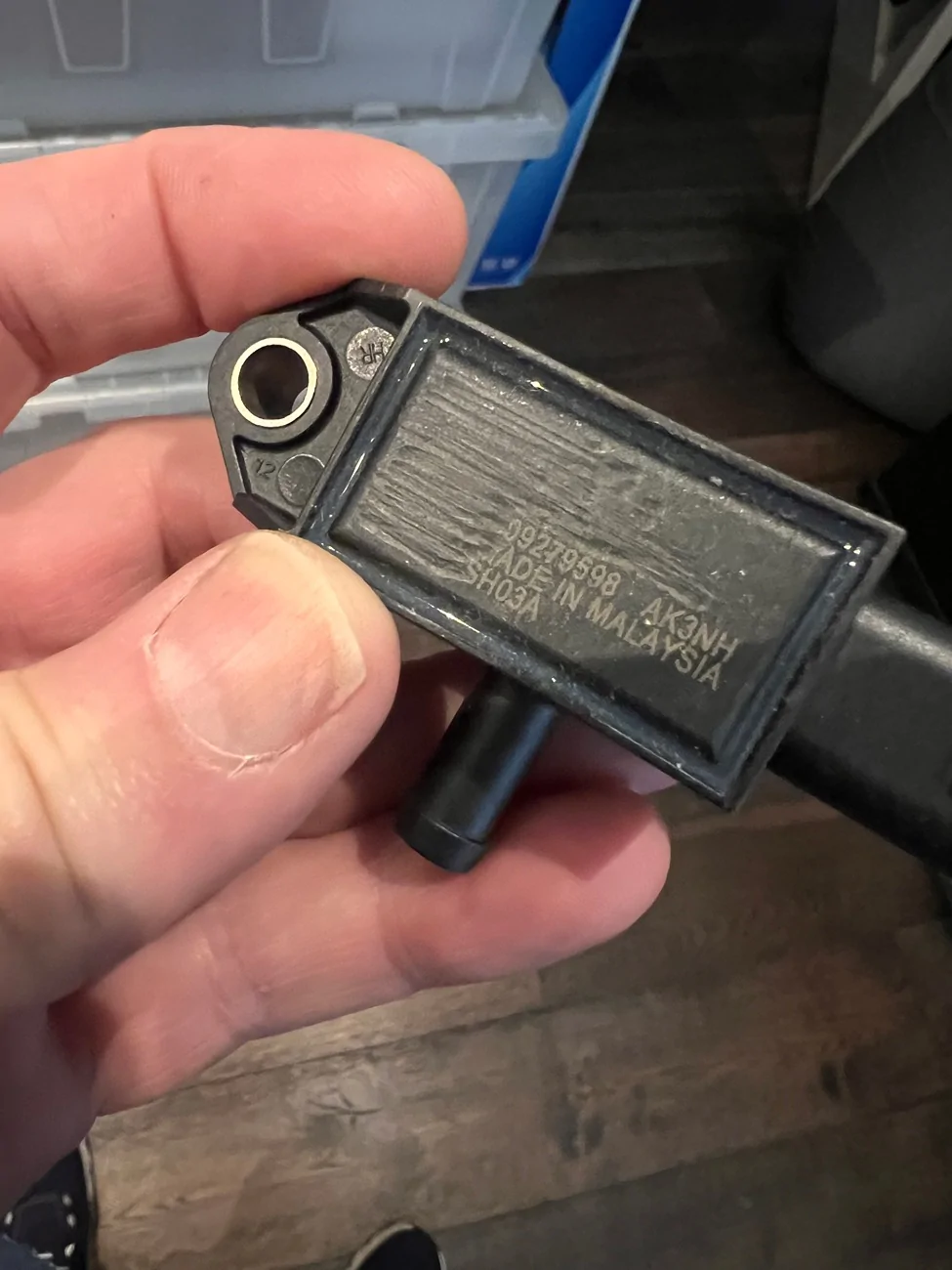

I just got mine today too and came to post the same as above..... They removed most of what was printed on the sensor.
