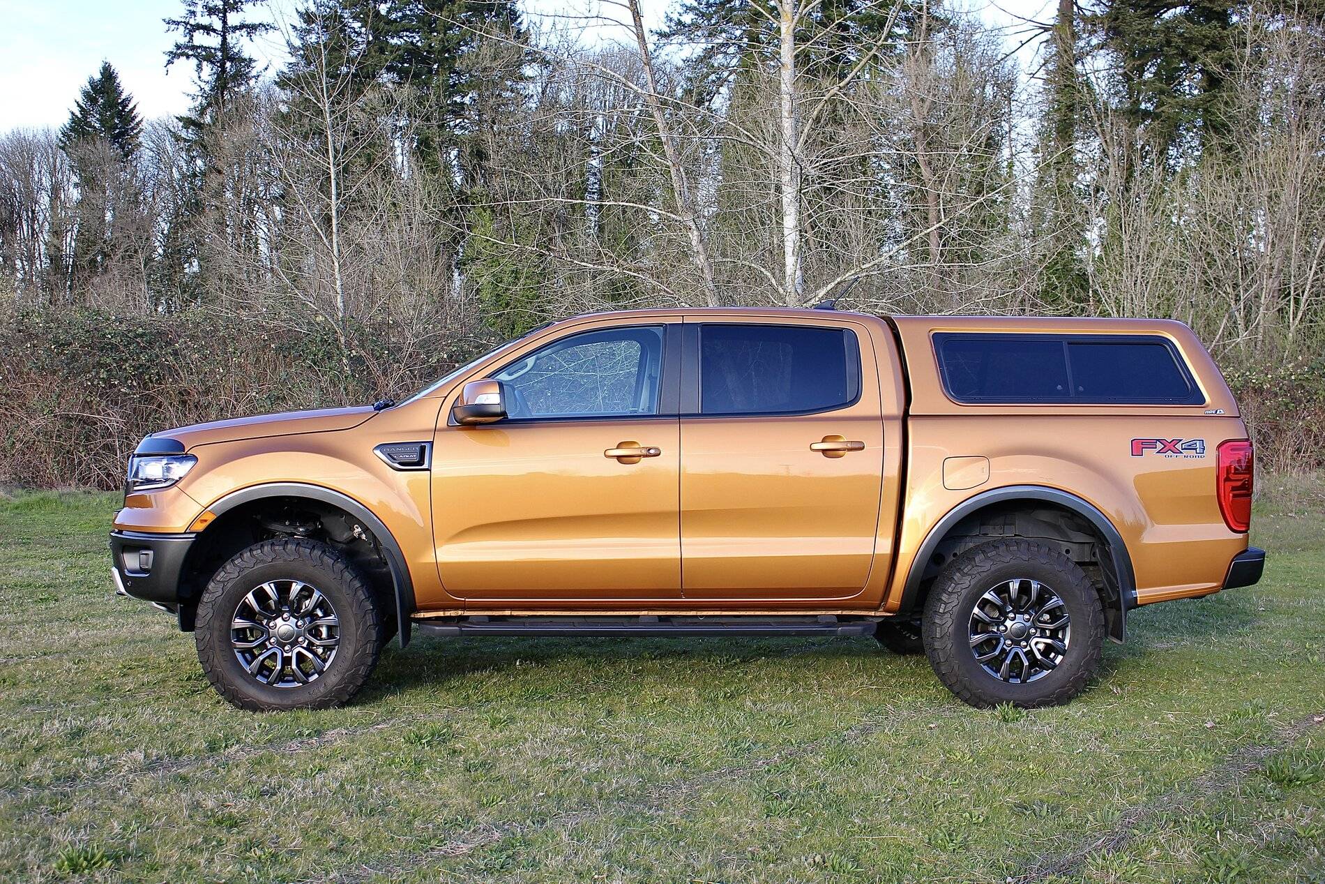

Does my Ranger have a leveling kit?
VegasRanger
Jun 1, 2021
884
1,901
Las Vegas
2021 STX Crew Cab 4x4
Damper Salesman
Lol a blind guy can see that it’s leveled
SaberRanger
SaberRanger
Feb 5, 2020
96
310
2019 Ranger Lariat FX4
Looking good - def looks like the RC kit - had it on mine for a year - no issues but had to adjust my headlights. Doesn’t affect handling or performance but it sure looks good.
You also have a great set of tires on the truck. They’re about as big as you can go without issues, so don’t get any crazy ideas about going bigger unless you want to start spending a bunch more money and modifying crash bars. ?
Looks great as it is - now, go wheel the pants off it.
Thanks, I’m going to be switching tires soon but staying with the same size.
I know the BFG’s are highly rated but they slip really bad in wet weather. I live in Oregon and we get a ton of rain, I’m probably going to go with Cooper At3 4s tires.

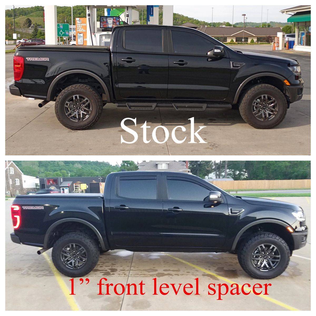

Could be my eyes, could be the pic, or maybe it's just me. But this...
...looks to sit quite a bit lower in the rear than this...
...and Dave's picture is not even on level ground.
You'd be amazed at what even 200 lbs will do back there.
I just wanted to put it out there that there are solutions available if you'd like to restore some rake.

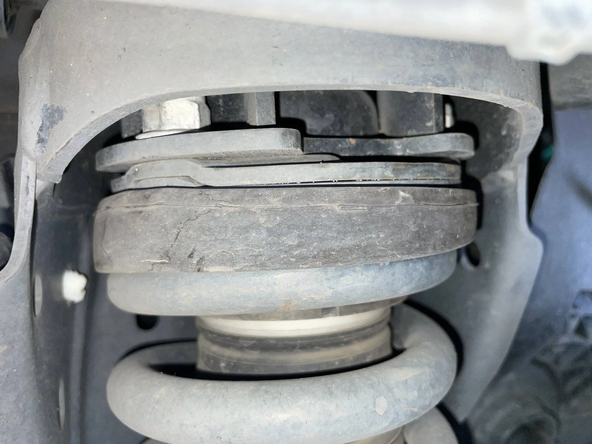

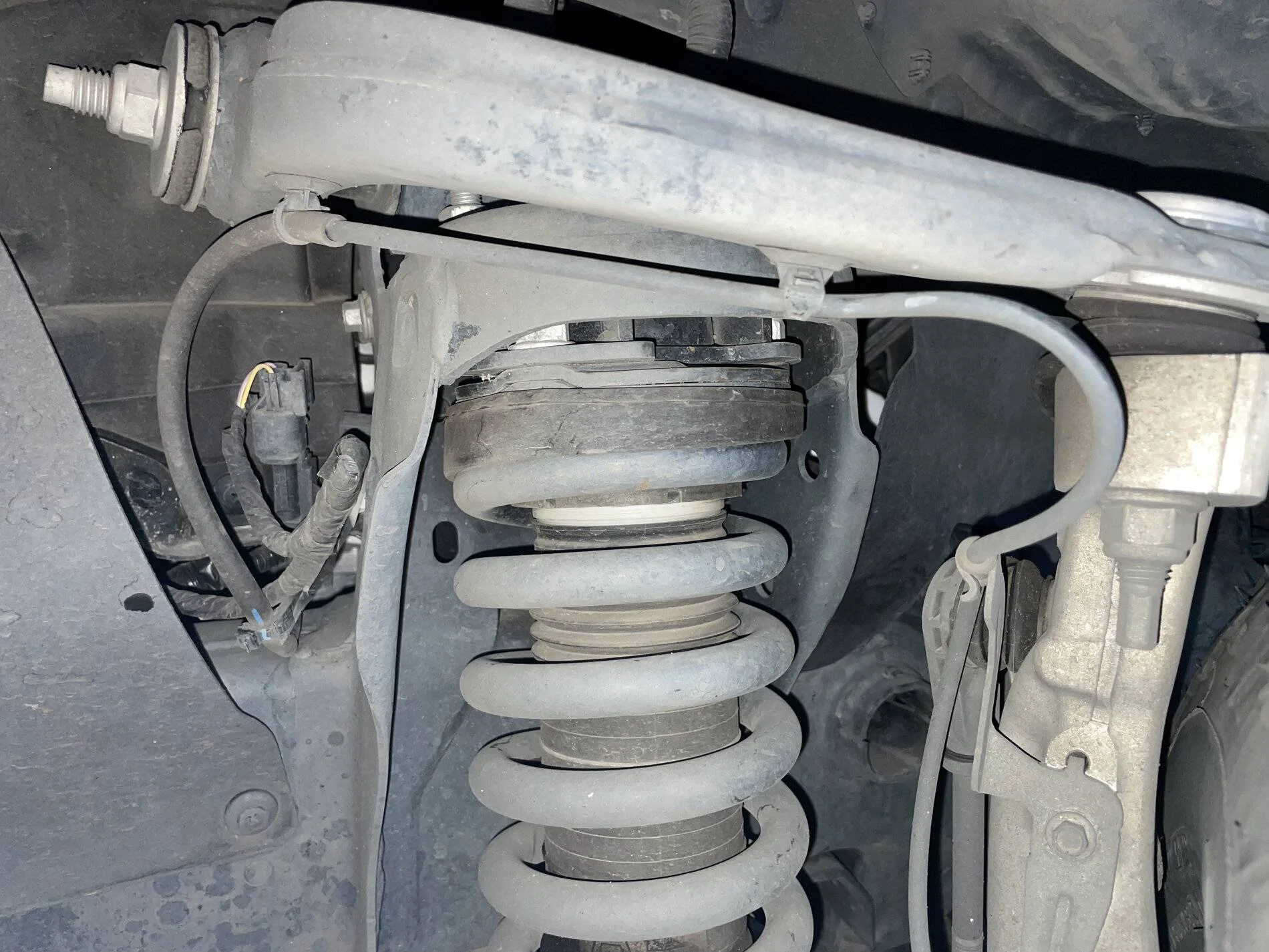

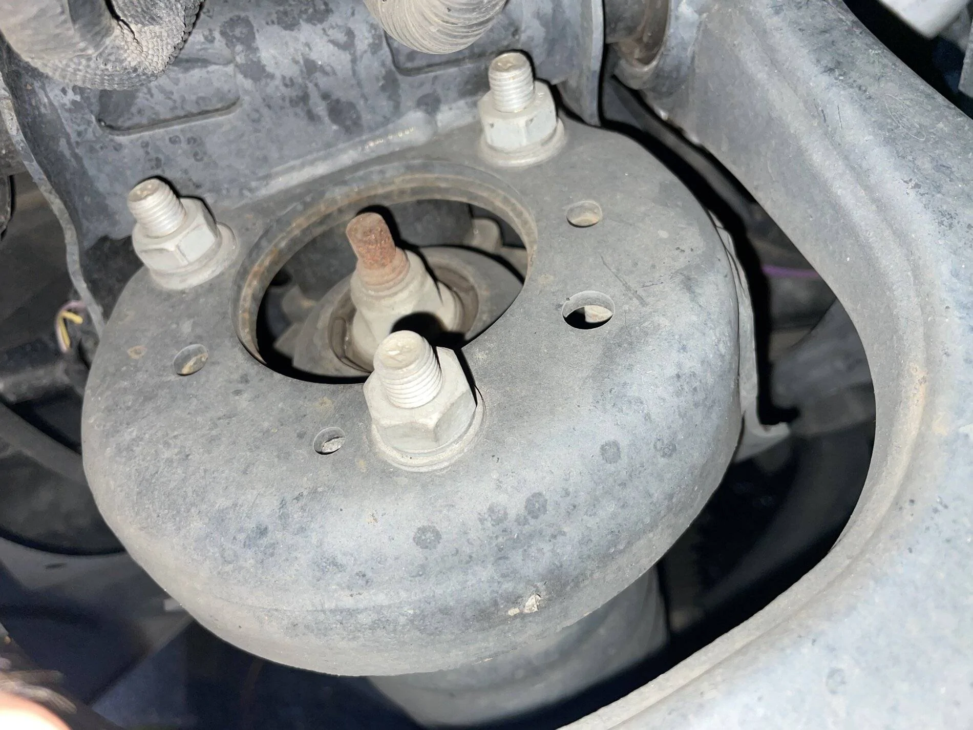

I bought my Ranger used with 5,000 miles from a dealer almost two years ago.
It was a one owner but they didn’t really have any info from the previous owner.
I have been told twice by my ford dealer when I have had it in for oil changes that it has a leveling kit installed but I don’t know for certain.
One guy just was complimenting me how good the truck looked with it leveled and the last time I had it in they said it needed an alignment because of the kit.
I have no idea if it does or not but I’m sure if it does and I wanted to see what you guys think.
The previous owner put 265/70/17 BFG K02 tires on it and they don’t rub or anything.
I am not exactly sure what to look for in the front suspension to see if it has a leveling kit.
Definitely looks levelled (and very cool). Assuming you like the ride, it looks like you caught a break--most of us had to pay extra for levelling!
9,643
46,130
Looks like more of a squat kit with the weight of your topper. Might want to add-a-leaf.
It doesn’t look squatted to me and the topper is very light.
Doug makes a good point about a slight nose-high stance. With my 2-1/2” RC level kit, my truck squatted a bit because of the weight of the topper. Not much, but a bit. Certainly more than most.
Toppers weigh in at about 150-190 lbs. I also carried additional weight in the bed (tools, building materials), which made the back end sit even further down. Not much but enough that when I removed the spacers to upgrade my suspension to Fox Performance 2.0, I left the new struts slightly lower at 2” to compensate for that. It’s also a bit hard to tell by photos unless you’re perfectly straight on and parked on a completely flat, level surface.
One thing for sure, your truck looks great and a is heck of a lot more level than it would be without the kit.
