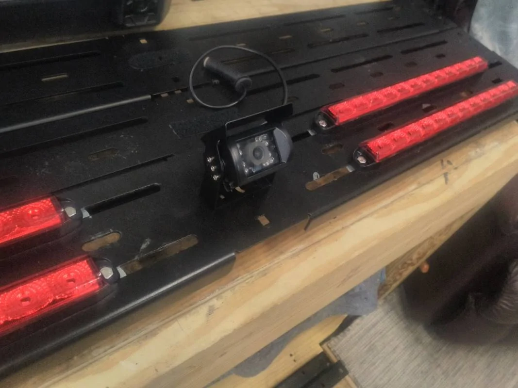

This is the best I've been able to do on this aftermarket camera anyone have any ideas?
Was that triggered just by providing power to the camera?
Looks like choice of camera might be a problem if that is you aftermarket camera.

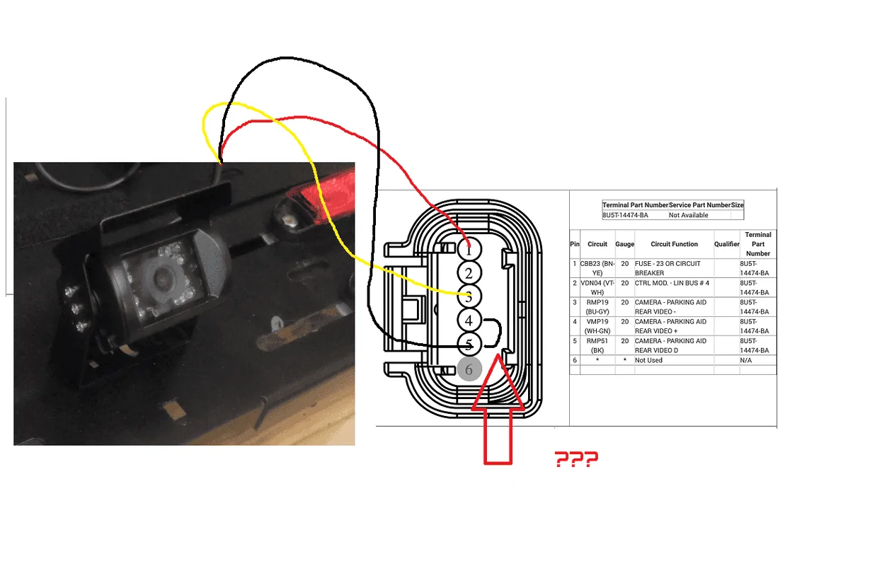

3 pin camera I am also working on the assumption the 2 pins I am forgoing are for guidelines and sensors which I don't need. Factory wiring diagram is clear as mud. I located what appears to be data signal in #3 (as #2 / #4 give no video at all when tested.
#1 is power and #5 appears to be ground.
See, I was thinking about using a camera with a standard RCA connector and splitting it behind the dash with a power relay to trigger it, rather than splicing off the original harness. It’s more wiring, but less issue with identifying pins etc..

It came with a standard 4 pin head connector, I cut it off to access the internal wiring so I could wire it to the factory system.
I'm still not having much luck, same weird screen when engaging backup camera. It is still a mystery what the unsed wire for the BUS LIN is for (though I know it speaks to the BCM).
I tried swapping both ground type wires (which resulted in a total loss of picture). Same result swapping the yellow wire to the LIN bus connection (yea I was shooting in the dark on this) At least a scrambled picture tells me I am on the right path with below config. I dunno in the end this camera may just not work with the Ford system, but it was worth a try.

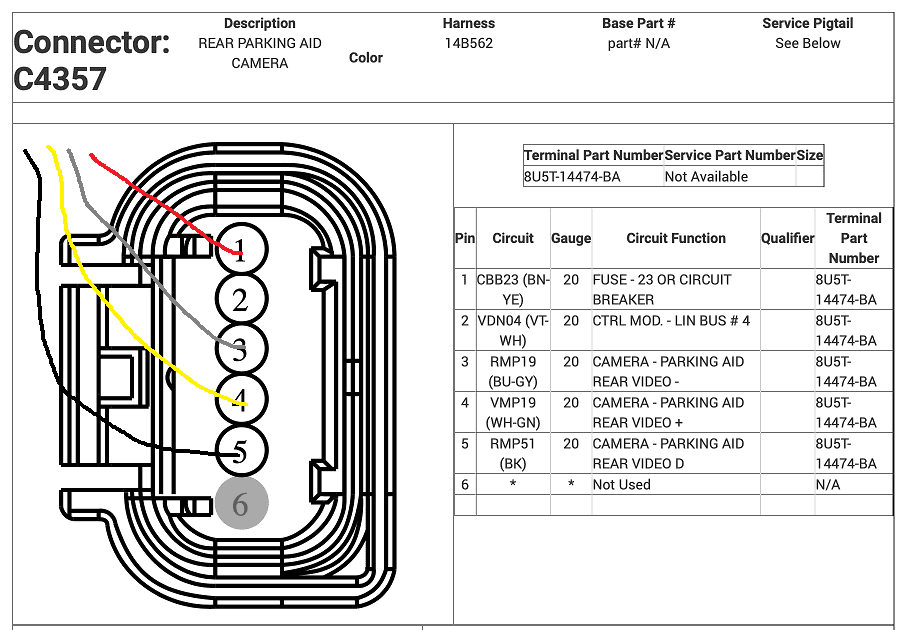

Scratch my above post's and let's start over, the attachment I posted on the rear camera diagram is vague and it does not show the detailed info, so I'm adding these, it is a little clearer.
The Data Bus is what is making it confusing, and also note the splice #301 on the power dist, the diagram for the rear camera circuit, shows the splice but not connected. I have not dealt with a CAN vehicle before and the data busses intermix all over the place, I think if you pay attention to the VDB04 and VDB05, these buses directly relate to the Camera (for clarification only) I need to dig deeper but it appears that once it passes through a connector and involves another system it changes the VBD #, even though it's the same wire. I think anyways that is how the communication side of the buss appears to work. To allow all the modules to communicate with each other and know the position of switches, PCM info etc
Hope these will help figuring it out, the Power Dist does clear it up better as far as power is concerned
Read the Camera Ops-PDF it explains somewhat better, though not perfect
Note: In the diagrams
LIN = Local Interconnect Network
NCA= Wire Unseen (Inside shielded cable)

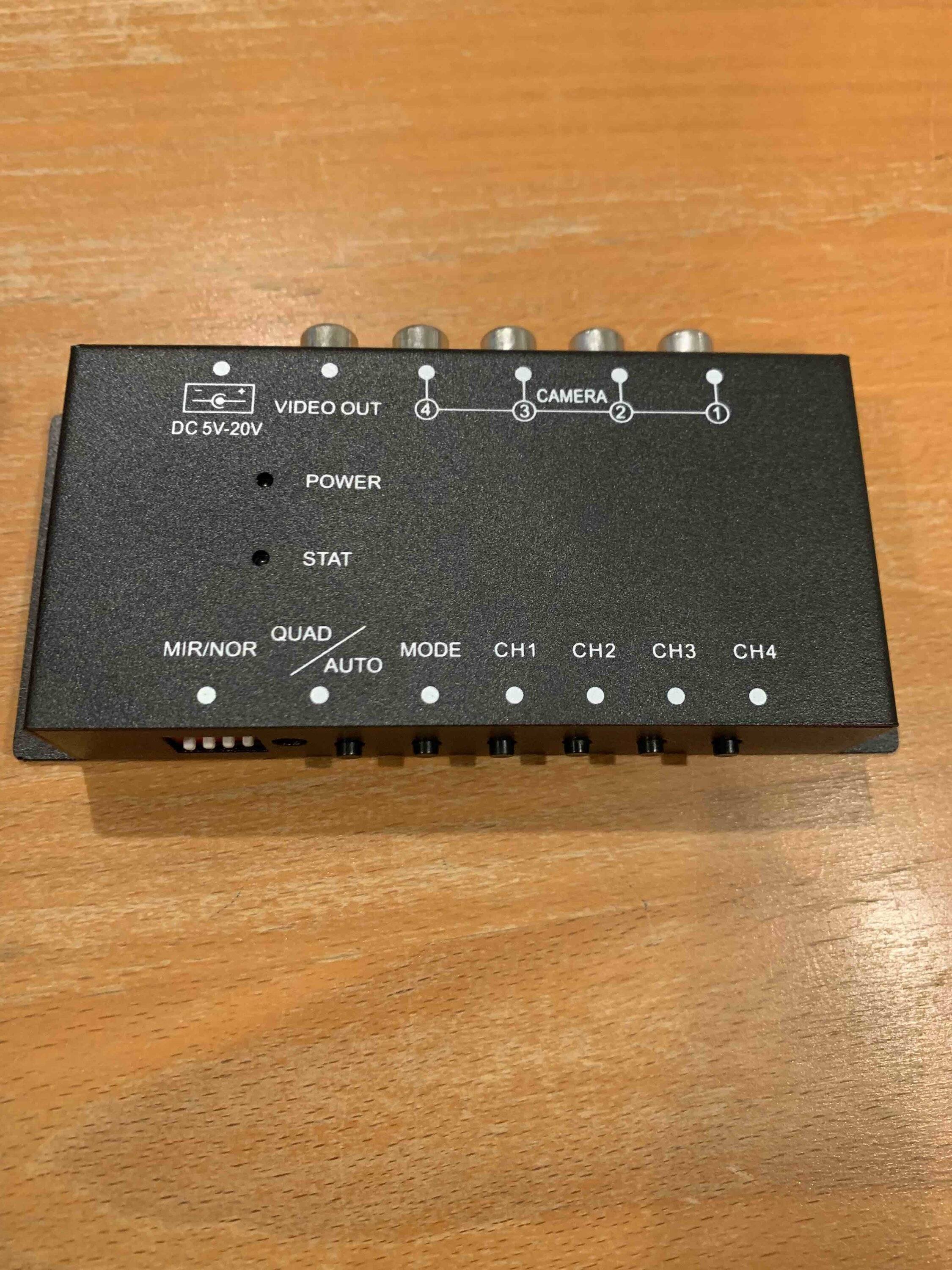

My strategy is that I picked up a simple 4 channel RCA video box off amazon that lets you select any of 4 inputs, or view multiples in split screen or quad view. Was hoping we would collectively find a simple trigger, like that powering the camera sends signal down the RCA and triggers the presentation the the video feed on the dash screen. Looking unlikely, so I may default to a separate screen for front, side and high position rear view cameras.

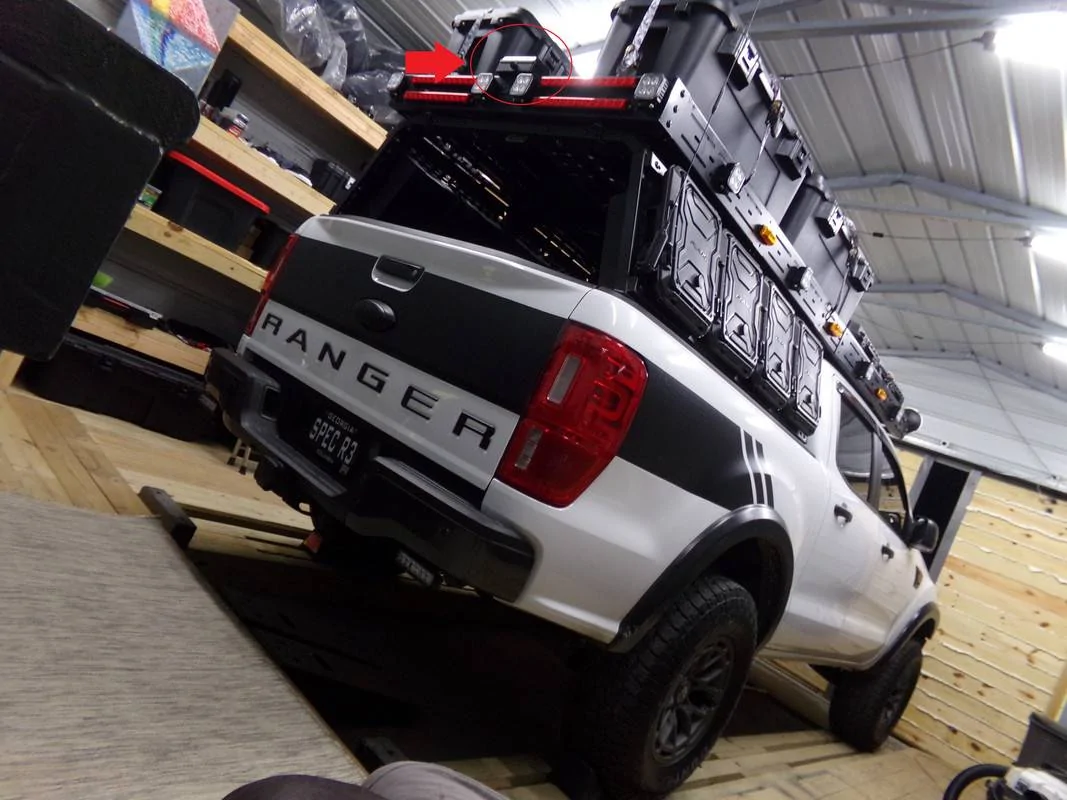

Ok the simple of it this; here is my current setup. I relocated my factory camera to the top of my rack. As the camera was not designed for external use, I basically used a trailer junction box to make a housing for it. I am assuming that is why I was tagged in the OP.
However this task was a simple snipping of the harness and extending it, re-using all 5 connections.
In a nutshell, it works fine, but I would like a cleaner install/look. So I bought an aftermarket camera making sure it used the same formatting as factory camera (ie; not PALS).
What you see in the video is the camera working (sort of), but clearly the quality is all screwed up AND its in black and white.

What I would also like to know is what does the "D" stand for on #5
I guess depending how complex Ford's system is it may require all 5 lines of use, but in general a camera should only need 3 connections, power, ground, and data. I could be working off the completely wrong assumption other lines are dedicated for parking software or such.
I believe the D on pin 5 is “delayed”. You can set the rear camera turn off to be delayed for something like 10-20 seconds.
