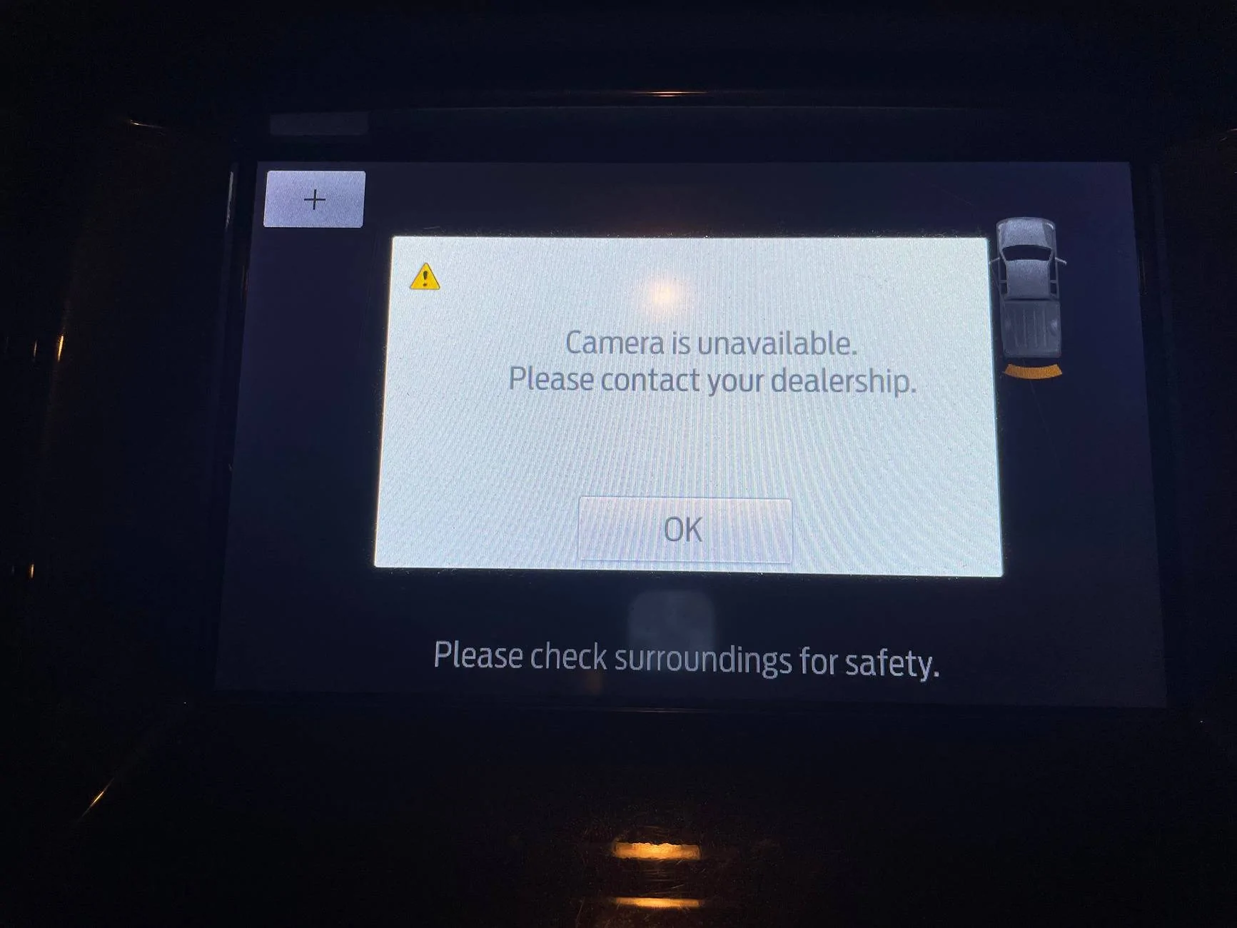

Hi Thanks to @airline tech and @RangerBill for sharing the thread on rear back up cam problem – an awesome (and successful) fault find which will undoubtedly help lots of Ranger folk including me!
So my problem is quite similar only I don’t have ford scanning ability or am that clever to be able to resolve as above. Anyhow, Ive summarised where i'm up to below if anyone can suggest further avenues before I end up at the dealer.
Problem: 2019my Ranger Wildtrack. Rear back cam has no picture just messg ā€˜not available contact dealer’
Took to dealer and they advised camera is fine, must be problem with wiring and need 2 days to investigate. Presume they plugged in and read any codes etc. They spent 1.5hrs on it.
I got it home and checked basics and discovered rear fog lamp not working either, otherwise everything else is working. So following some of the advice from the previous thread;

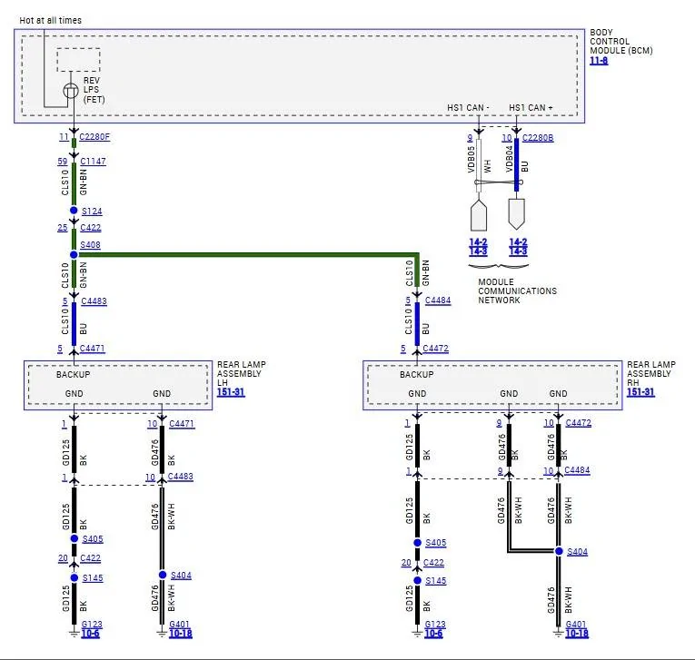

I think the Rear Camera is fine, the issue is with the Reverse Lights (US) or if I am correct (Rear Fogs) (ROW).
Either the BCM has killed the circuit for protection or a wiring issue.
The Rear Camera is not seeing power on the (reverse circuit) and that is the trigger (on) for the camera to operate.
trigger
The HS1 Can Bus, sends the signal and is the trigger when the (Reverse Lights) are powered on.
So, I would focus on the (Rear Fog/Reverse Lights) circuit IF they trigger on like the US Version and your Rear Fogs are actually Reverse Lights in the US.
I know you mentioned a Rear Fog switch, we do not have that - but I am thinking the trigger logic is the same basic operation to get the camera to operate.

Yesterday, while out and about the rear camera stopped working. Blue lines running through it, other times just black screen. The + sign & vehicle image still there as well as check surroundings msg. This was all day while out.
Today, same problem but per another post here, I checked that the backup lights were on, the plate lights were on (all led) back up sensors were working. I then put truck in drive and the front sensors were working.
Then put truck in park. I decided to try reverse again, and the camera came on as it should. Any thoughts on this would be appreciated.
