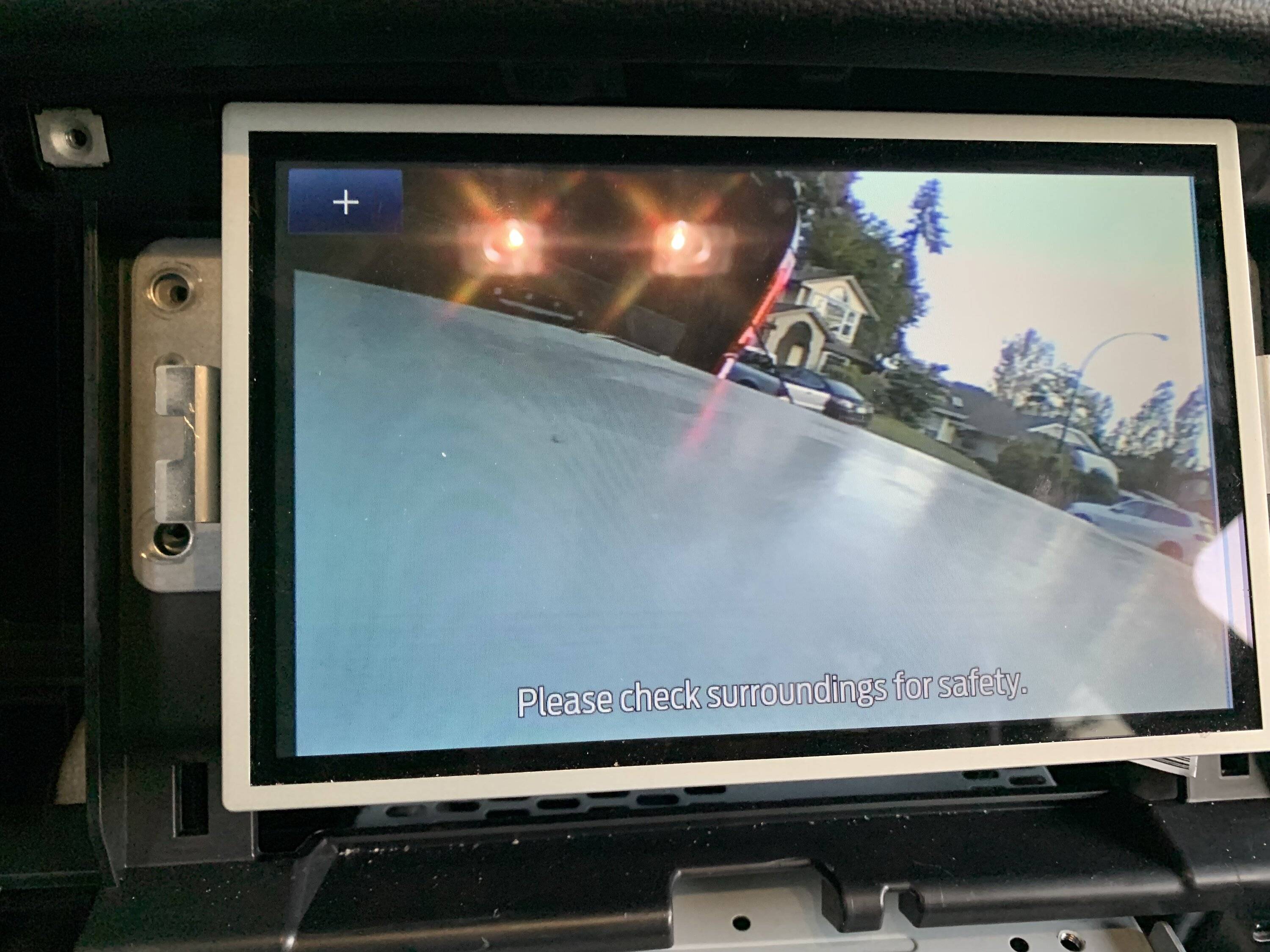

Finally go around to investigating the inputs behind the radio. Looks like the pic I saw showing a video rca connector in the dash must have been for an aftermarket system. I can confirm there is no such connector on the lariat screen or controller. I figured that was to easy to be true.
Canuckian
Canuckian
Jan 10, 2022
134
357
Canada
2022 Ranger Crew Cab Lariat Blackout

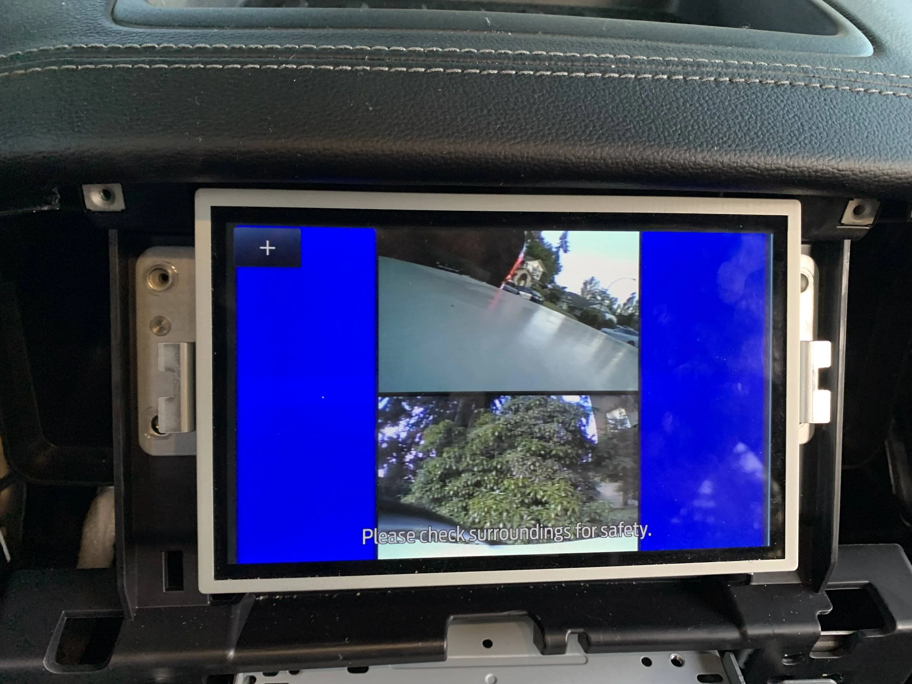

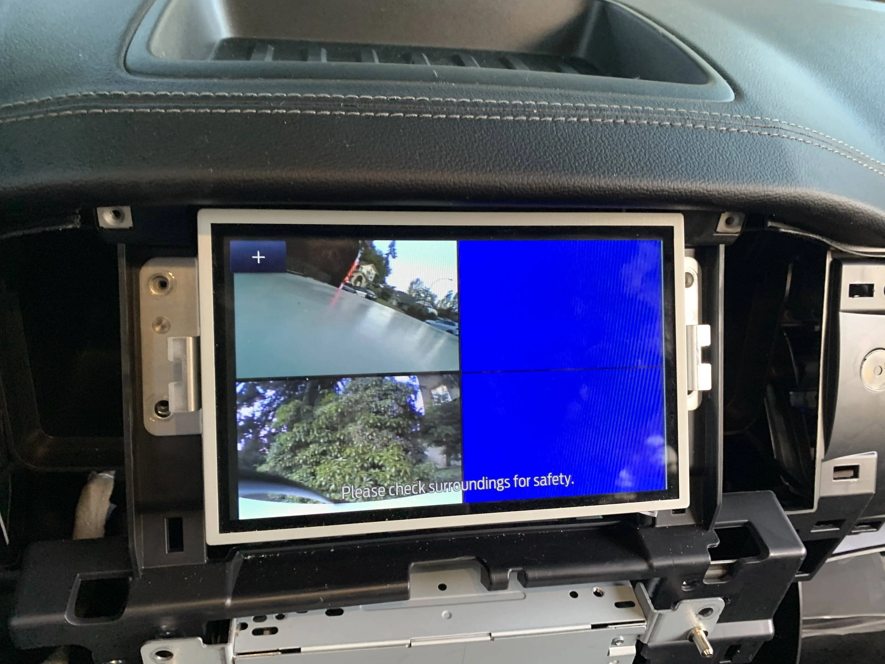

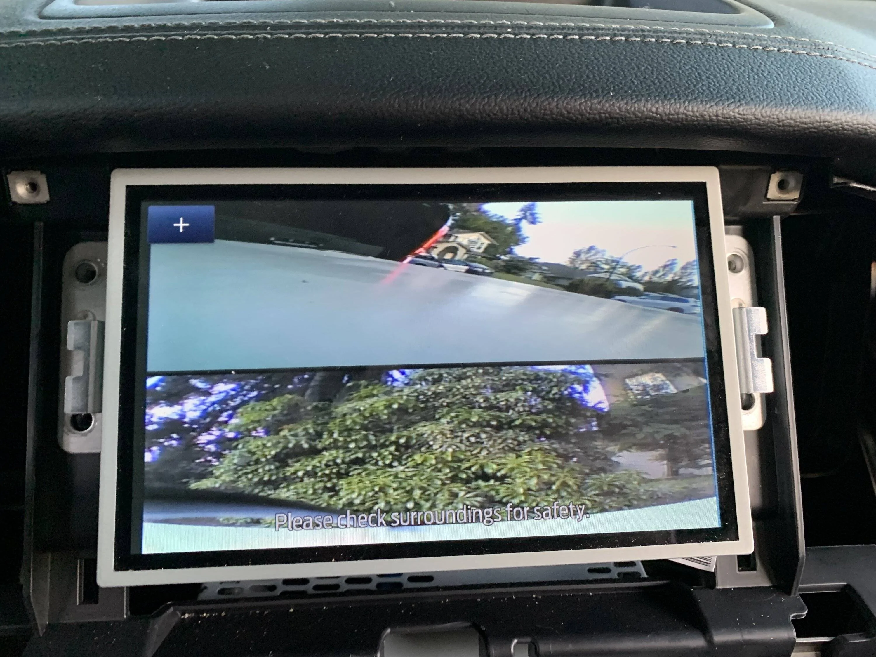

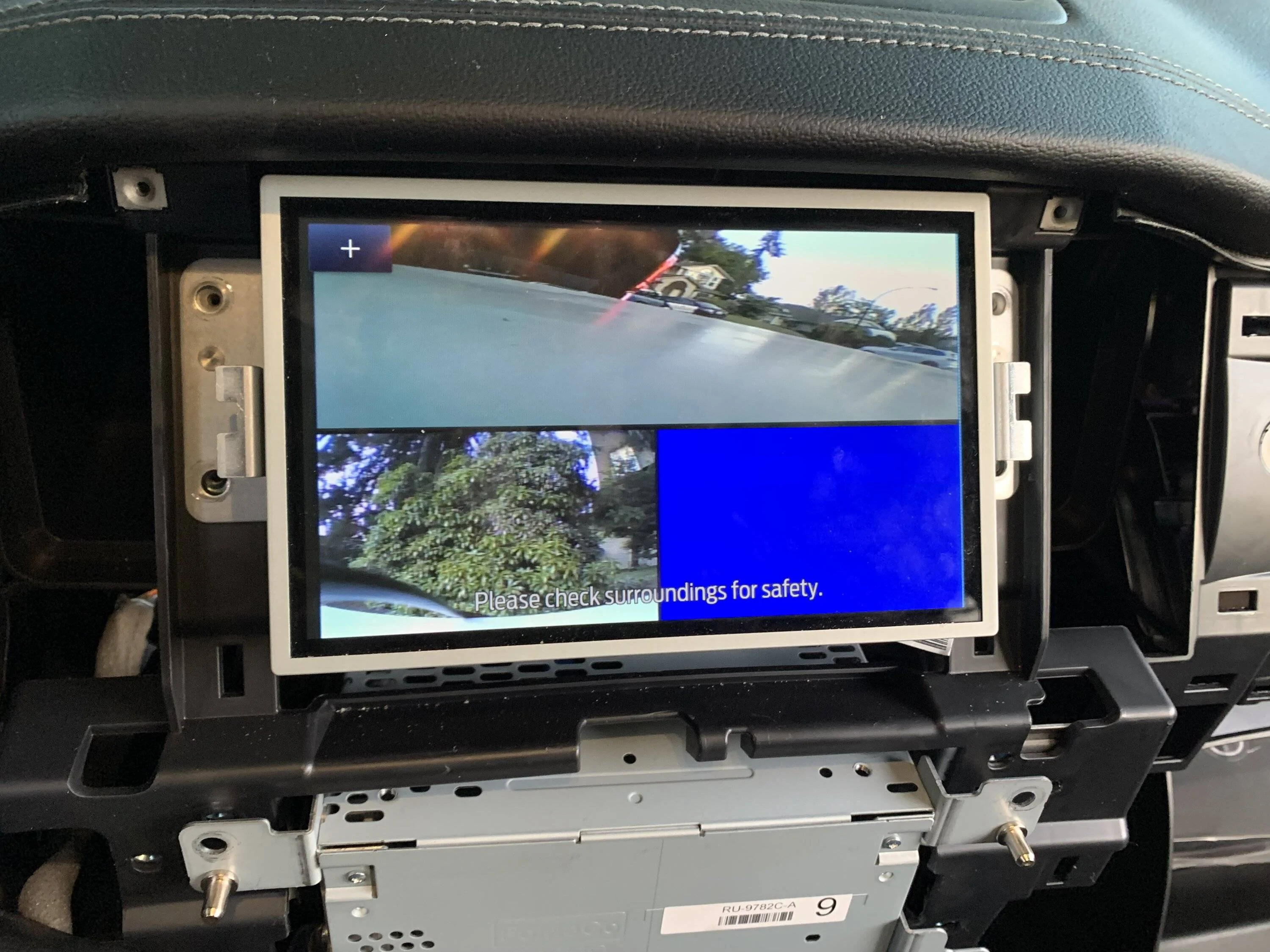

Some more progress but no love. You can absolutely tie into the connector under the tail gate and connect any camera (incl cheap rca cameras) by connecting the video source (rca center post) to the white/green and the rca outer ground to the blue/grey. This would work for mounting a backup camera up on a rack like @OFC Ranger wanted. You can power the camera separately with any 12v (or appropriate aux) power source.
My other hypothesis that the display of the camera on screen was controlled by power to the camera proved false. I hoped they may have engineered it this way to avoid failures, so that anytime the camera is power by the BCM the reverse camera should be displayed, even if the sync system isn’t fully booted up yet. Alas this is not the case.
I think that puts a nail on the coffin of trying to integrate multiple cameras to be displayed on the built in display. To do so would require overriding the sync system, which is likely how the rostra rig worked. This is beyond my capabilities and enthusiasm.

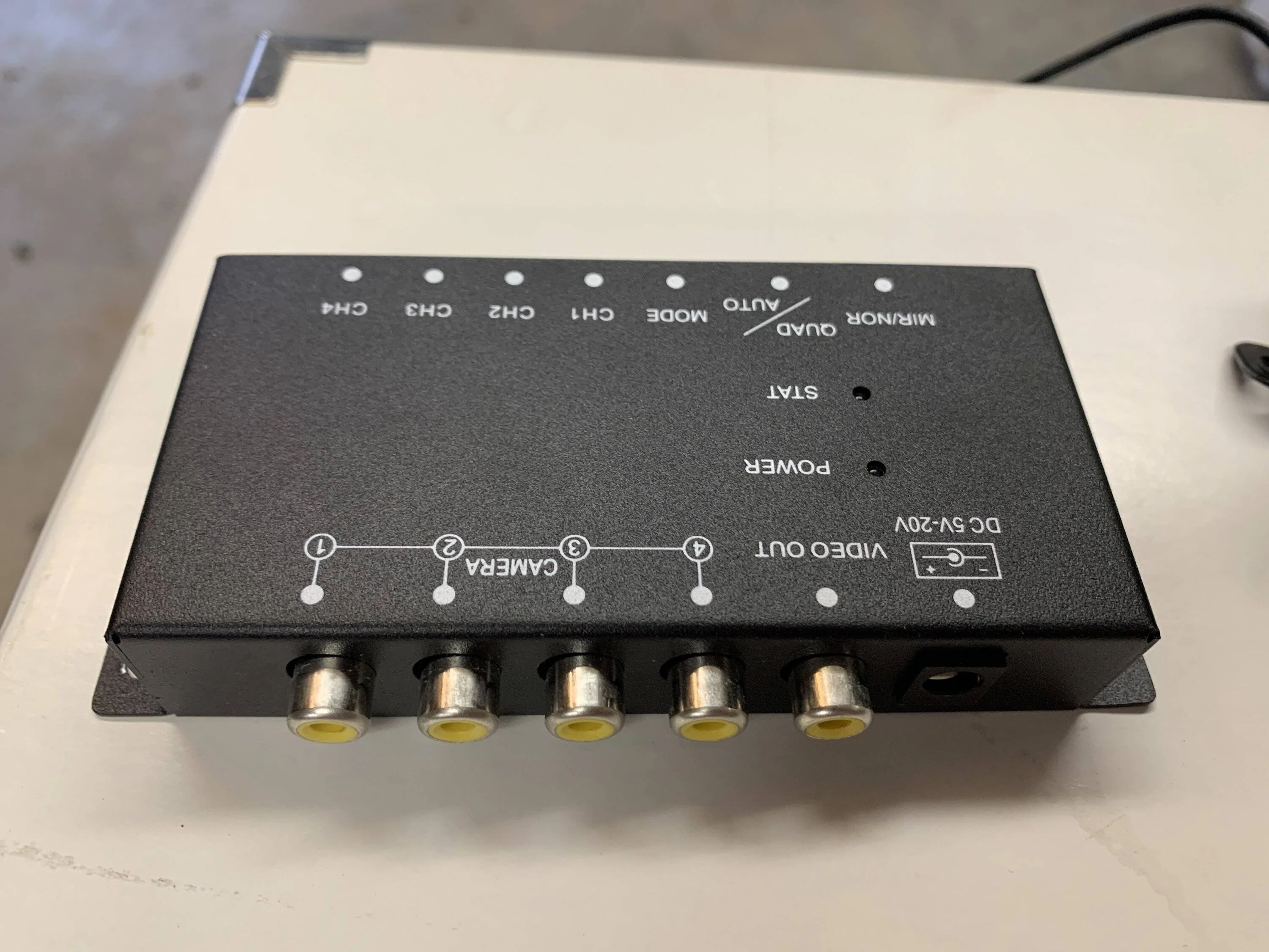

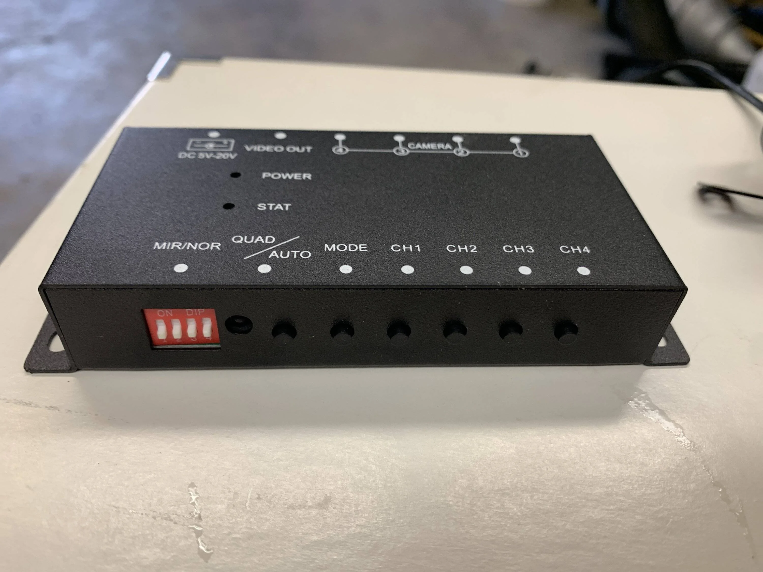

On the plus side, the RCA switching box I got off amazon worked well. It allows you to hook up up to 4 cameras and toggle between them, or display any 2, 3, or 4 cameras on split screen. I think I will try to use it with an external screen to make a custom multicam setup for off-road. I’m thinking front cam, downward side cams (under mirror or off roof rack), and a rear axle cam for clearance. Shared some pics of the split screen modes, though I only had 2 cameras connected.
BTW, here it the Amazon RCA switcher I mentioned.
