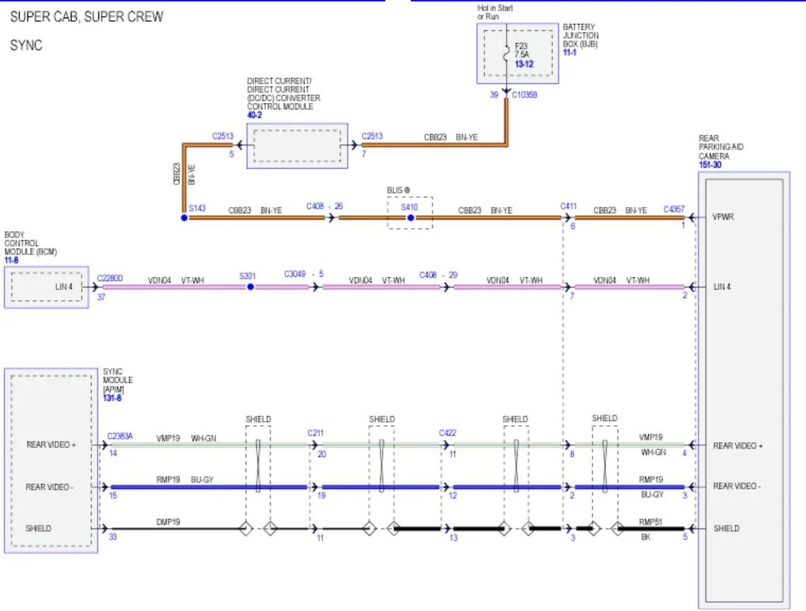

Here is the 2019 North American wiring diagram for the rear camera. I don't know if it is applicable to New Zealand Ranger. Could be the DC-DC converter or the camera itself or shorted wiring to each of those components.

Keep in mind that fuse #23 feeds more than just the Rear Camera.
So, a quick isolation - pull both taillamps and disconnect them.
Then try placing in reverse - does the fuse still blow?
If no, inspect the taillamps for moisture.
If yes, then perform a wiring check for short to ground
1. CCM
2. Left / Right - (BLIS) Modules
3. Rear Camera
4. 4WD - Switch
5. IPMA

This circuit is easy to isolate if you look at the (splice) points.
C408 disconnected if fuse blows - then its upstream and can be CCM, 4WD Switch and or IPMA
If it does not - then everything upstream is good.
and now we need to look at S410 (this splice off the BLIS and Rear Cam)
So, disconnect C411 (Connector) feeding into the tailgate, do fuse still blow?
If yes, then disconnect (each taillamp) 1 at a time, to isolate left or right.
Just a FYI (Note) S410 has been noted as a problem area for corrosion, this can possibly be the issue and blowing the fuse.
I am suspecting this is the issue (if you have it isolated down to the wiring) S410 is highly suspect.
Just something to make note of when you are isolating the circuit, as once it is isolated then it's easier to proceed with pinpointing the exact issue.
