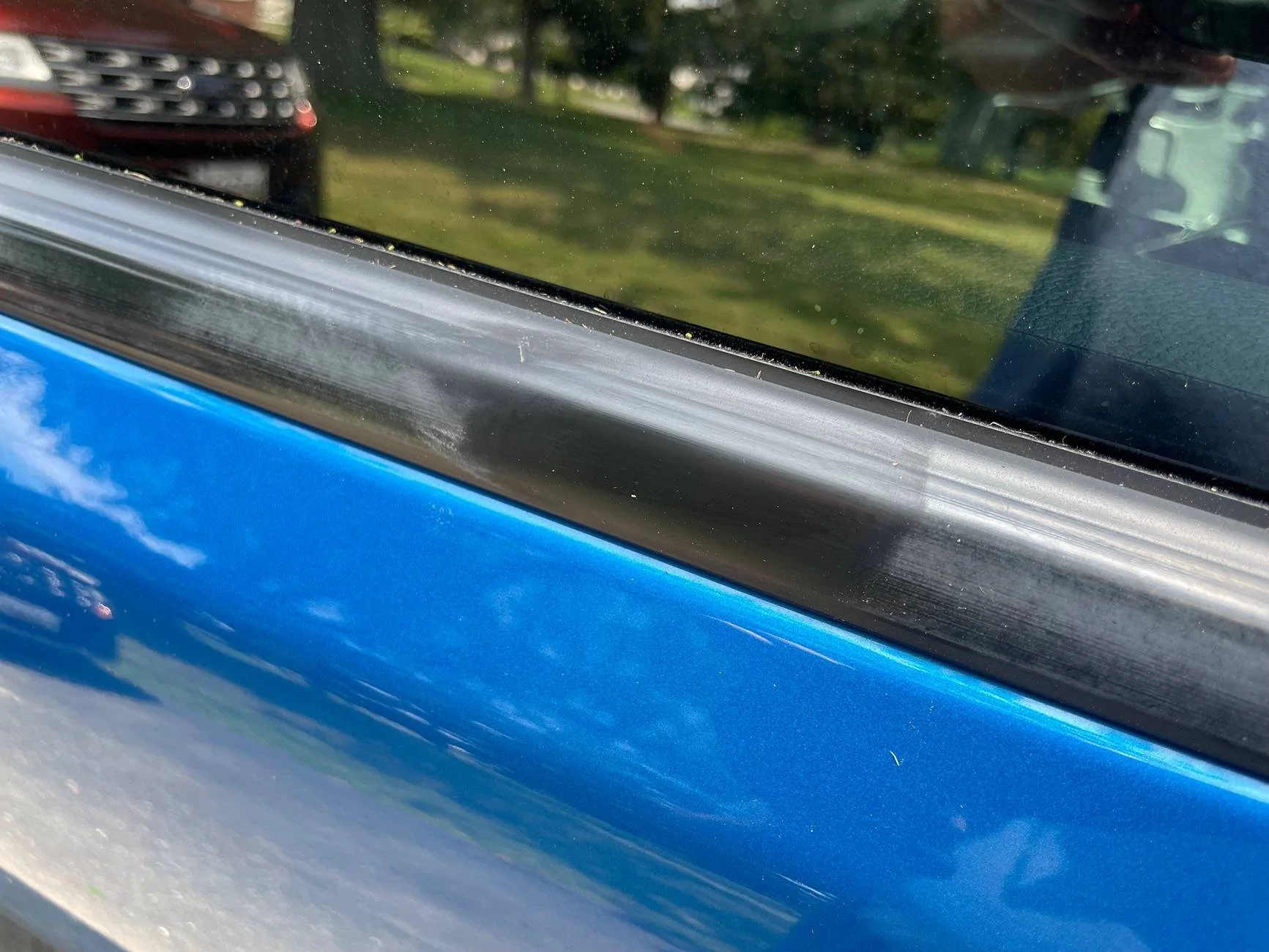

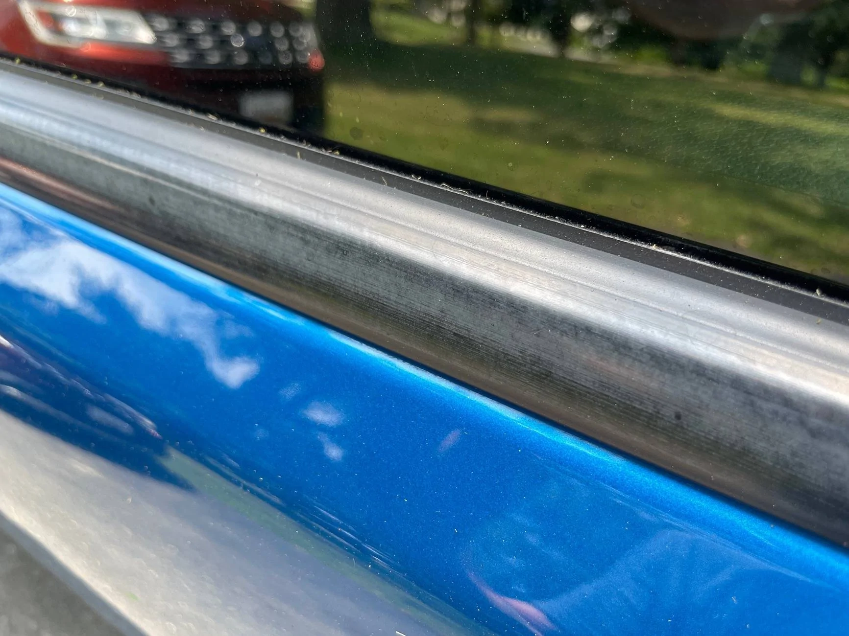

I've been using Mothers Back to Black and it lasts a few weeks at a time The side that gets sun for part of the day, fades first, of course.

Mine turned gray pretty quickly In the Alabama sun but had no idea it could have been a warranty claim.... I'm long past warranty mileage but I used a plastic razor blade and scraped the top layer off and then treated it with McKee's 37 trim restorer. Holds up pretty well

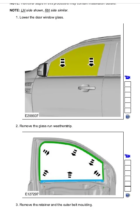

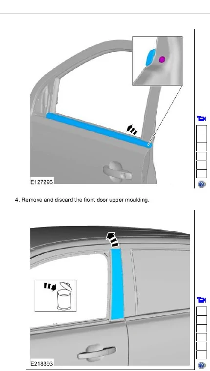

Has anyone tried to remove their door trim moldings? Mine have faded to the point where I need to refinish or replace them. I found a couple of YouTube videos demonstrating removal of the trim (on a non-U.S. Ranger) , which first required removal of an Allen or Torx set screw at the front of the door, before working the trim loose. My supercab seems to lack any such set screw, and although I tried some light to medium prying with a trim tool, I'm afraid to break or bend anything if I continue. Suggestions welcome.

Merged with the other similar thread. Try post threes advice and hopefully it'll work for you. :wink:

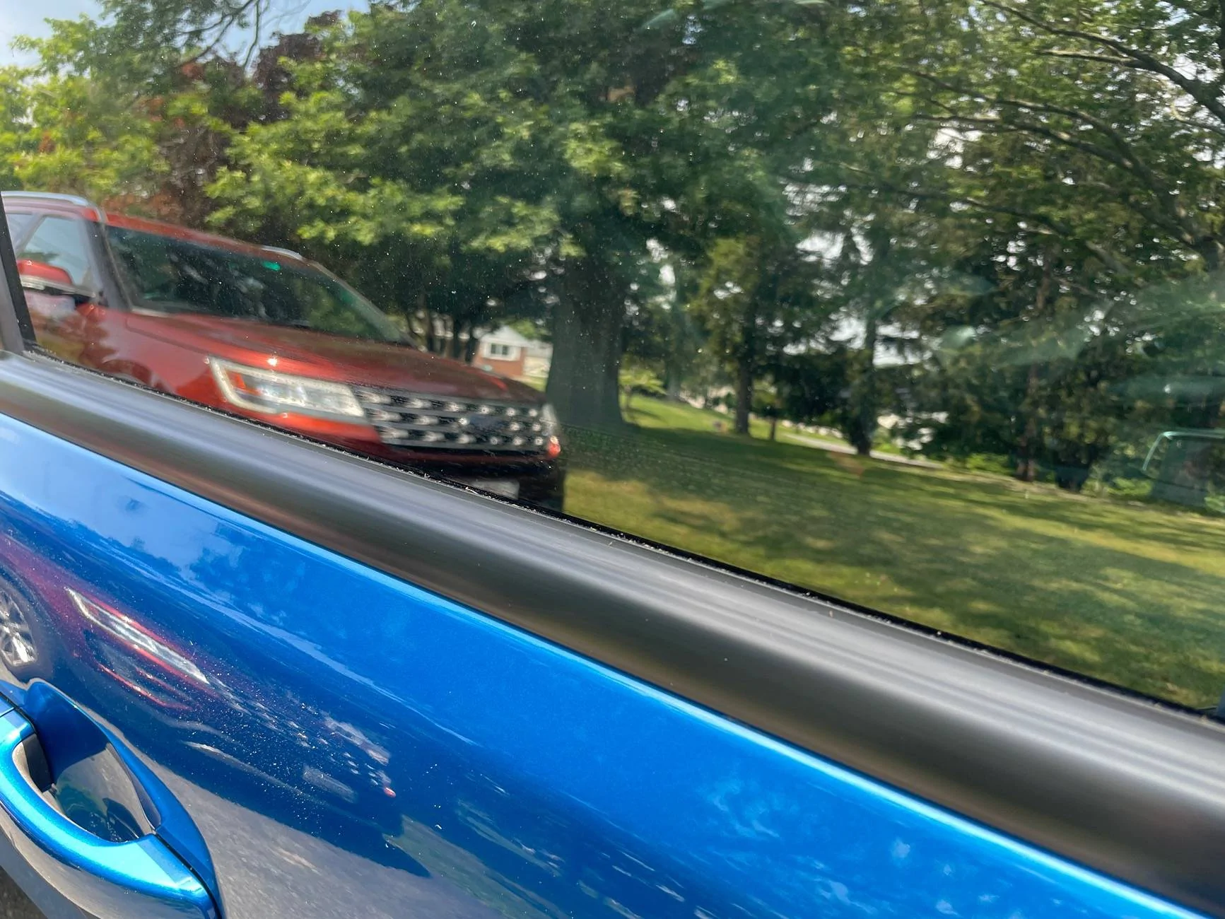

Magic eraser and mild cleaner or water will make them all better. Keep protectant on them to maintain.

I finally fixed my ugly moldings by covering them with blackout tape. The stuff I bought (Trimbrite brand 1.25") was wider than necessary so I had to carefully trim with a hobby knife, easy job though and looks great. If I had to do over I would buy 3/4" wide to eliminate trimming.
