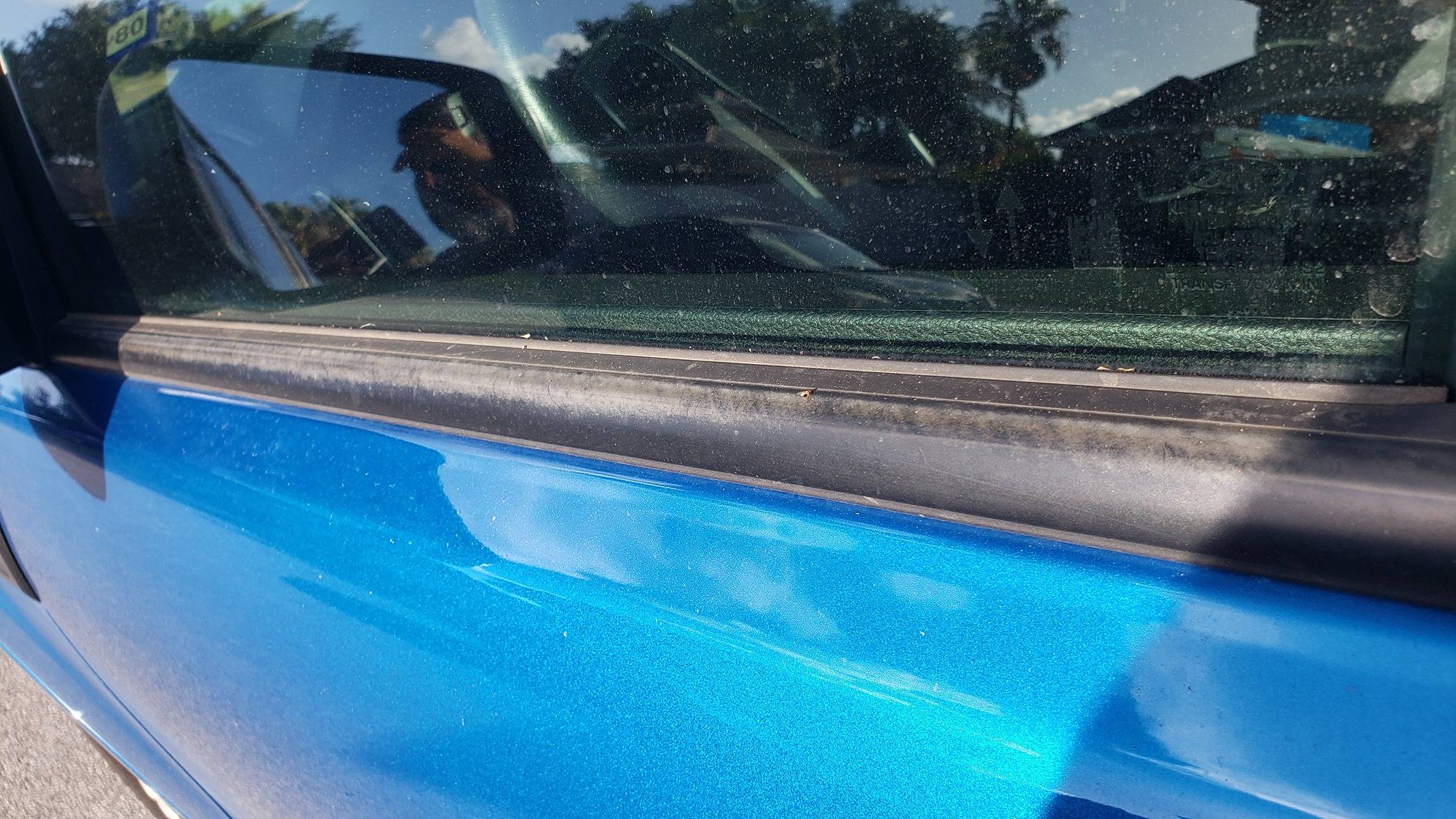

Discolored Window Trim
MXGOLF
Dec 5, 2020
1,369
5,846
Sales / Photographer
Back to Black works for me. I don't remember the brand??

What used to be black trim around the windows has now turned grey, almost white. I bought some "special" treatment to restore the black color and it did nothing. Any idea on how to bring the black back?
Most likely the sun beating down on it all day.

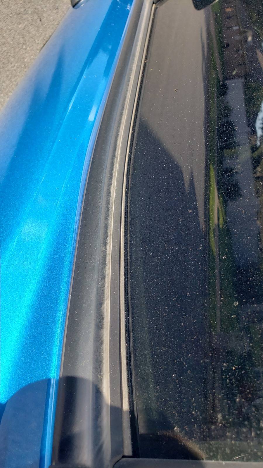

My 2019 looked the same way this spring,
2020 Ranger 4X4 XLT
My 2019 trim looked the same way this spring, the sun had bleached the hell out of it. I tried cleaning it, used 303 on it, black back and none made it look much better for very long. So to fix it I taped the door paint, the rubber on the top of the trim and lightly roughed it by wet sanding it with so 320 grit sand paper. I sprayed grey primer on it then a coat of satin black spray paint. Not quite like new but a far site better than before.
