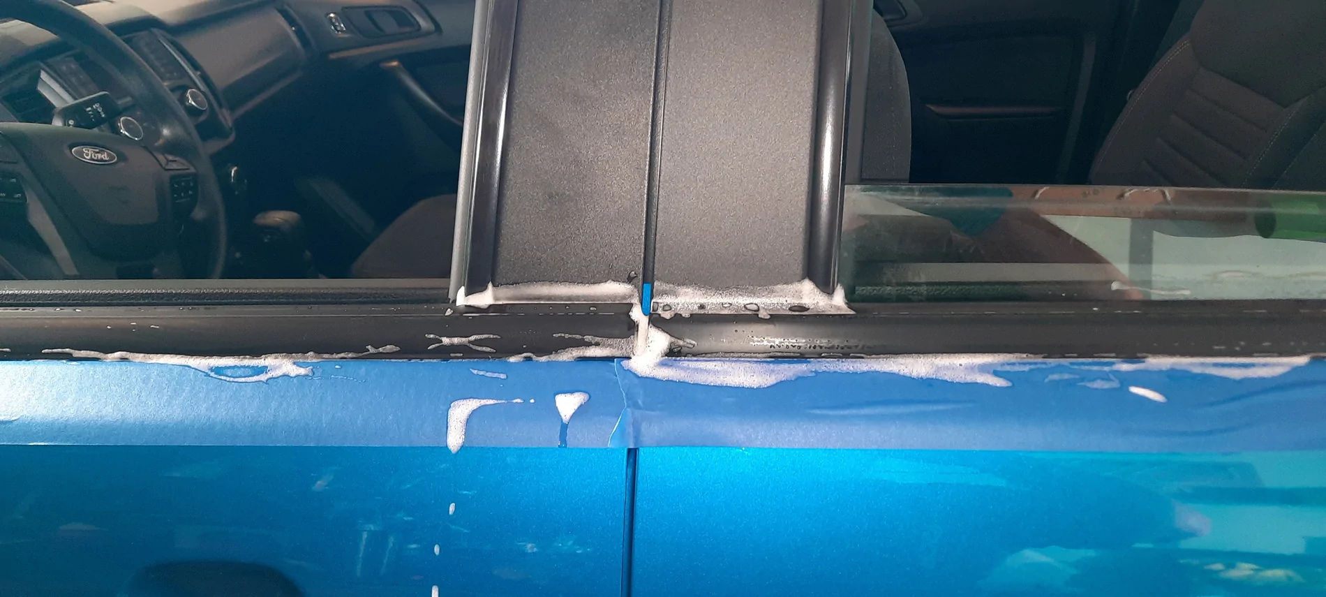

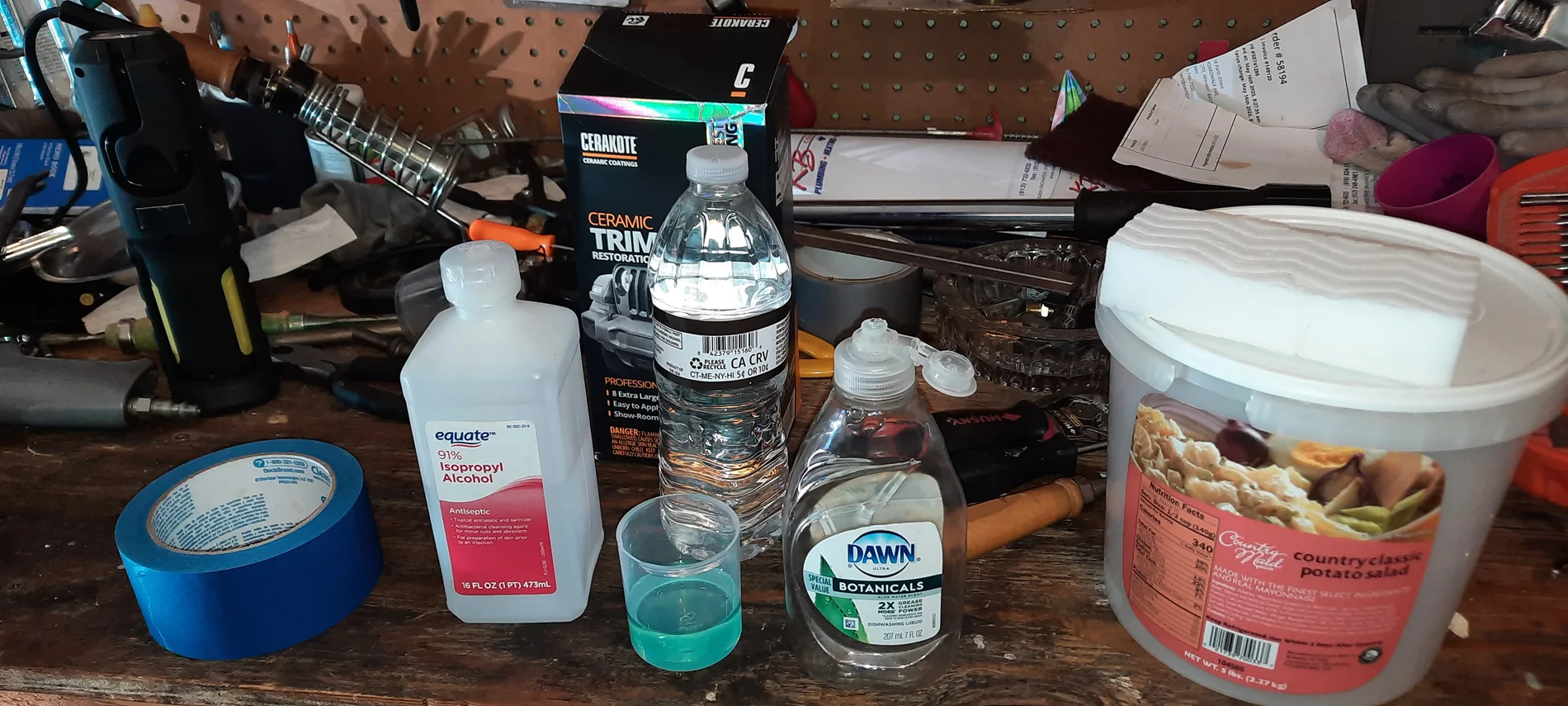

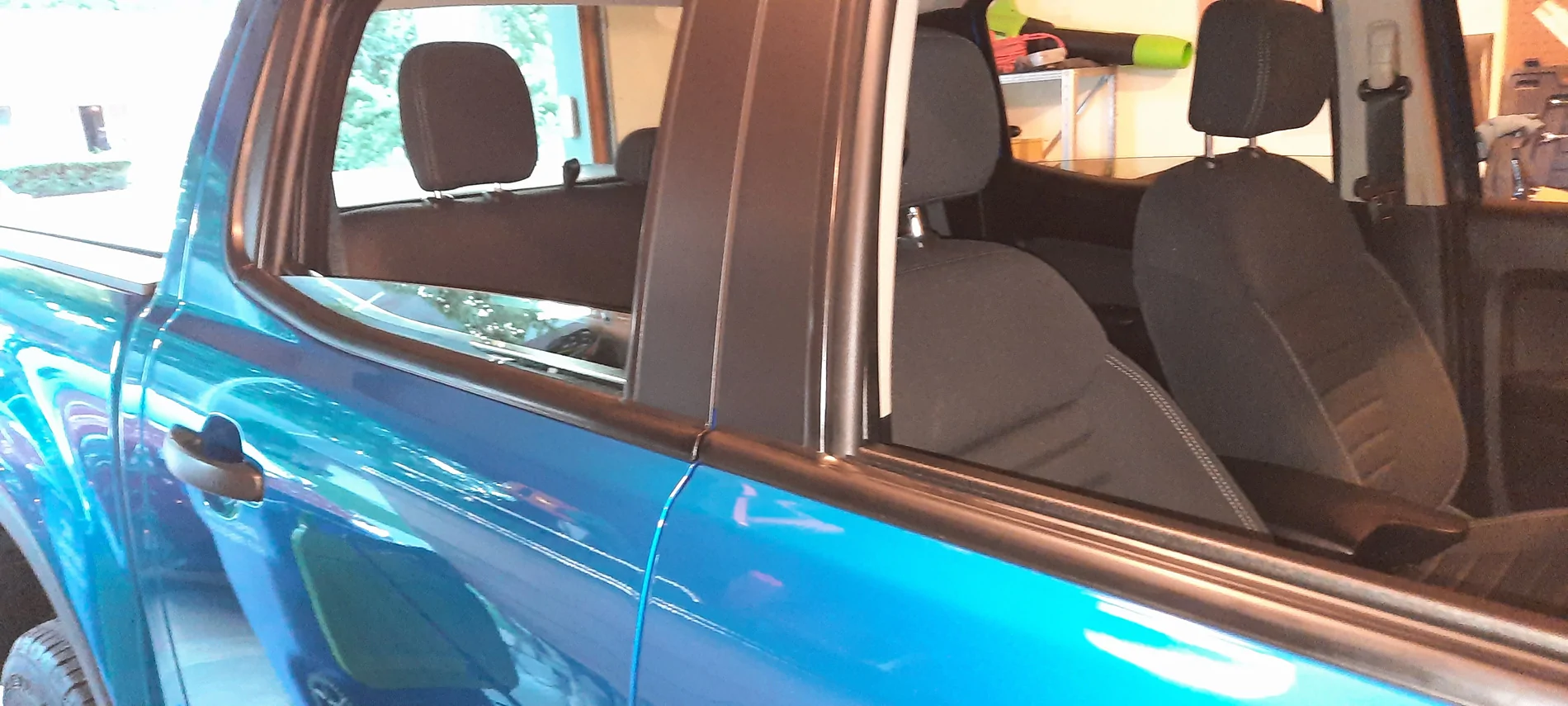

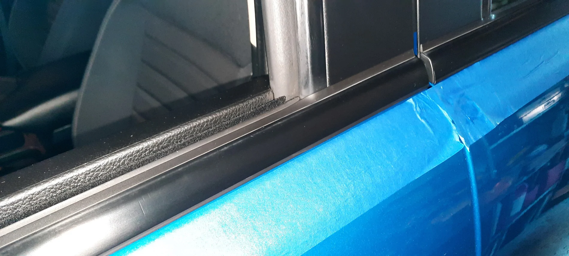

Went and restored my trim tonight with Cerakote. Started off by prepping the trim with:
1 oz of Dawn
1oz oz of alcohol
1 bottle of water
And the magic eraser
Clean but not perfect. Didn't want to dig into to much and Cerakote is supposed to restore the color. I just wanted to make sure no coatings or preservatives are left on the finish.
Can't believe how much crap I got off the trim and I think I take pretty good care of this truck.
Trim looks brand new now. Now I just need to let it cure and we'll see how long this last. From some YouTube videos show this product lasting 2 years or better.

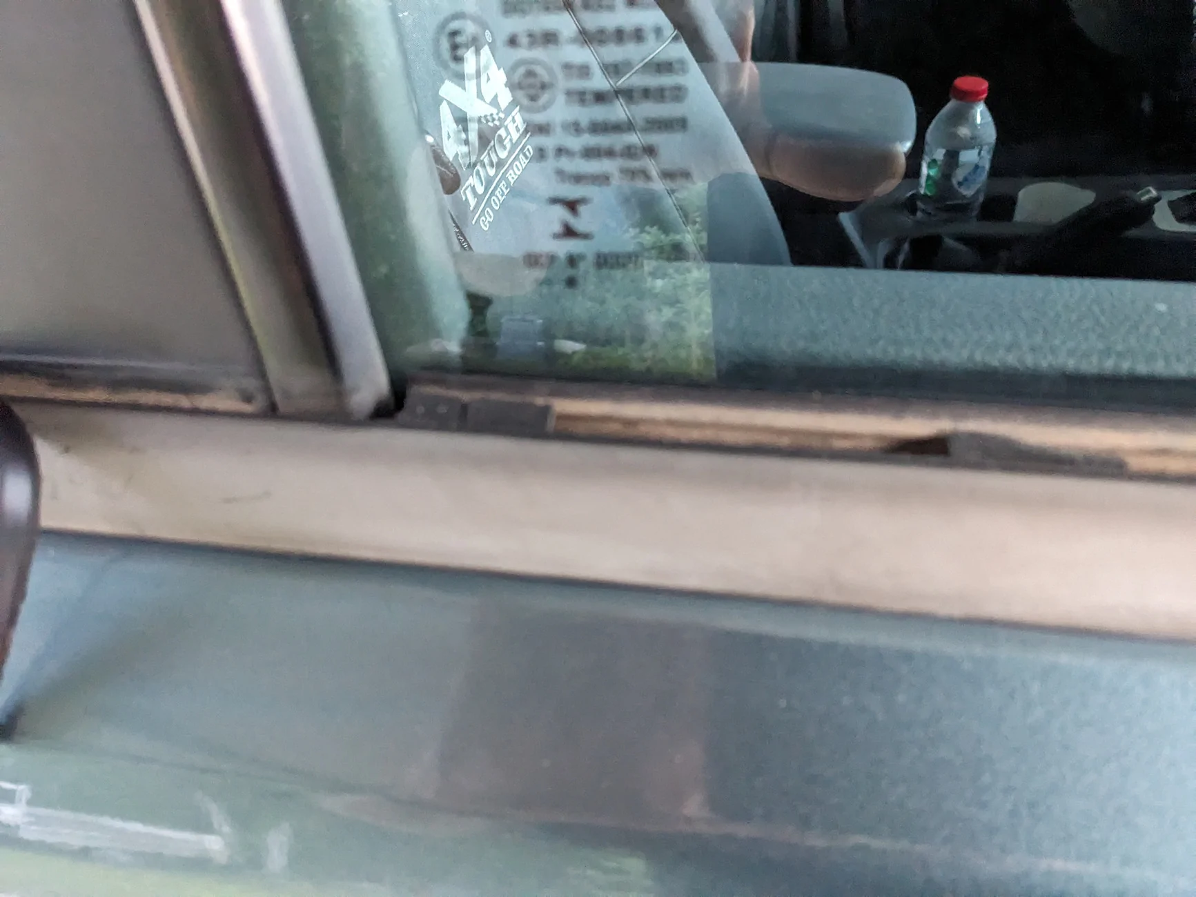

Oh and so I can't be accused of derailing the thread too much, here's what your grey window seals will look like in 10 years time, mine is a mid 2015 model and just had it's 10th birthday.
I tried every possible product but they eventually still just crumbled. I'm going to have to replace them, local replacements from Ford are only mildly extortionate. This and the sun-glass holder inside which will no longer lock in the up position (will have to replace that too) are my only two real trim failures on the truck so all in a pretty good run from Ford, who hasn't always had the best reputation for build quality over here.

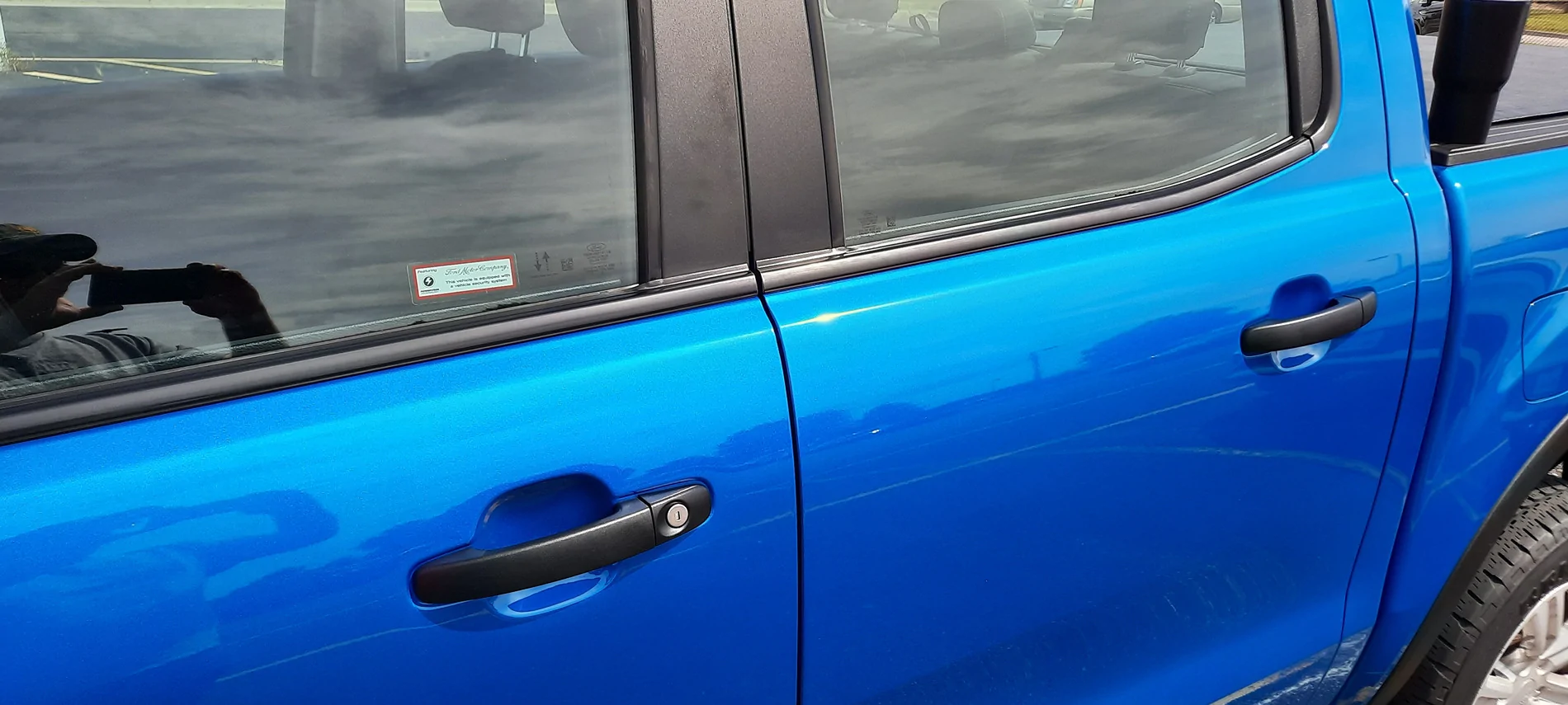

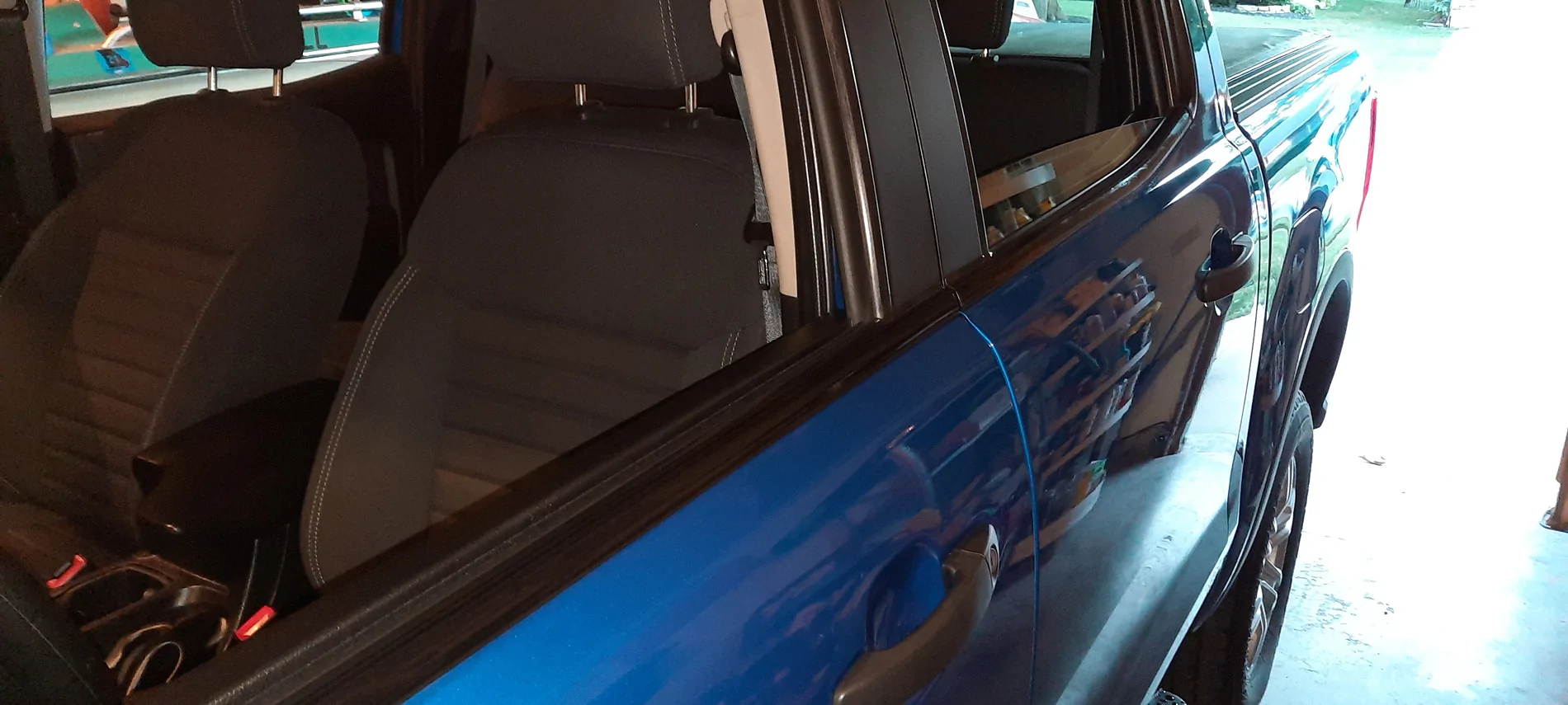

All right last pic, I wanted to get one out in the day light so the 5g crew could get a better look than my dimly lit garage. I did put a seconded coat on last night and that made it look great.
Since my door handles were looking a little faded and my wipe still had some life in it, I decided to do those too. I think they turned out great as well. :rockon:

Wow those are ate up.
I don't think anything will bring them back when they get that far gone. Good call on going with replacements.
