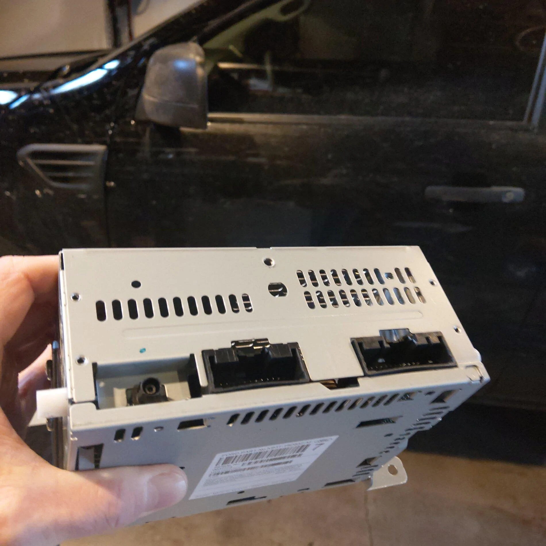

You have B&O system? NonB&O systems have the amp inside of the ACM.

Same, the sub makes it almost like you're driving over rumble strips. Didn't care or hardly notice it before the sub unless I was trying.
Is this the ACM? Just curious.

Looks like it. The display and "headunit" are no longer one piece.
