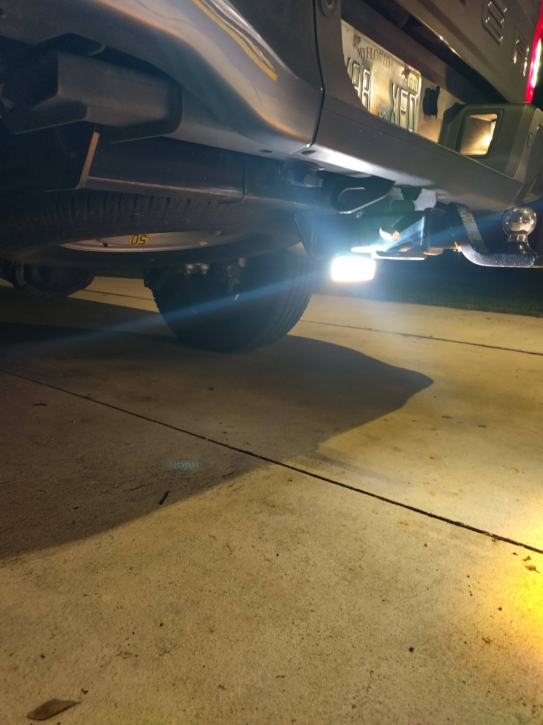

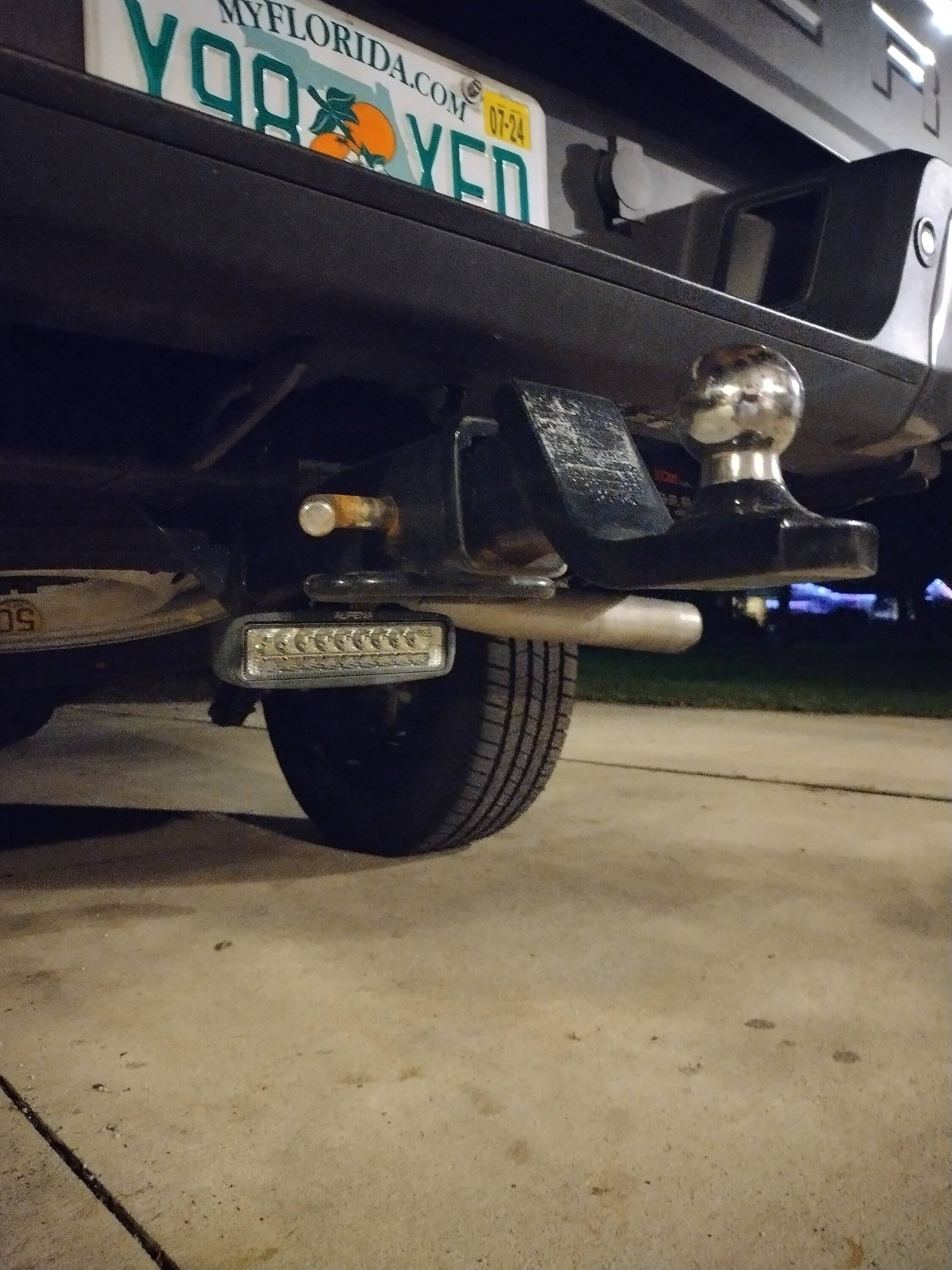

I picked up this inexpensive LED light from Walmart a couple years ago. Installed it just below the hitch and splice tapped into one of the reverse light wires for power.
Light works great, and makes it much easier to hook up trailer or launch boat at night without blinding other boaters.

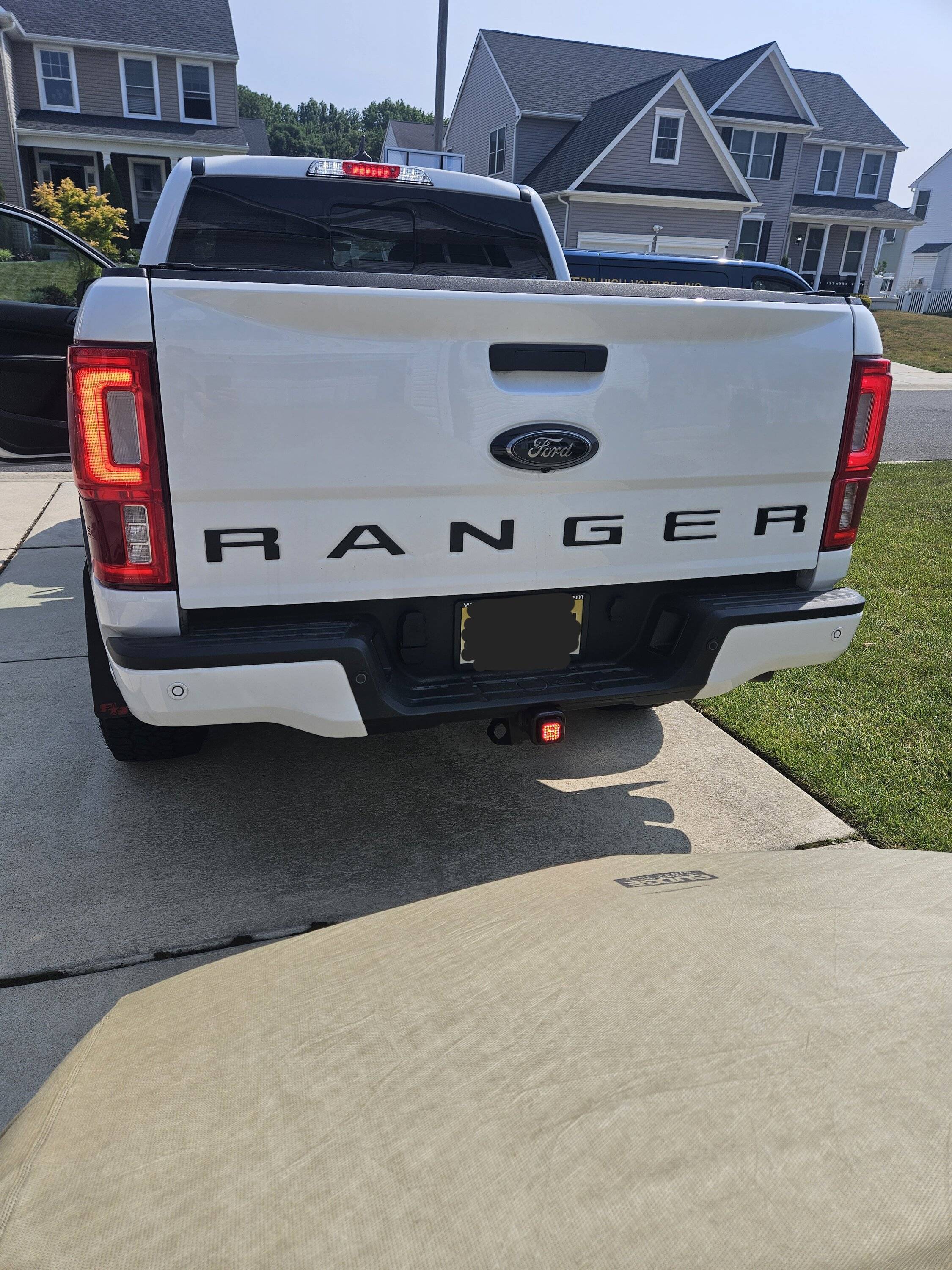

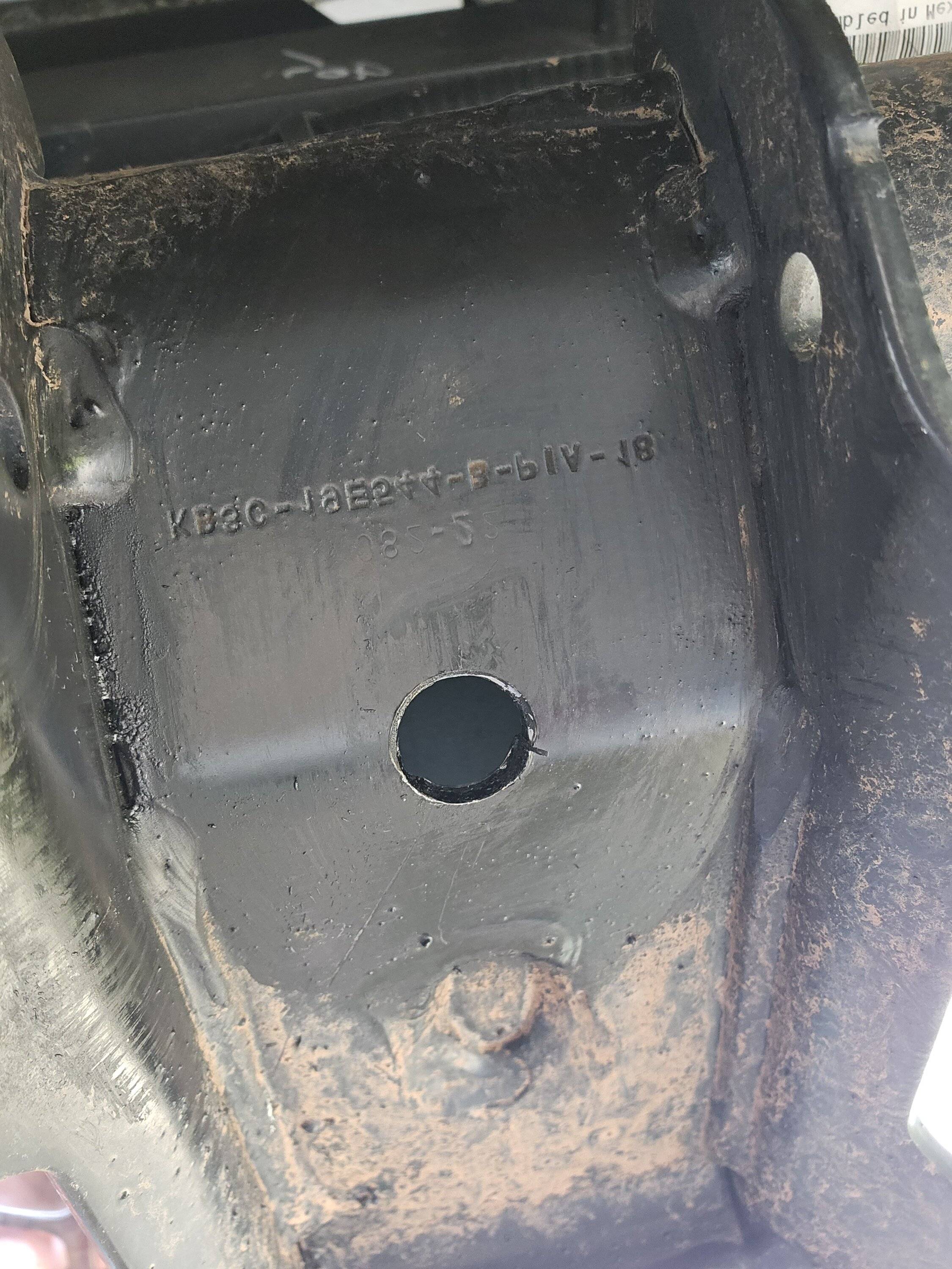

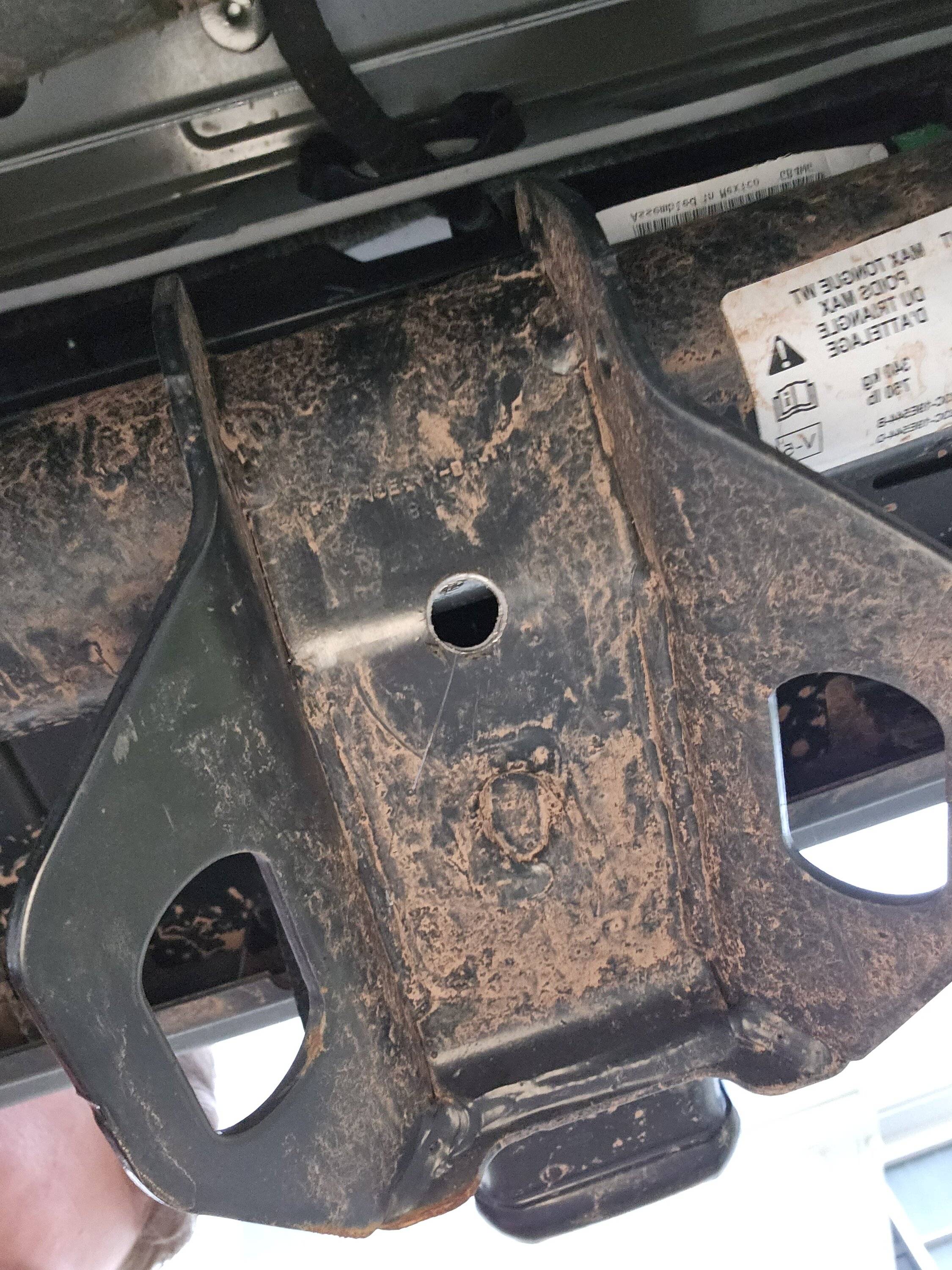

I installed mine over the last few days. I've learned a few things about myself... on one hand, there is the engaged DIYer out to do the job the right way, hopefully saving some money as I go... and then the "me" that installed this. Self imposed time crunch, desparate to hit a milestone (the new red light turns on when I hit the brake), and likely to incur additional costs in my haste.
So I drilled a little hole the other day. Pretty centered considering i eyeballed it and i was drilling into the angled part to help facilitate with drainage in this area as well. Admittedly, I did take the bit for a walk on the first and second attempt after deciding not to walk 15ft to my work van for an auto-punch.
Then made that hole larger. Still looking good in my book. Don't mind the northeastern mountain mud. I've come to terms with the idea it's not leaving my undercarriage anytime soon.
This is where I let it go off the rails in about 30 seconds. First, I bailed on my proper method for painting the newly exposed metal. i did not properly debur my hole prior to painting, nor did I attempt to lightly clean and scuff the surrounding area to aid with better paint adhesion. Used no tape to prevent unnecessary overspray and ended up wiping tons of excess off
disassembled rhe deutsch connector and fed it thru- reassembled without issue. Then proceeded to break the oem 7 pin plug detent trying to get the plug off under the bumber ($$$).
and here we are - A questionable semi-successful install ?.
Lesson here is take your time, and don't force this stuff for no good reason.
That said I can say my truck doesn't appear to "see" the light and think I'm towing anything.
Anyone have the part number for the 7 pin plug behind the bumper?

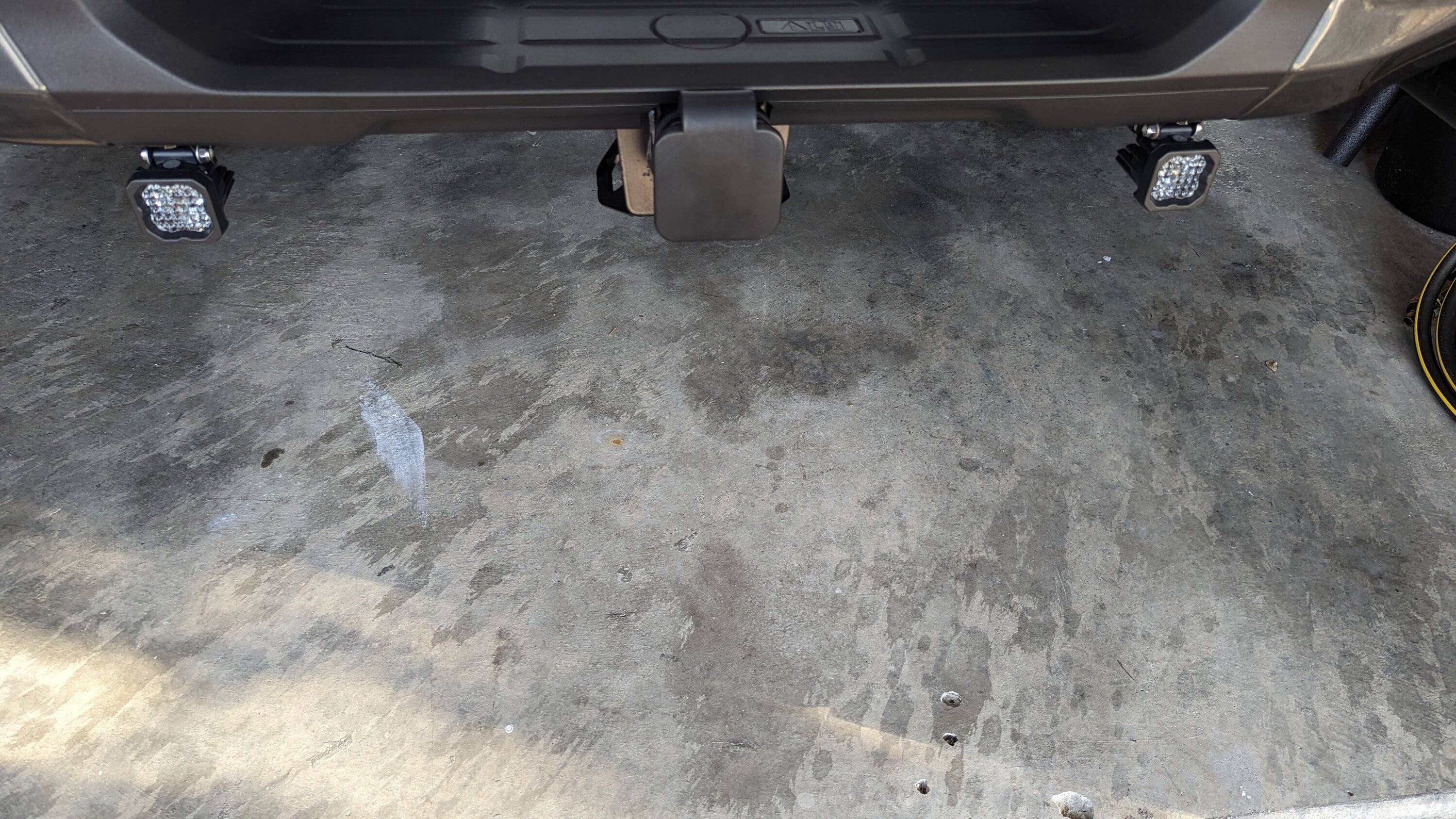

Hitchmount without using the hitch. ?
Here is what I did. I used the holes that's already near the hitch and placed 2 C1Rs.
I'm using a different wire harness from DD. The truck doesn't think there's a trailer.
It comes with a T tap wire. Hook it up to the back of the taillight and the rest to the 7-pin. That's it. You will need to buy an extra wire and splitter from DD for this set up.

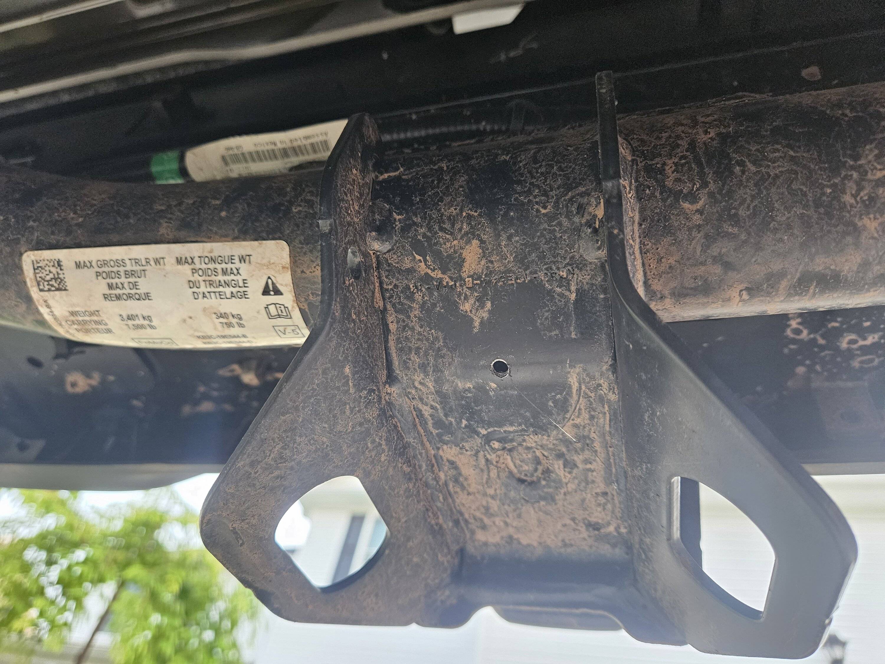

Anybody try this using the Baja Designs S1 hitch pod?
Baja Designs Universal Hitch Pod
I just got one, and I’m running into all the aforementioned issues, starting with the closed hitch at the rear.
I’m not completely against drilling an outlet hole in the back/bottom of the hitch for harness pass-thru, but all the trailer and tow signal errors sounds like a pain….
My fault for not checking the forum first and for not even checking my hitch beforehand, but just curious if someone has tried the install with Baja Designs and not Diode Dynamics.

If the BD is strictly an added backup light, I don't believe you will have the Trailer connector issues. The trailer connect issues come in when the hitch pod ties into the brake/turn circuit of the trailer connector. This is the circuit the truck uses to detect a trailer is connected. DD has updated their harness to get the brake signal from the taillight, using a T-tap, to bypass the trailer connector.
All you can do is hook up the harness and plug the light in and try it before getting the drill out.
