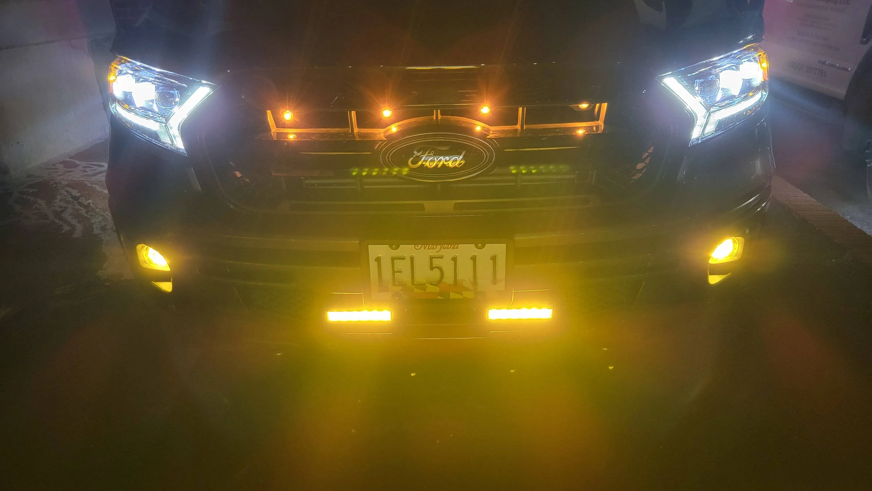

I have the same ones (driving lens) in yellow and the (easy height adjustable) Elite Series yellow fog lights. I bought Y-splitters and used the fog lights as a trigger source for two relays and put a 5A fuse in-line to the battery to power the 6" lights. The 6" lights only come on when the fog lights are on. I have the fog lights set up in forscan to come on when turning. Both the fog and 6" light turn on while turning now even if fog lights are not turned on. I verified with Diode Dynamics that a 5A fused source is good to power both lights.
Here's what it looks like.
