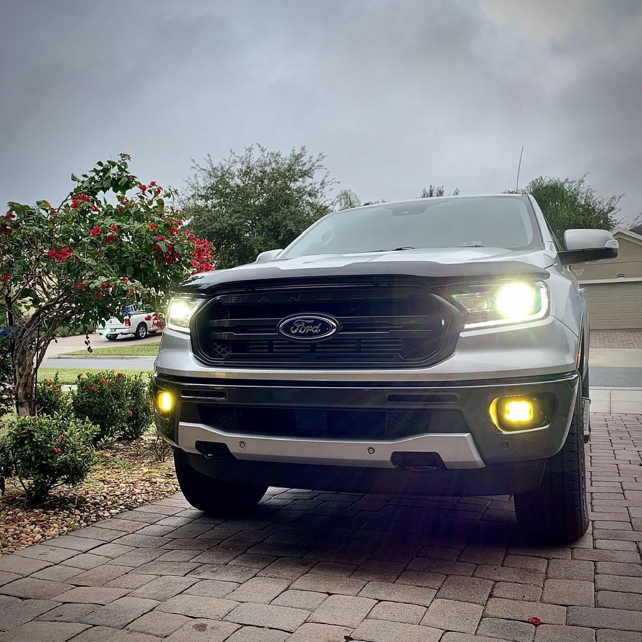

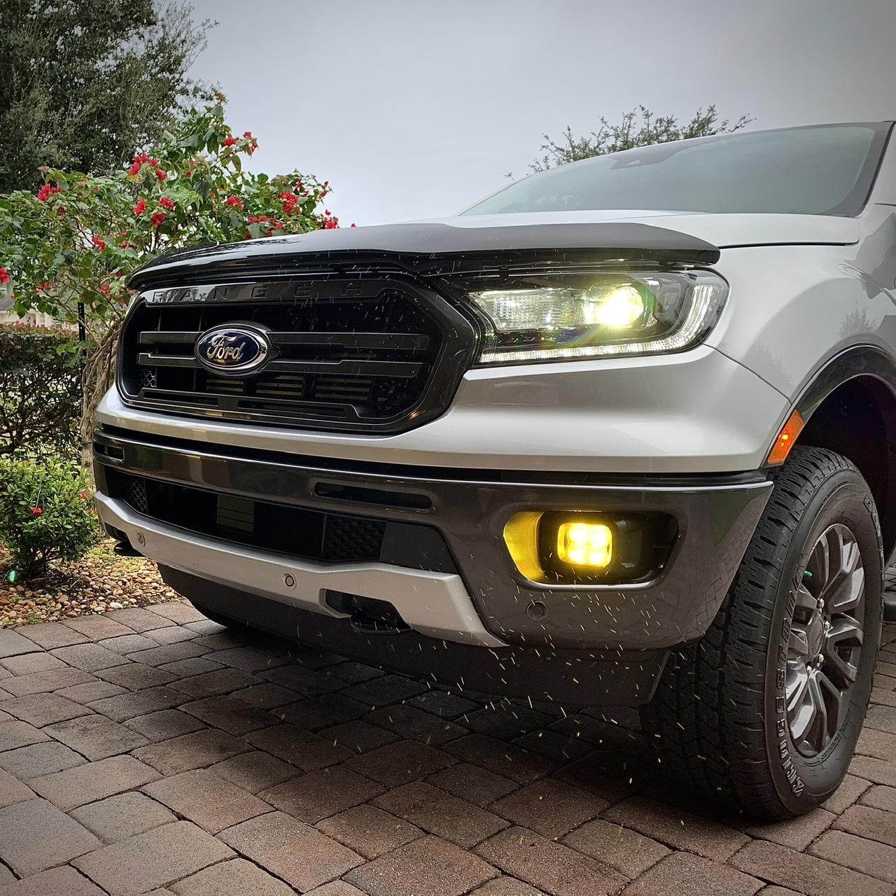

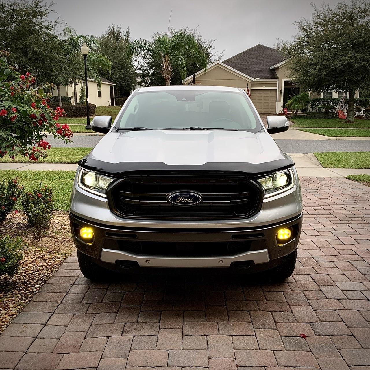

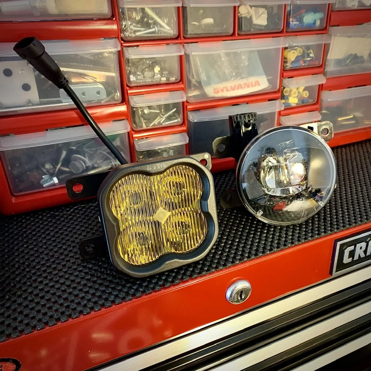

Installed mine this morning, just in time for this gloomy day.

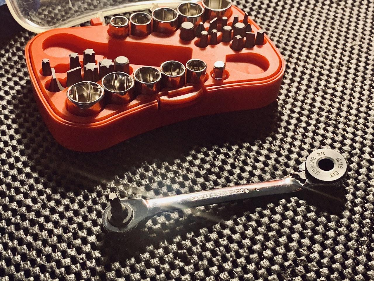

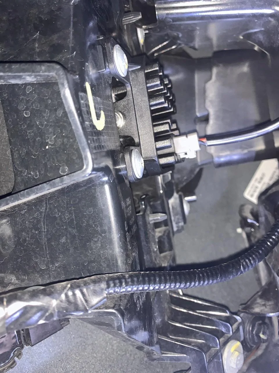

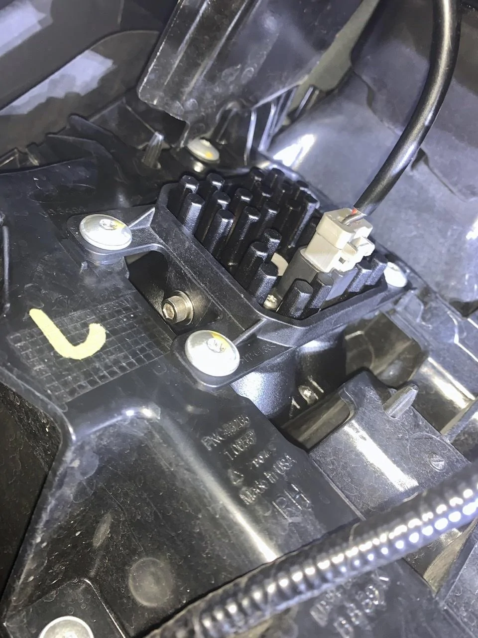

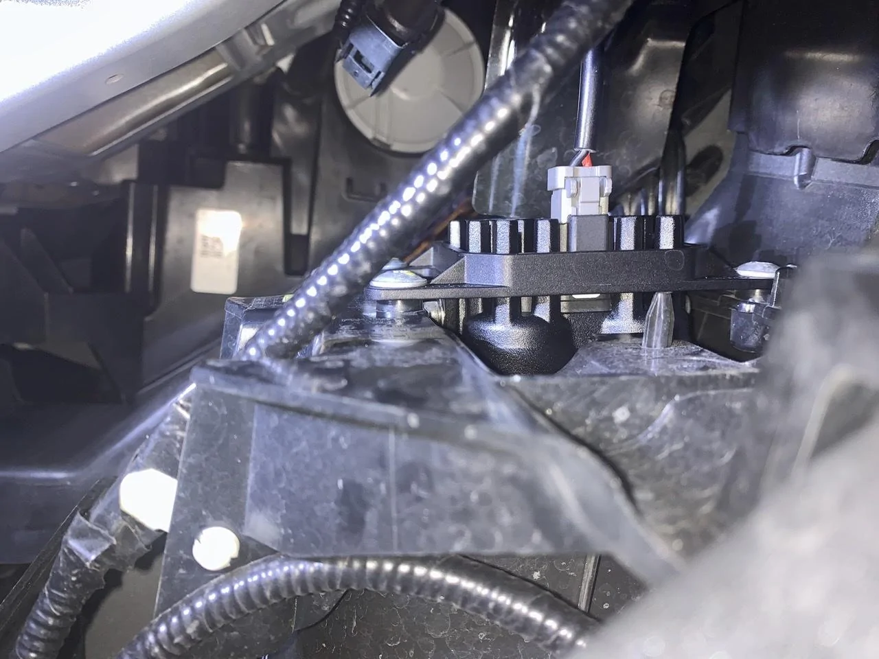

I was going to follow Stage3’s video for the Baja Designs fog light install, but found it much easier to simply reach up under the bumper and remove the 4x screws holding the fog lights in place with a shallow GearWrench and a T-25 bit. There was plenty of room to swap them out without the need to remove the splash guard and bracket.

Cool...did you take the pics from your vantage point underneath?

That first picture is what I see when I slide under and look up. The subsequent pics are from me sticking my phone inside a bit to show the amount of room.

Great to know...I already installed mine following the tedious parts removal and reassembly but then realized that I should've added spacers (move them back a bit) to allow more room to angle the lamps down and was procrastinating going through all that again LOL...I'm going to try your method...Thanks!:like:
