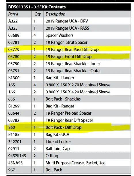

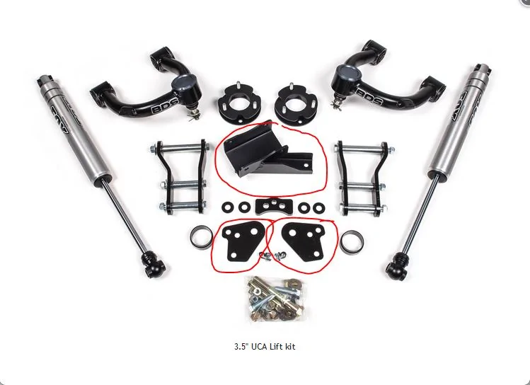

Doesn't the 3.5" BDS lift come with the parts to do the diff drop?
There are multiple kits. Basic lift only, UCA kit, coilover kit, etc.
