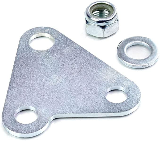

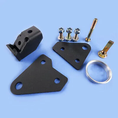

BDS diff drop (I think):
What I have (possibly from Australia?):

Hi John,
If your diff drop is from BDS, I strongly recommend you avoid this back yard "engineered" piece...It is non robust in my opinion...and cutting the frame support off means you now own the frame as warranty will not cover this "mod".
My opinion, and I am sticking to it....
best,
So does my addition of BDS upper control arms that keep the ball joints in a neutral position do the same thing as a dif drop?

Hi Mike,
Hi Mike....not for the poor front driveshaft or the front axle CV joint angles. It allows for factory spec adjustments which can be difficult. I will say that I saw the BDS upper arms and they "looked" good, but to see other "junk"....Maybe the UCAs are an isolated good add. By the way, the upper control arm has an easy life in the suspension compared to the lower control arm...
