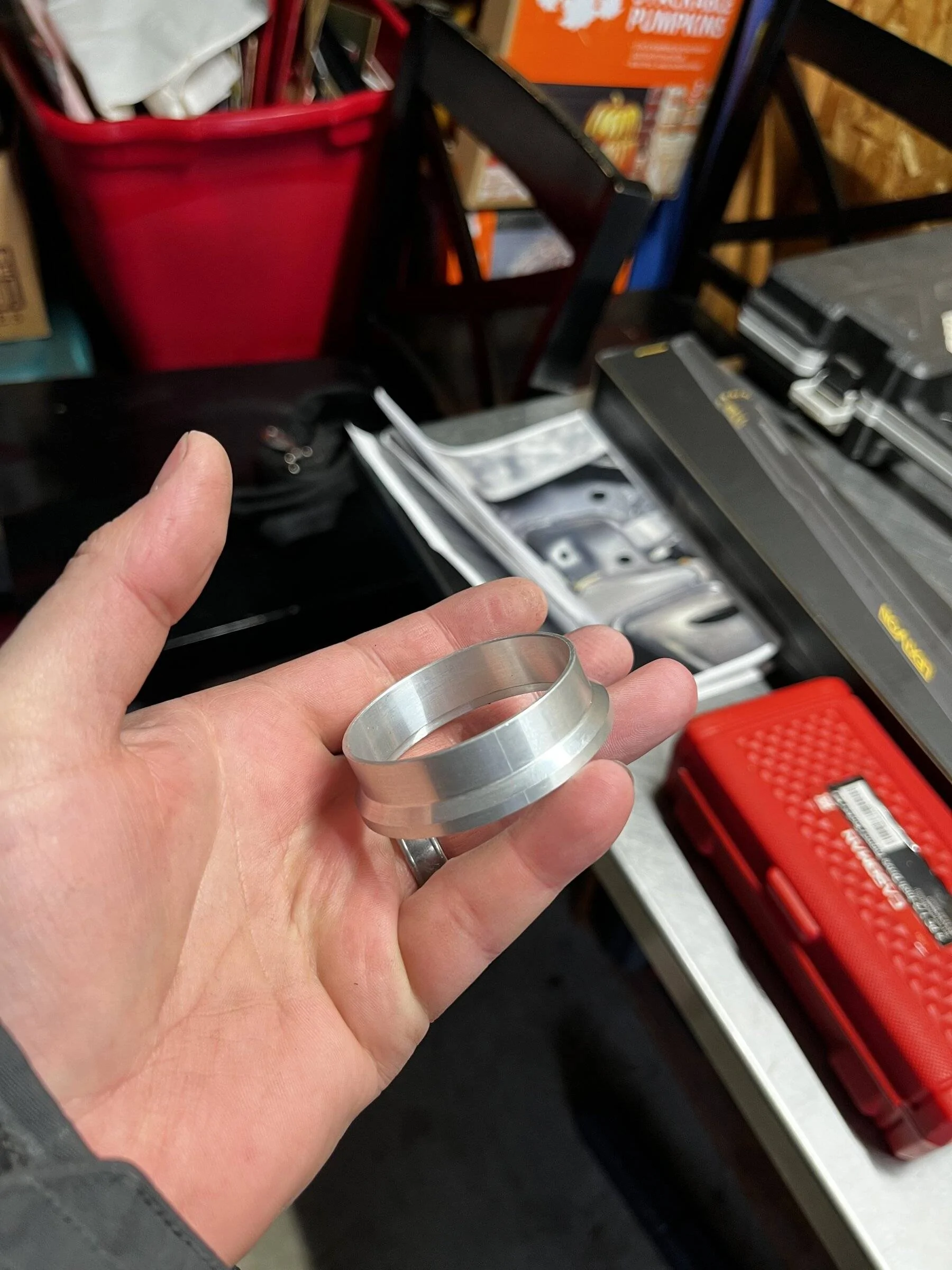

If you figure out what this ring is for lmk. It was not covered in the instructions

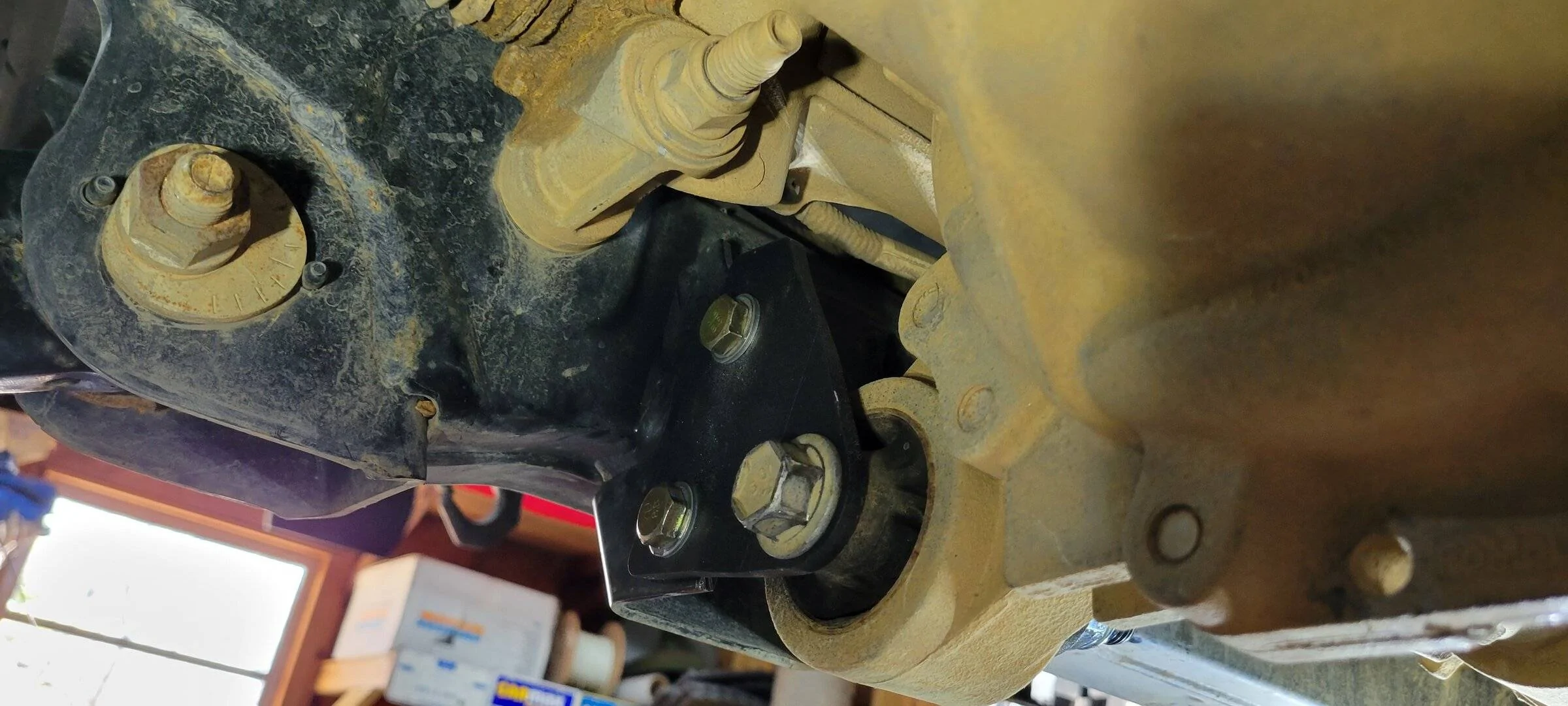

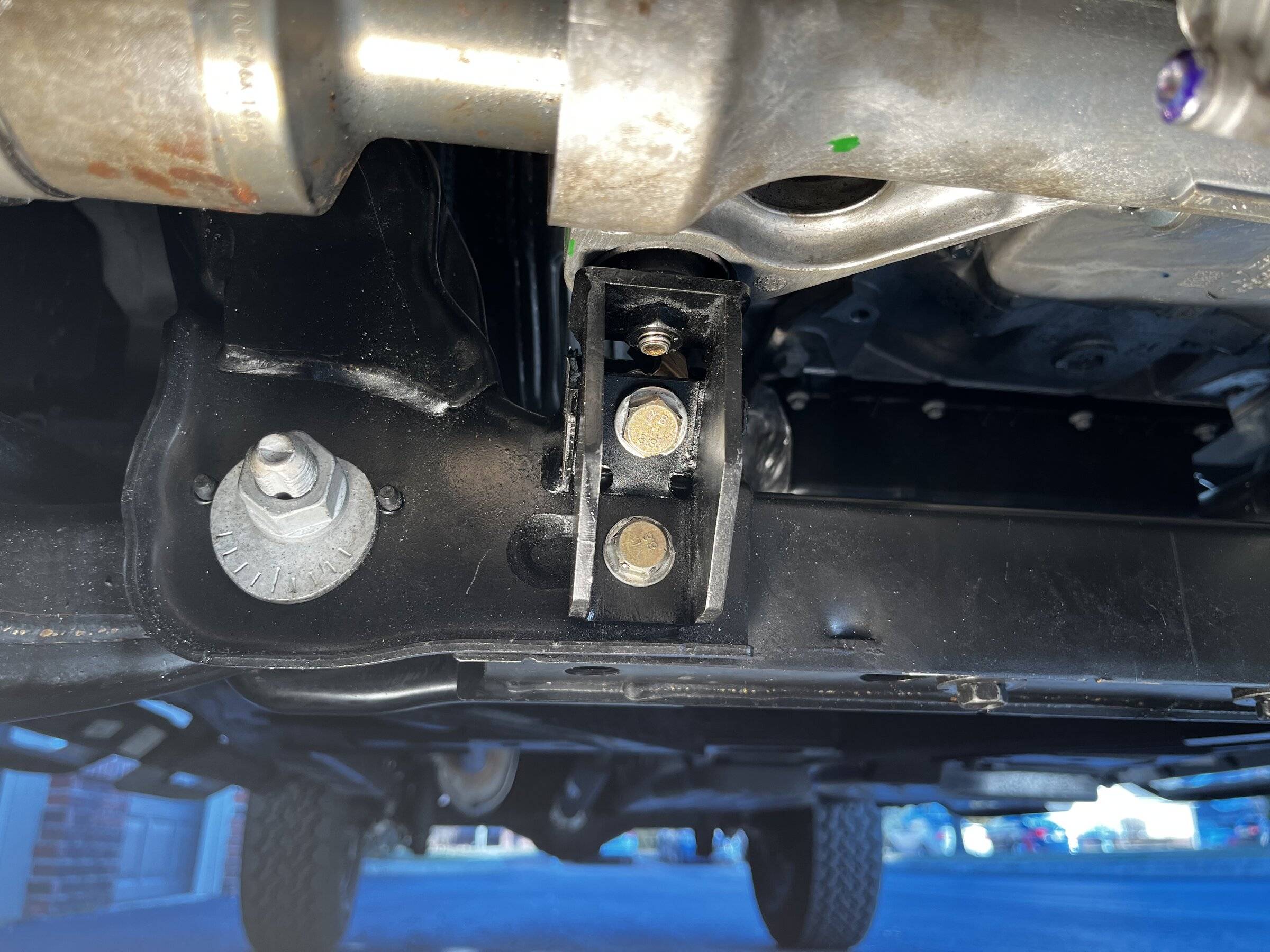

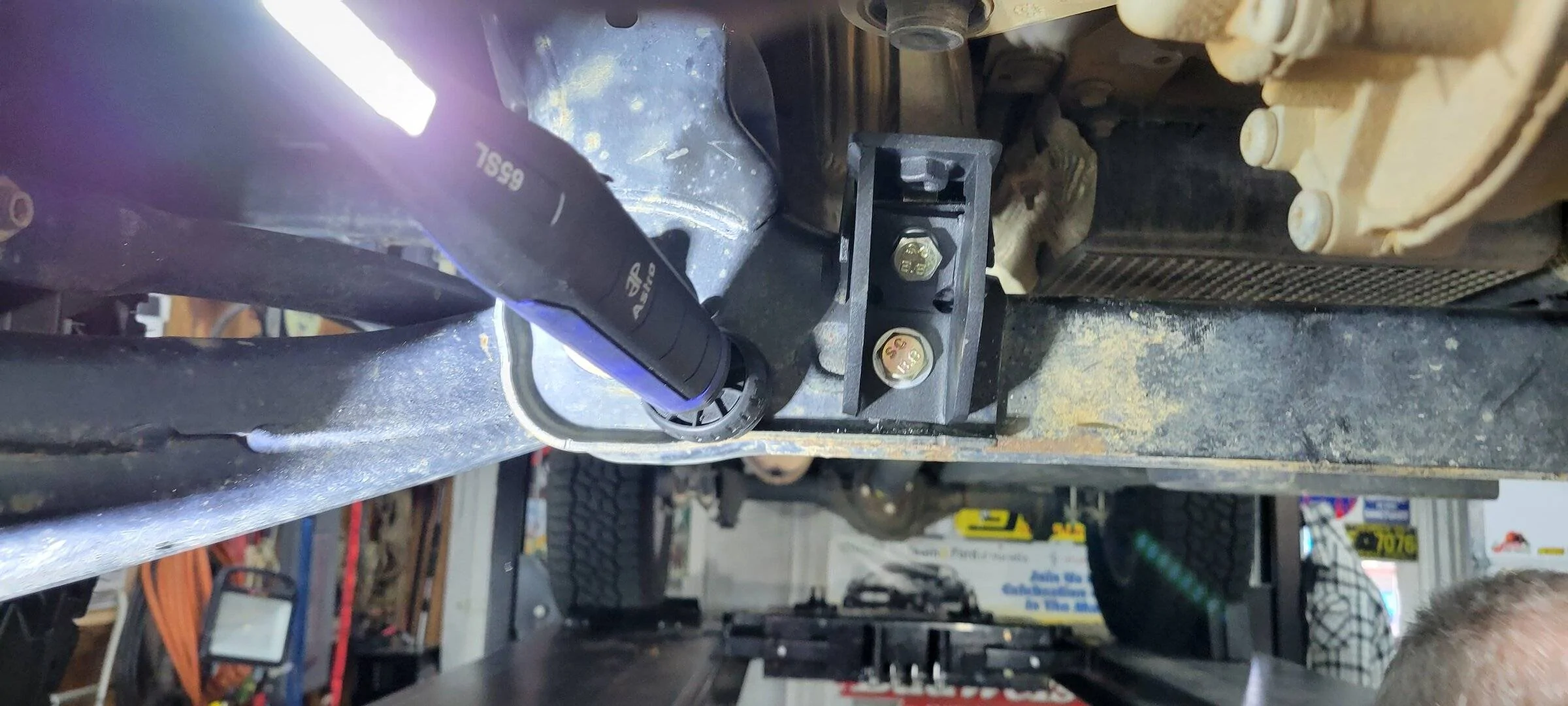

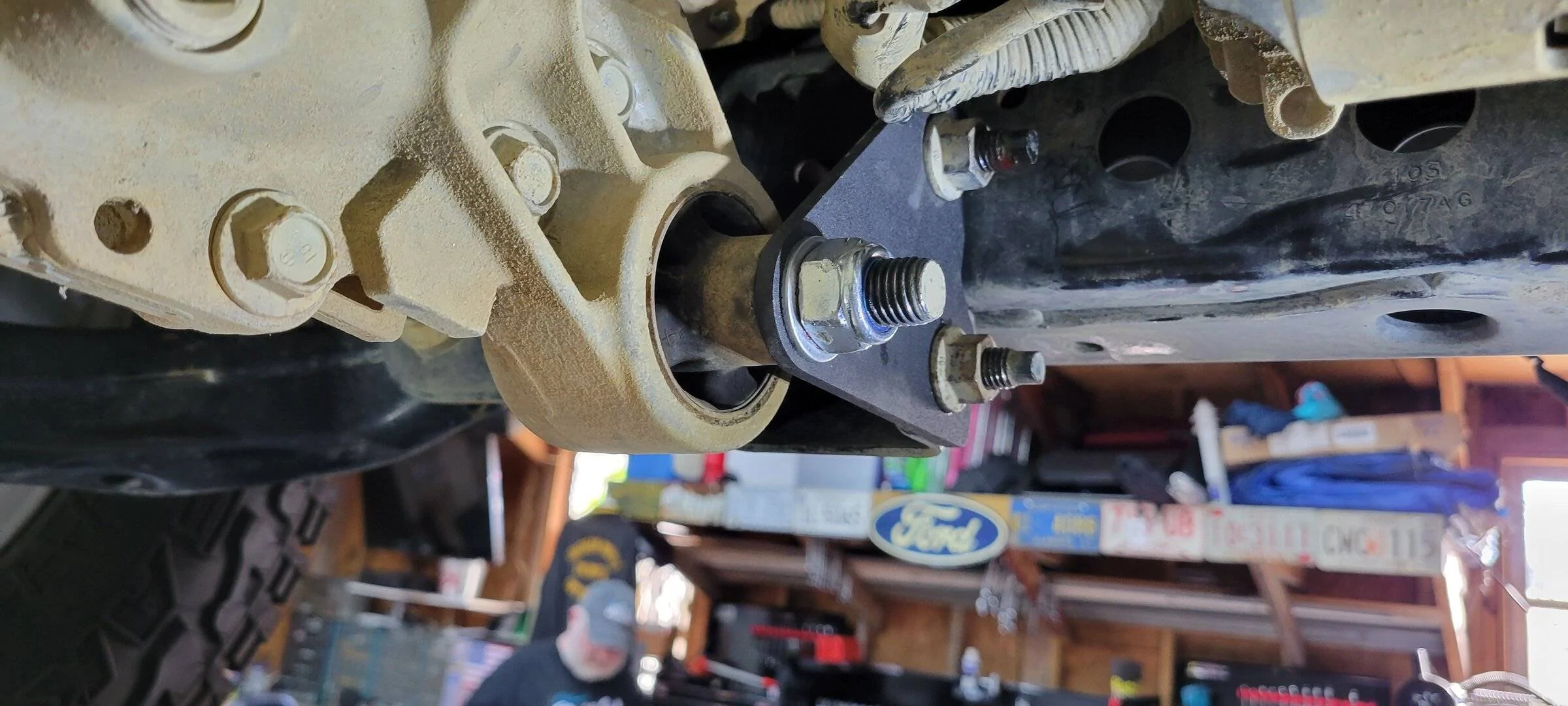

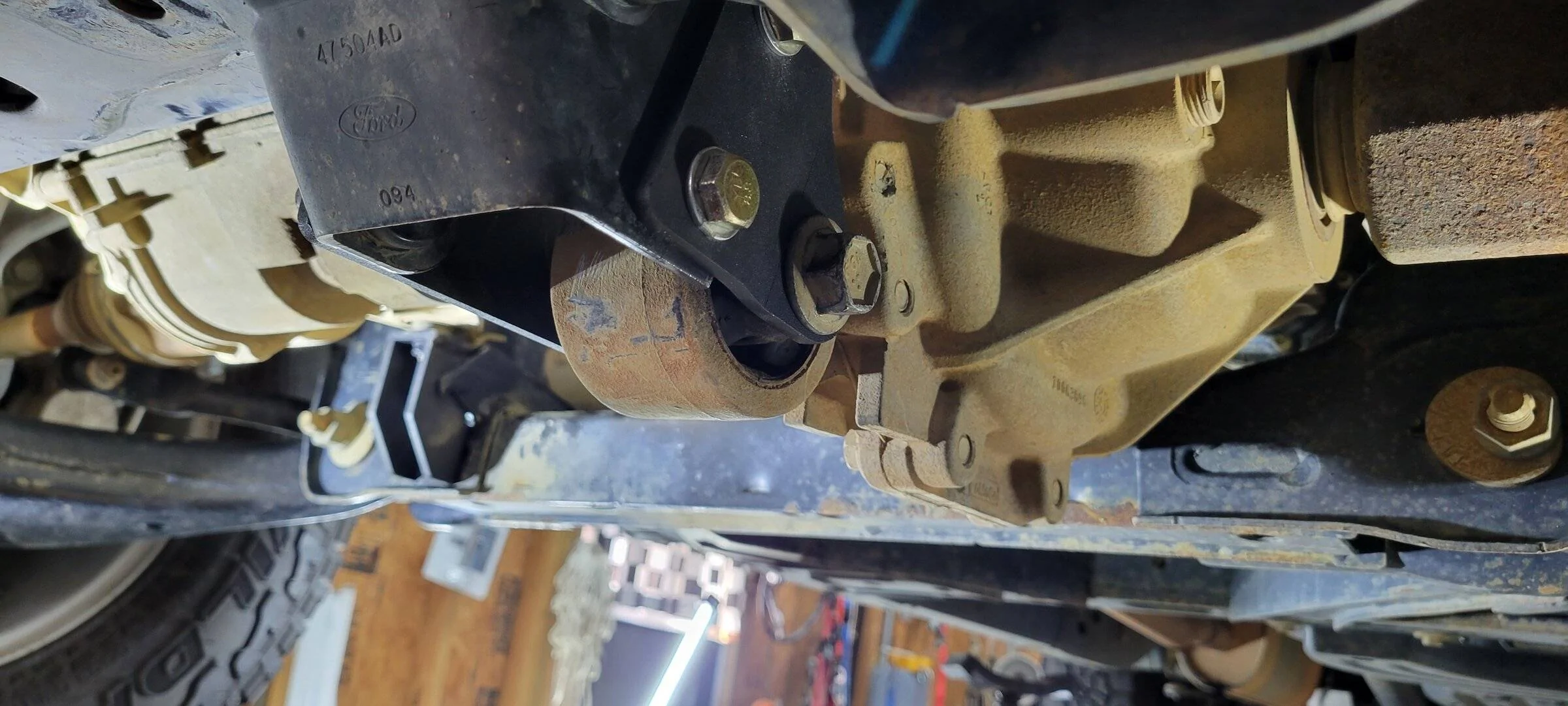

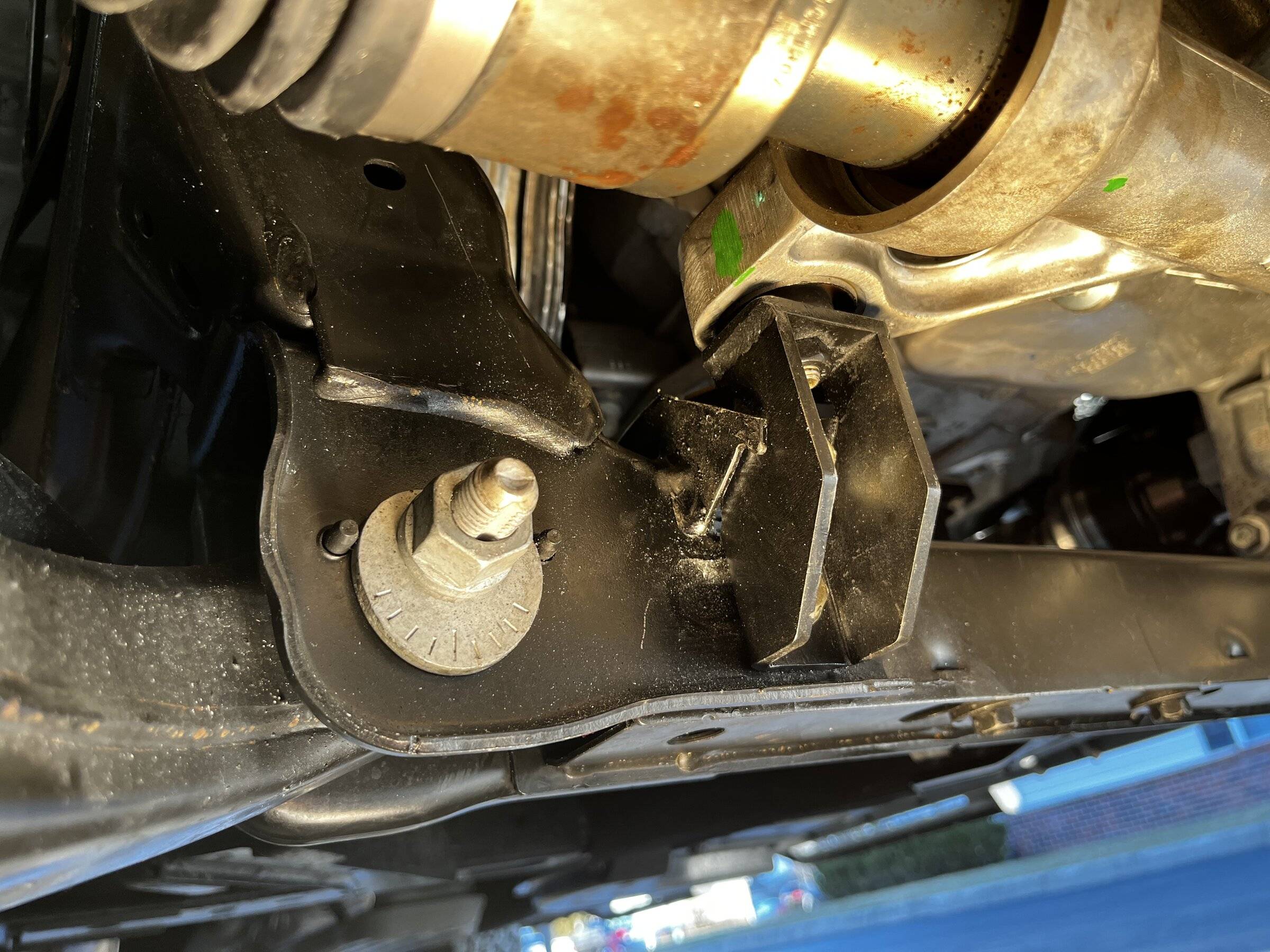

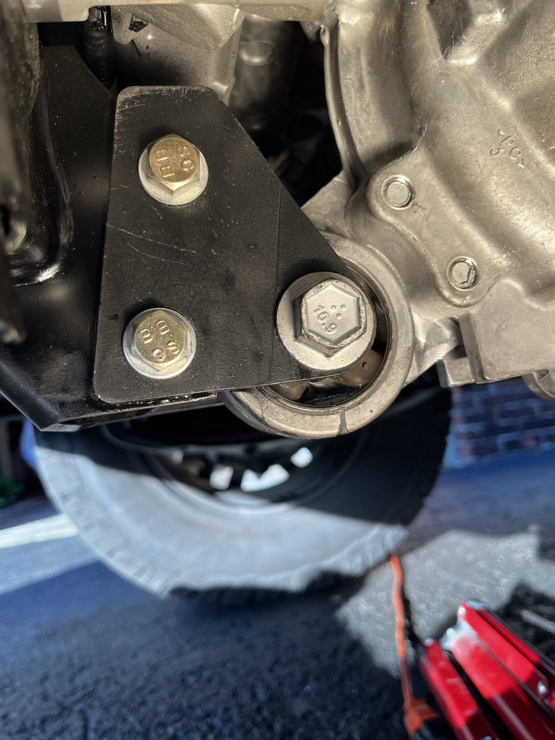

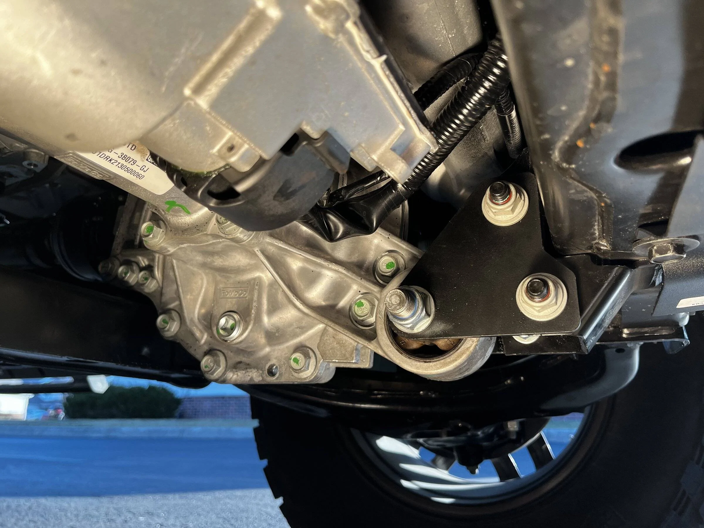

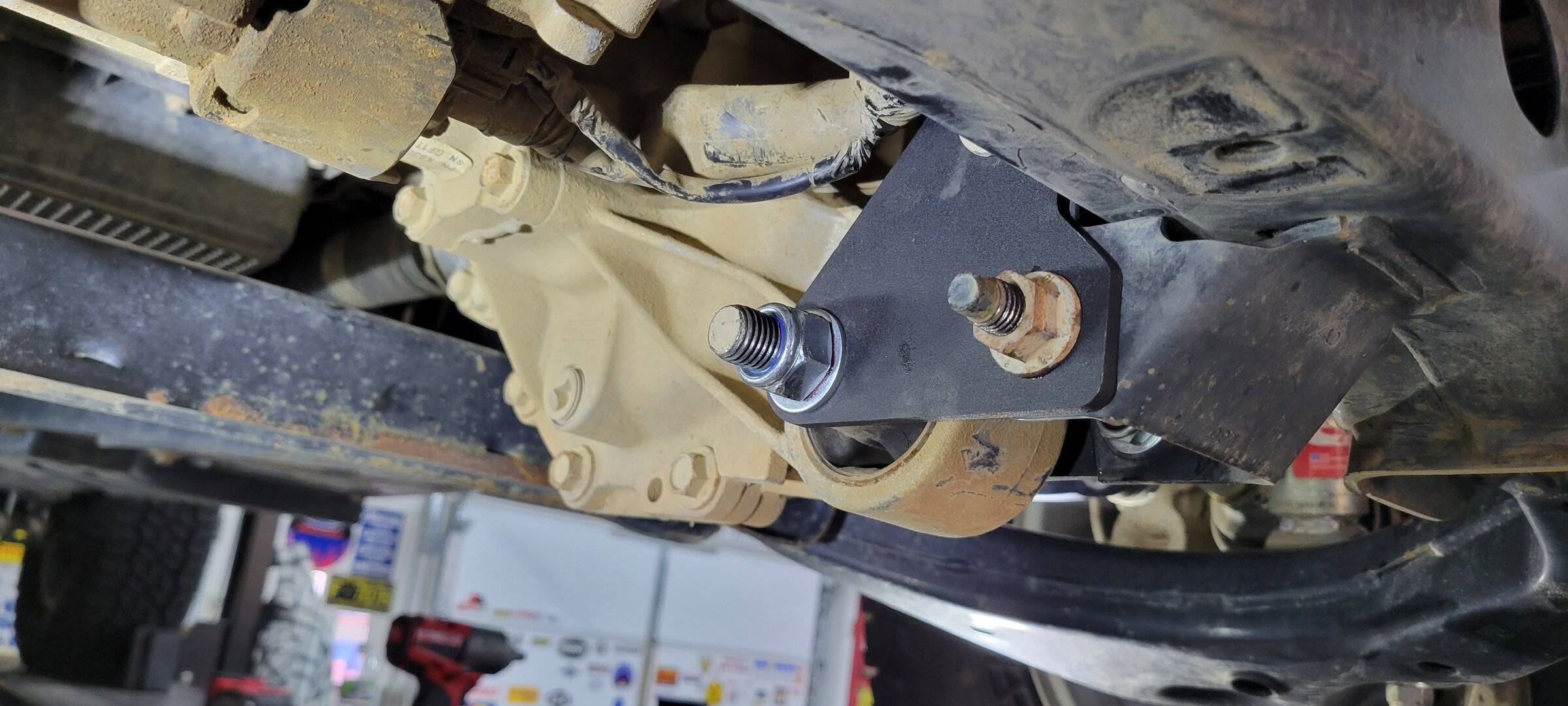

It went longer than I expected. The passenger side went really easy. The template for the driver side didn't match up at all! So we did a part of the driver side (driver side inner bracket first), and then used the driver side outer bracket to determine where to drill the holes. Everything looks good and I haven't had any weird issues/noises/etc. out of the truck. I didn't determine what the aluminum ring is for either. LOL
I have to say, it was great doing it on a lift with a transmission jack/support. I think it saved our back!
I did the same thing. Cut about where I thought I needed too, bolted up the inside bracket and slid the bolt through backwards towards the driver side to go into the new bracket. Once I got the bottom hole drilled I slid a bolt in and drilled a pilot hole for the top hole and then removed the bracket to finish.

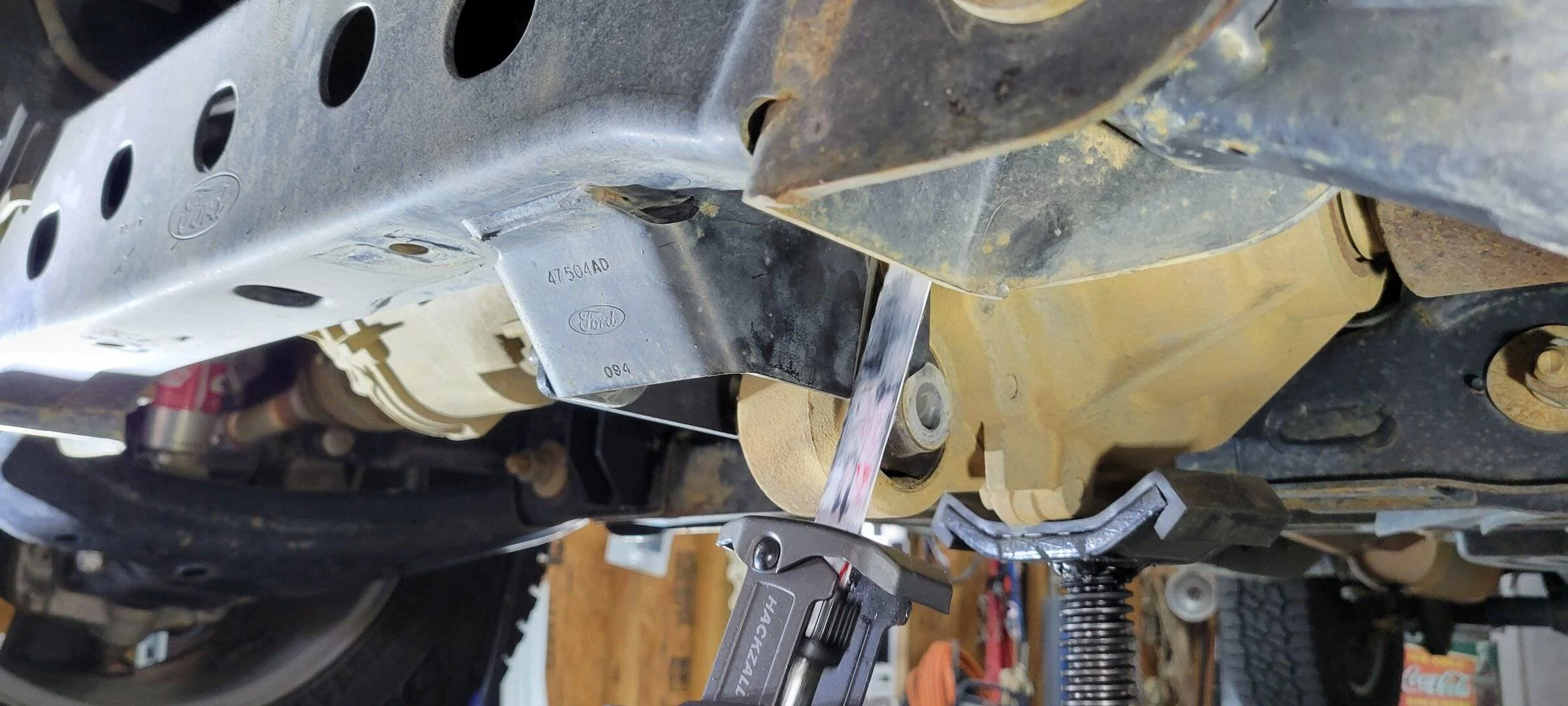

Learn something new everyday. All this time I thought all the posts referred to the rear differential. Actually just looked on BDS website and searched for a differential drop kit and the only thing that populated was for a Dodge truck. I am with Phil, I won't be cutting on anything including the frame, if I do this I want plug and play.
I have the 3.5" BDS kit on my Ranger. The diff drop is of heavier steel than the factory one. Plus location of factory drop would seem to block any mod. I cannot see how any diff drop would avoid cutting off the factory welded one. The BDS Drop comes w/ their lift n level kit. VERY happy with it. SUPER Stout. PITA to install.

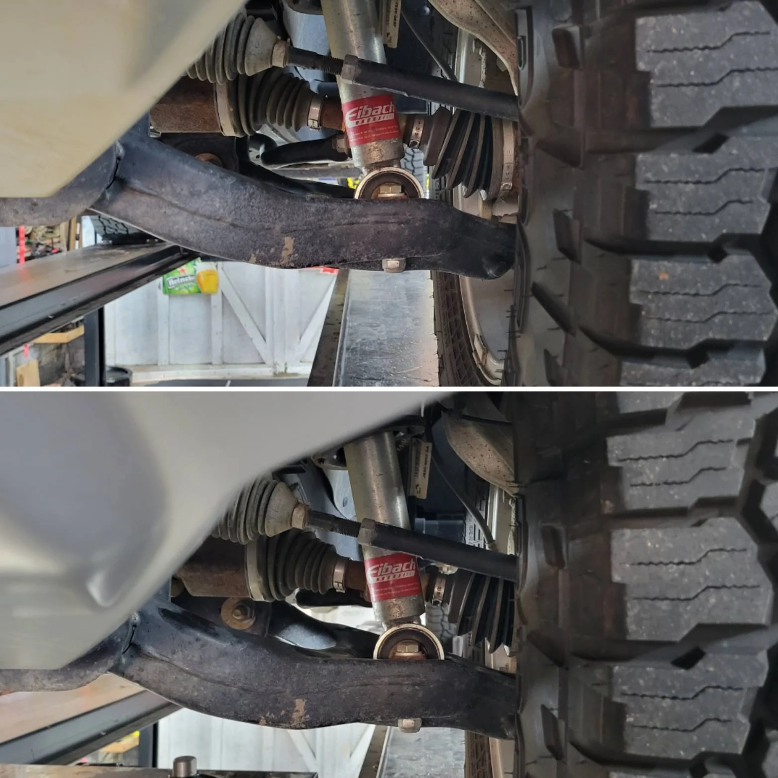

How much do you use your truck off road? Funny thing; being lifted in the 3.5" to 3.75" range, I had no problems off road. But three times, while turning left out of driveways on asphalt surfaces, I heard a little binding up front on the right side. That's what drove my desire to drop the diff., just in case. I've been out a bunch without any issues though.
I also retained the parts cut off, and they can be easily welded back in just a couple of minutes. :D
I think you will probably be fine with your desired level of lift with the 5100 shocks and struts.
