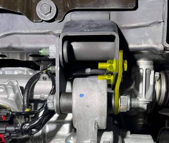

So I just finished installing the Peak Suspension diff drop. It replaces the oem bracket, and you have to drill a hole in the other side that drops from the frame. The install was easy, minus one gap in drill bit sizes not wanting to bite in the smaller hole drilled previously. Not the install fault, prob just a crap drill bit. I did not have a chance to get it up to highway speeds, only up to 50. I did not notice the vibrations I was having after installing the eibach 3" kit. I will see tomorrow what it feels like on my way to work. The kit glocker has contains a lot more things. Mine was just a replacement bracket. If this breaks, I guess I will find a more substantial one that requires more work. I have not been here long, but from what I can understand I bet Phil is probably nodding his head thinking "what fools." I accept this. If it breaks, I look at it like I am just supporting the economy by having to dumb more cash into it.
How has this held up? I found the instructions for the kit you installed here. The only thing that worries me over what OP shows is that the Peak Suspension kit only has one bracket for the passenger side and the hole drilled on the drive side is close to the edge. If there were two brackets like the ebay kit I think it would be a much better design.

I contacted the seller on Ebay and got a Link to the instructions. This kit is more involved but looks like it is heavy duty. Not sure why this kit includes the "passenger side diff mount" drop bracket relocation and the Peak Performance kit is just for the drivers side?
So far no issues. It's mostly been on the road, dirt a few times but nothing too crazy. Off work then rest of the year, I'll pop my gead down there and see if there is anything to note.
