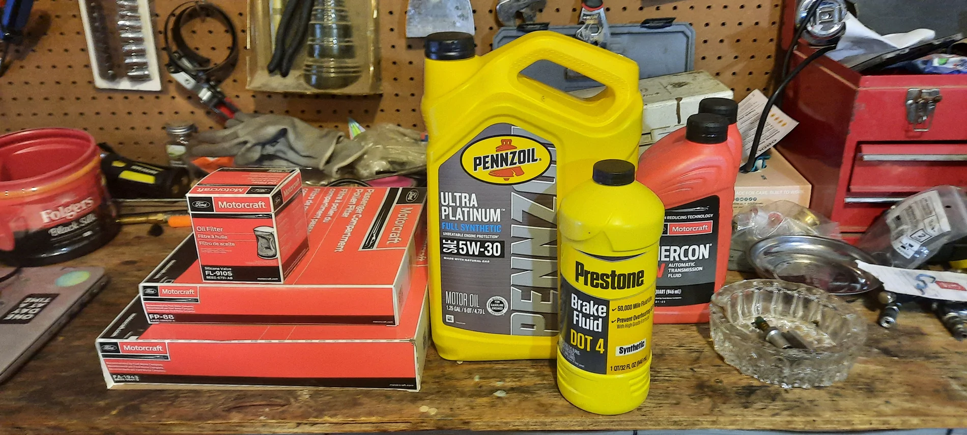

Hit 60 last weekend and decided to geter done

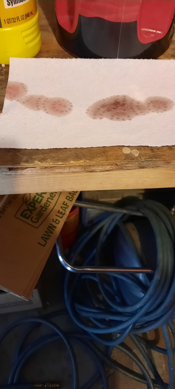

Had the Transmission fluid changed at the dealer, so no idea how the fluid looked. Cost for me was $263.00. Beside the normal oil and filter change I changed:
both air filters
transfer case fluid
flushed brake lines and inspected pads
hooked up scanner for health check
Man I'm getting old when this kind of work has me wasted at the completion.

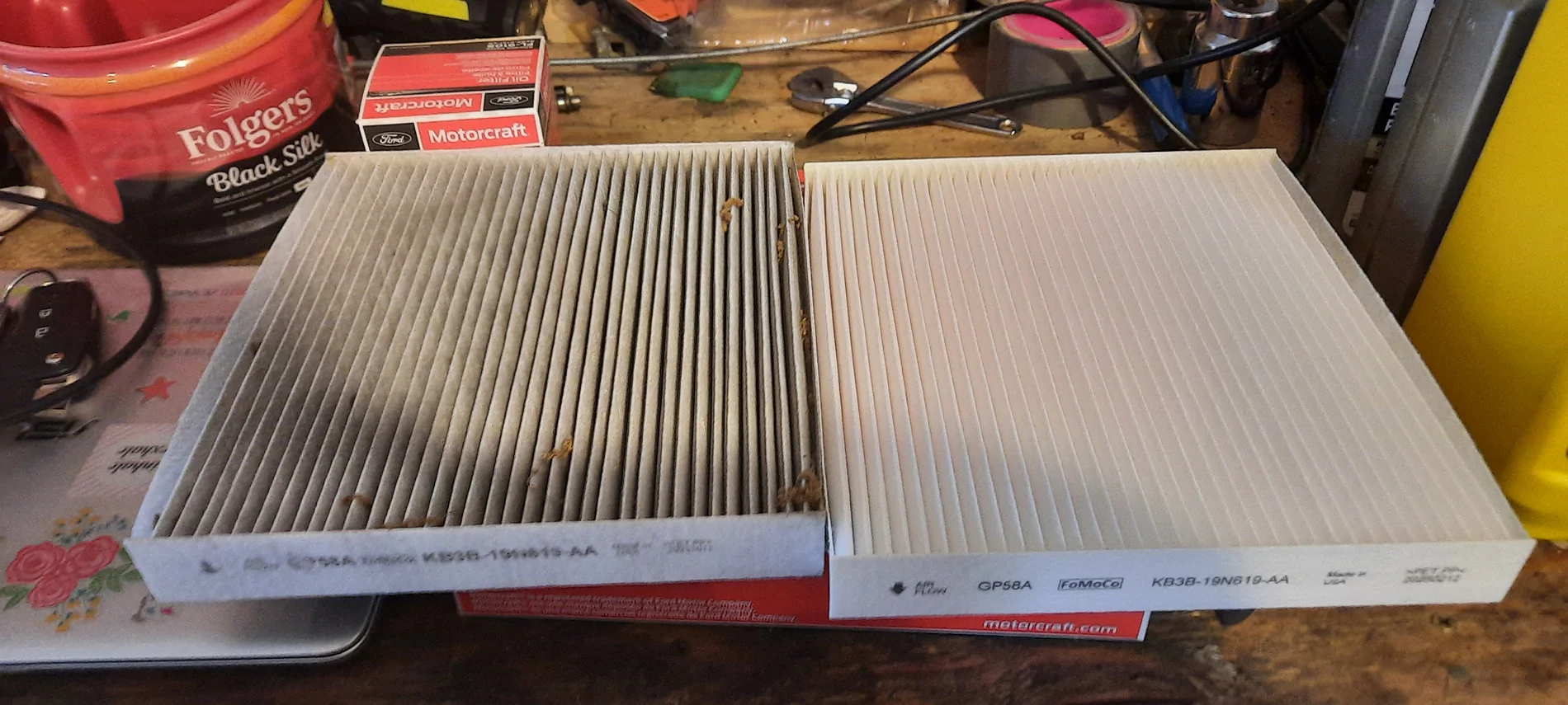

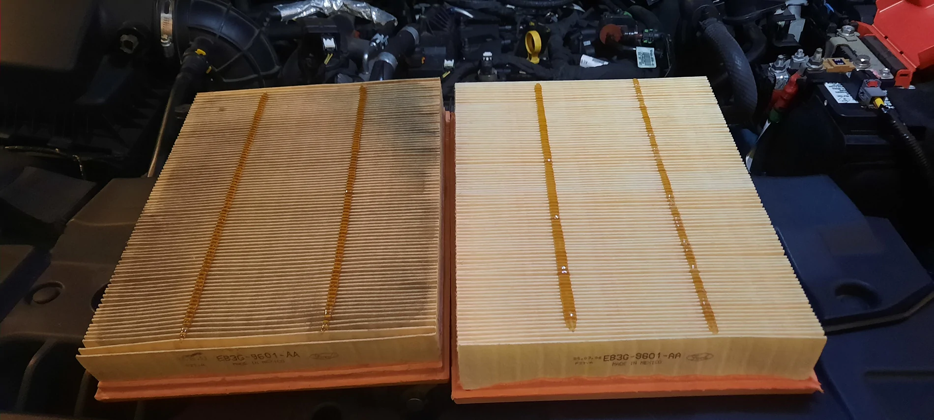

Air Filters look about what I expected for 30k of use.

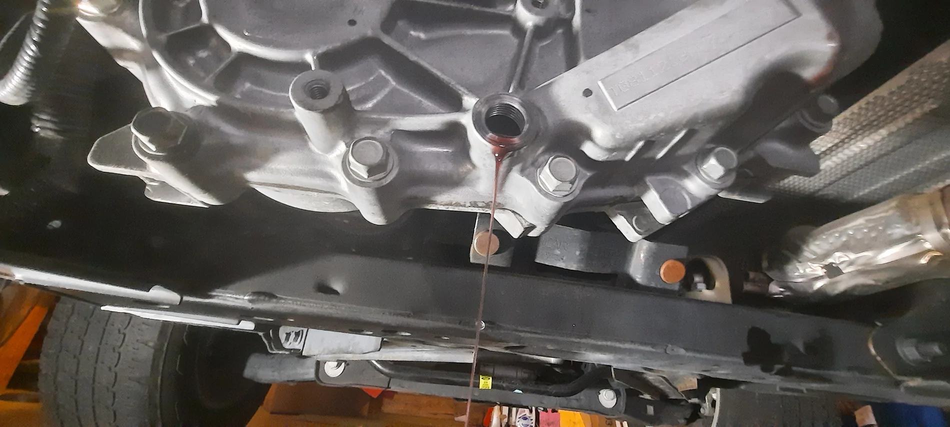

I changed the transfer case fluid at 35k and the factory fill was pretty dark, so I decided to change it with 25k on the fluid. Looks a lot better than the first change. I'll probably start changing at every 30k

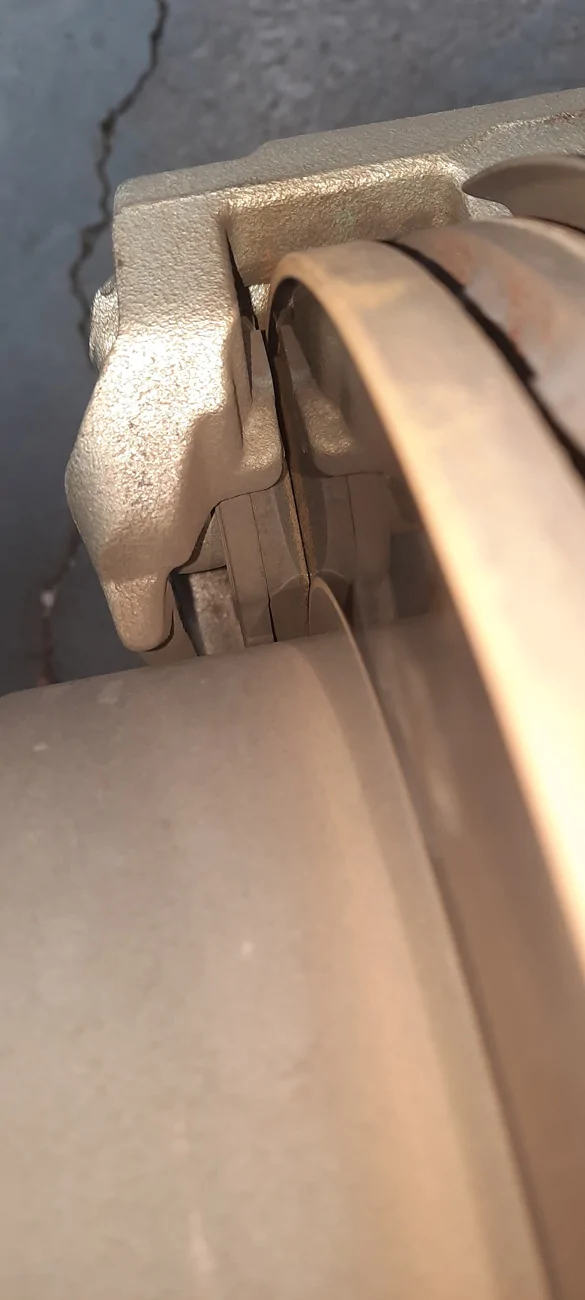

For 60k on the brakes they seem to be holding up pretty well should be able to get another 20k out of the back and maybe more out of the front.
Back right outer pad.
All the rear pads have about the same amount left.
The fronts look to have more pad left than the rear, so I'm pleased with how the brakes are wearing so far.

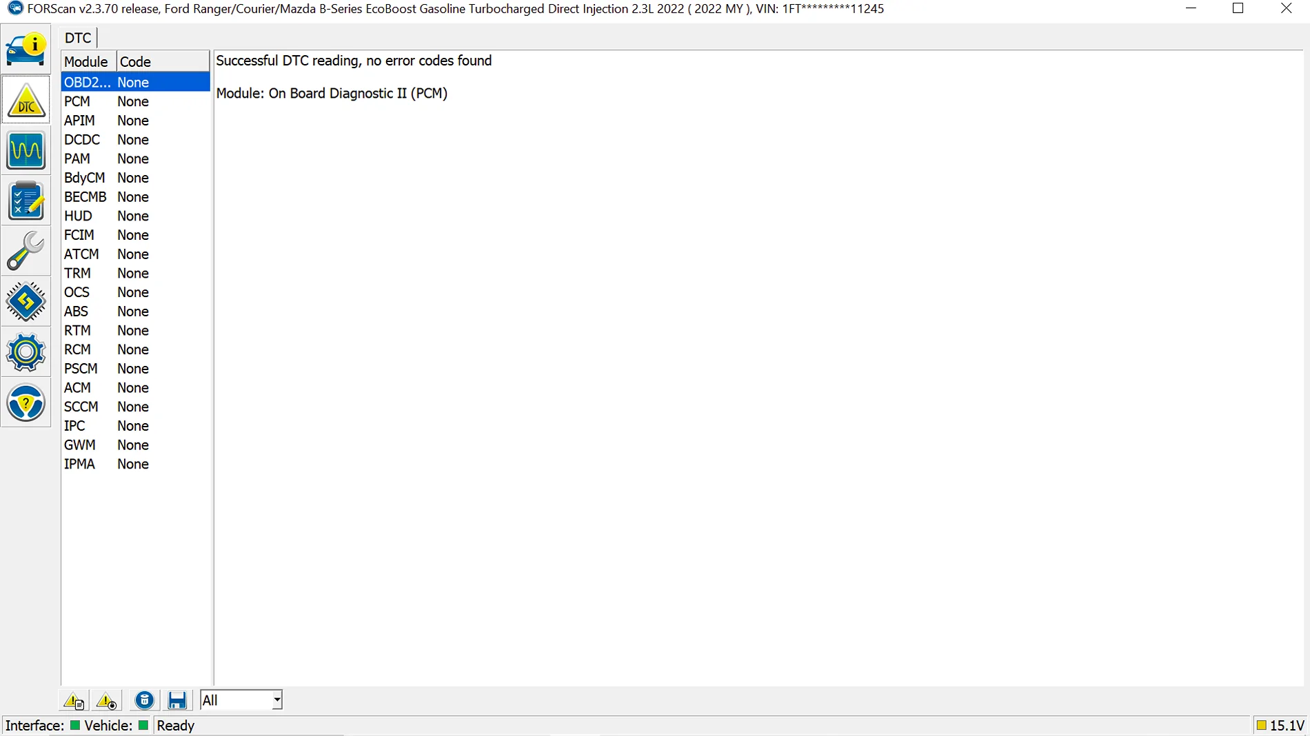

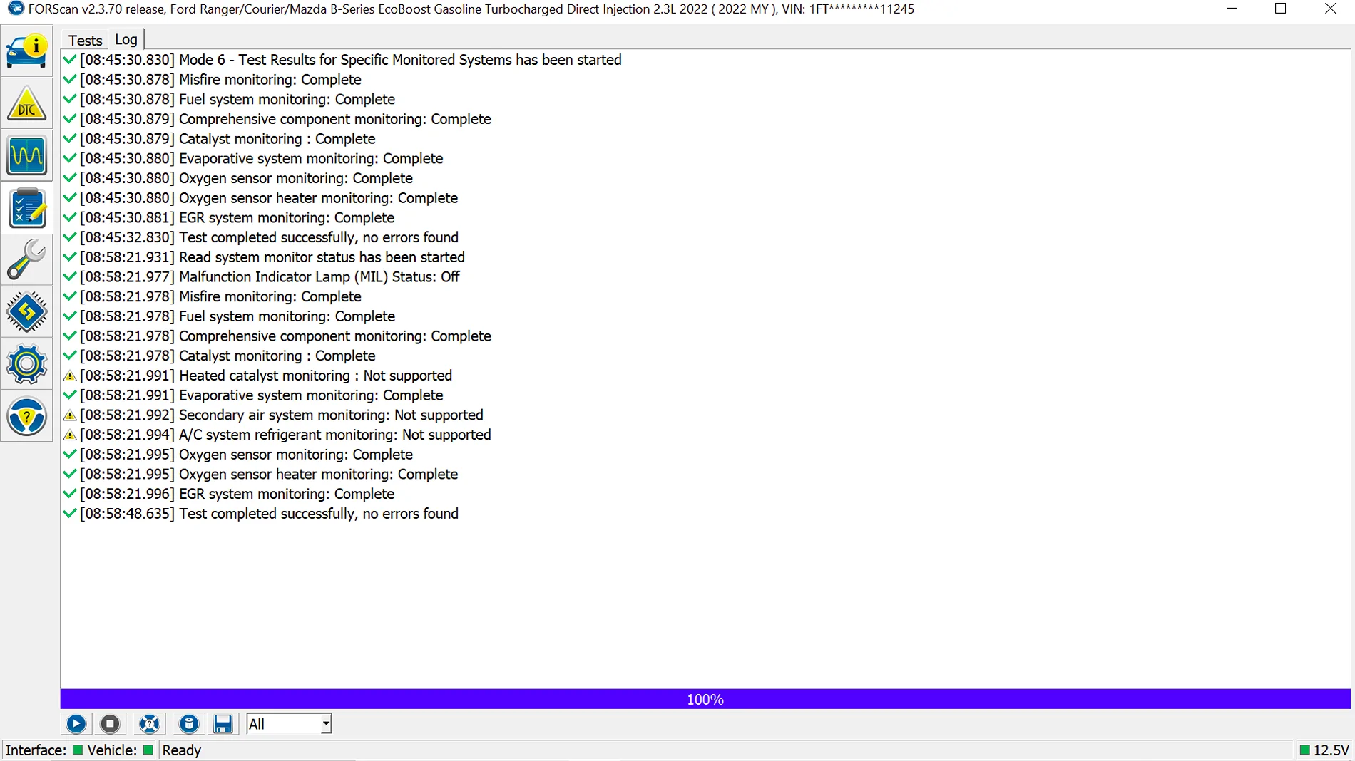

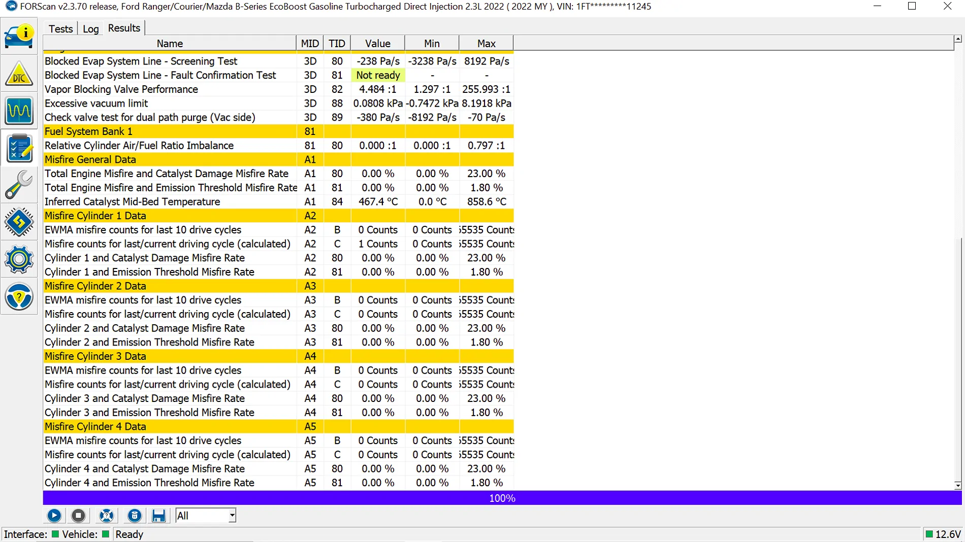

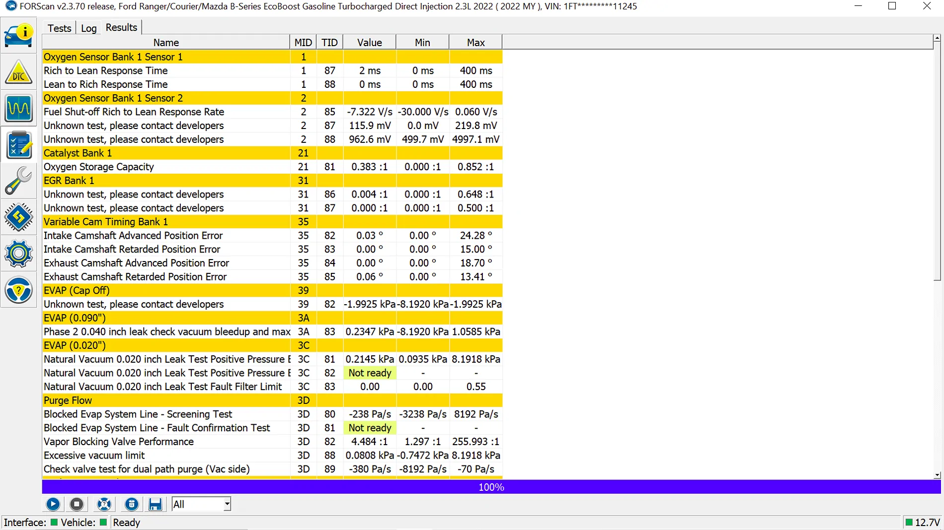

Last thing I did was a health check with the scanner
Checked long and short term fuel trims. Short term was fluctuating around 0% and long term was +7%. Long term could be up do to new air filter? If I think about it I'll check it in a week or two. Nothing to get twisted over.

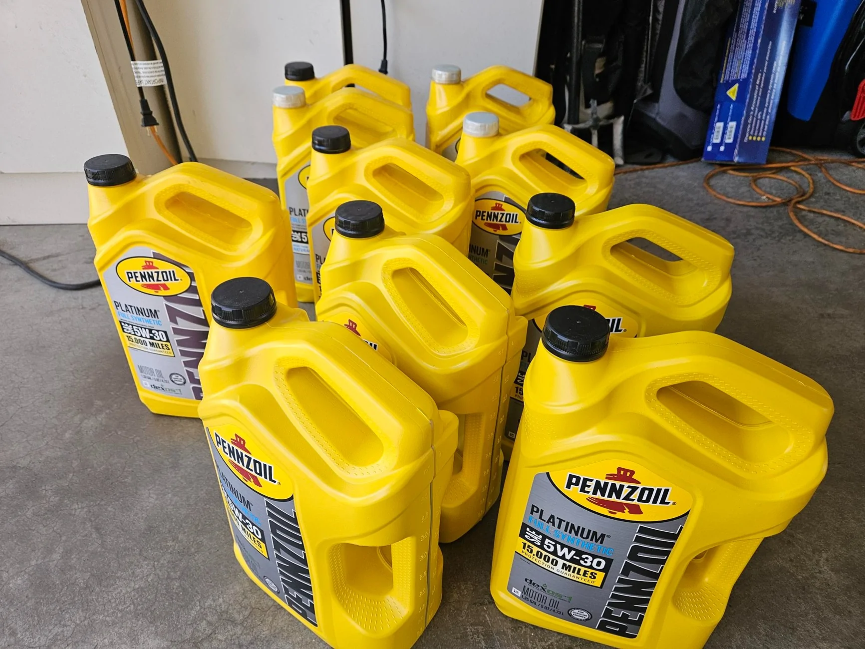

Didn't realize at the time I bought my oil but Pennzoil is no longer making their oil from natural gas plus lost the Dexos rating. Don't know if I'm going to stay with this brand or switch back to Mobil 1.
I am going to stay with Penzoil for a while for 3 reasons.
1). It says 15000 mile protection and I change it every 5000 miles
2). It is probably still as good as most at that price range
3).
I've switched from Pennzoil to Valvoline Restore and Protect 5w30. My hope is that it keeps the turbo screens and other build up ail clean. I'll let you know how it works out, but reviews have been very positive. Here's a video from The Motor OIl Geek
I thought about Valvoline R&P after watching the tare down of the 3.2 l a couple of years ago. I'll stick with Pennzoil for now. I change it every 5k like dozxab does, so should be fine.

Update:
Had to help a friend with a misfire on a 03 F150, so I decided to check my fuel trims on the drive over to his house to see if they adjusted to the new air filter. And the answer is yes, long and short trims are pretty much just fluctuate at the 0 mark now.:like:
