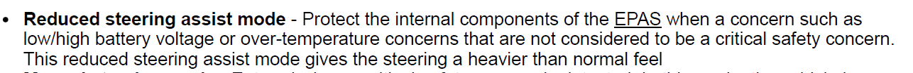

I know you're likely speaking in your angry voice, which sadly leaves the gaps of information people on here need to help you.
Perhaps gather your thoughts and write a new clear concise post stating where you are at, without the emotions. Are you getting dash lights? which ones? are you getting the infotainment warnings? which ones and in which order? If you have ford pass, which ones are being sent to it? Tell us exactly what happens and when without all the fluff.
I'm going to stick with the crowd that you have a wire issue, or low voltage issue.
With your reference to your steering problem, this is in the service manual, and it points to voltage issues. You only said the tech disconnected the battery, which will clear codes. You didnt answer definitively that he checked the battery state.

Crazy thing is the truck runs and drives fine. I do notice the steering is tight for a minute or 2 when I first drive.
