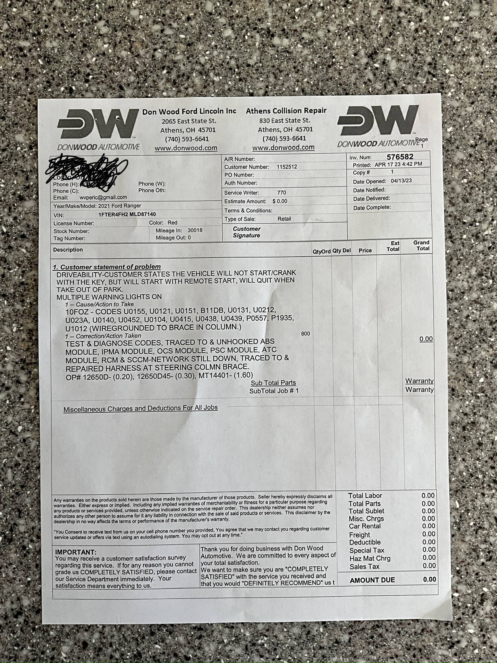

Picked the truck up last evening (Monday)
Ready for this..................
A loose, bare, broken wire in the steering column, per the lead tech/ mechanic, (what are they actually called now anyway?)
Service manager took a picture and the wire harness is covered in a foam wrap and there was a depressed spot that had a hole rubbed in it . You could see the wire was rubbed bare and must have been touching something. Also it had come loose from adjusting the steering wheel when I get in to drive and get out of the truck. Basically and up and down motion.
Manager said they had to push it in the garage, and it was spinning codes when they key fob started it and as I mentioned died when they turned the key to run and shifted into a gear.
Just like I told them.
Made a few stops on the way home and turned the engine on and off 3 or 4 times and no codes.
So maybe its fixed? Who knows?
Keep you all posted!

Didn't get a picture.
I'll post up a copy of the paperwork.
Only pictures shown were the before repairs
Wires are wrapped in foam padding. And it was clear the wrap was compressed against something in the column. And the then the up and down motion of adjusting the column caused a tear in the foam pad/wrap.

Repair Order

Well at least they finally found something, so let's hope it is the final fix.
Airline wasn't far off, as he suspected something with the ignition or PATS, which are both in
the steering column. If I was closer to KS, I'd buy him a beer, or coffee.
