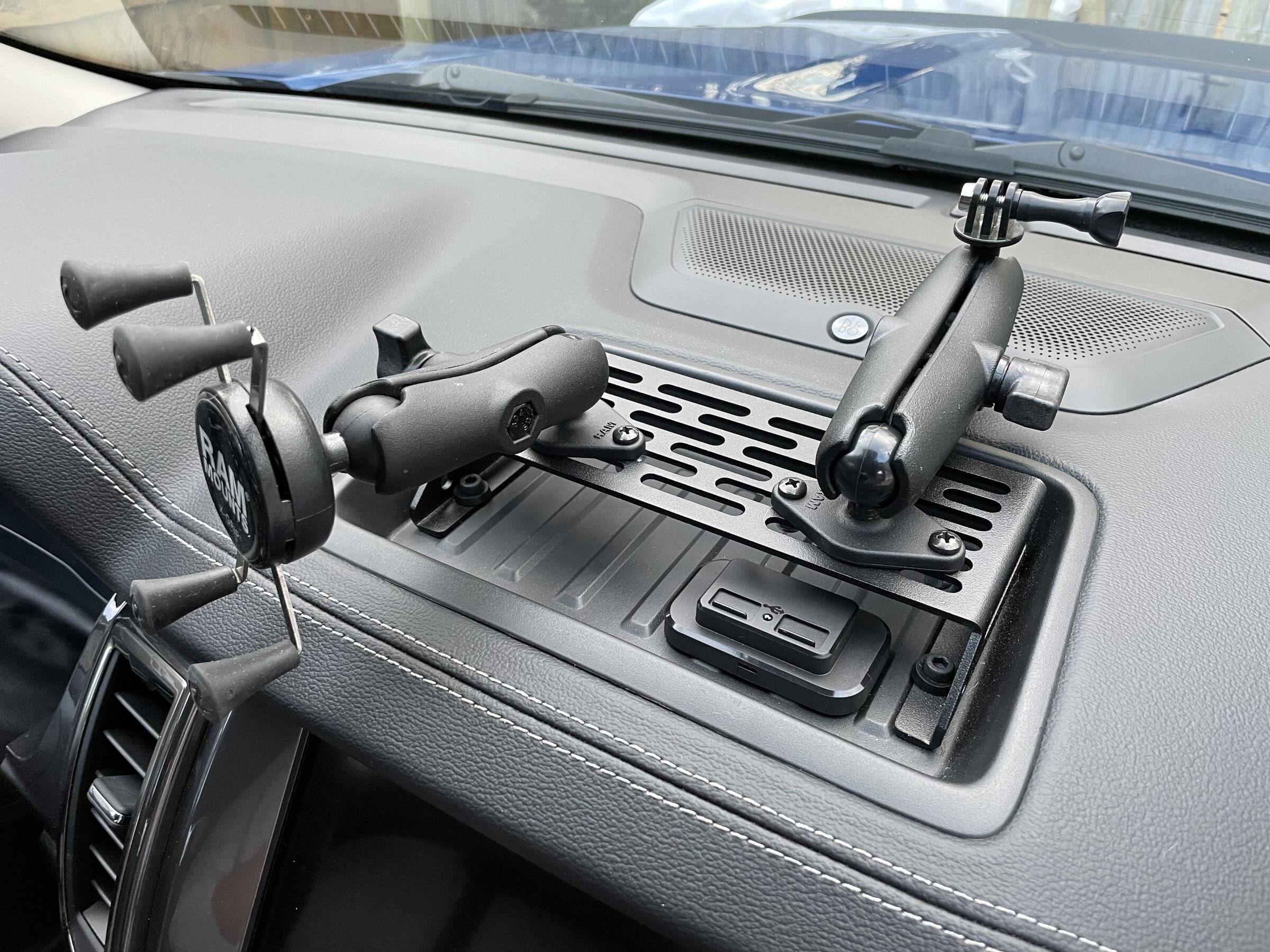

My somewhat elegant solution to the dash tray power conundrum:
(still some room left on the tray for a wallet, etc)

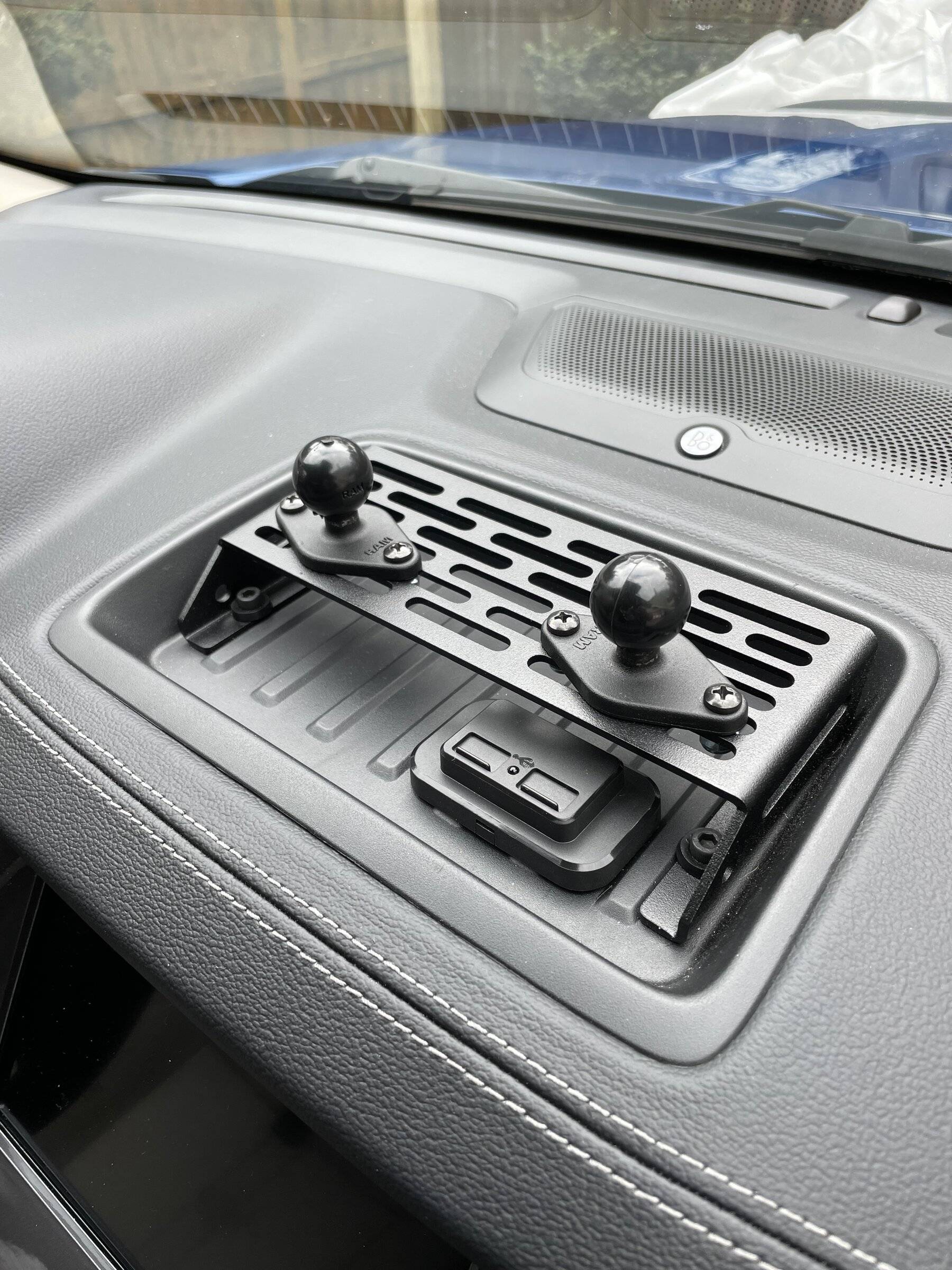

Dash tray insert rack (with modified hardware and more secure mount designed and implemented by myself):
https://builtrightind.com/products/builtright-industries-dash-mount-2019-ford-ranger
Dual USB outlet (I blacked out the annoying blue LED “power indicator):
https://www.amazon.com/gp/product/B091CZ25TR/ref=ppx_yo_dt_b_search_asin_title?ie=UTF8&psc=1
I powered the USB ports with a fuse tap (5A) off of fuse 35 (spare, and switched despite what some fuse charts say). Fuse 37 seems to be a good option as well.
I powered the USB ports with a fuse tap (5A) off of fuse 35 (spare, and unswitched despite what some fuse charts say). Fuse 37 seems to be a good options as well.

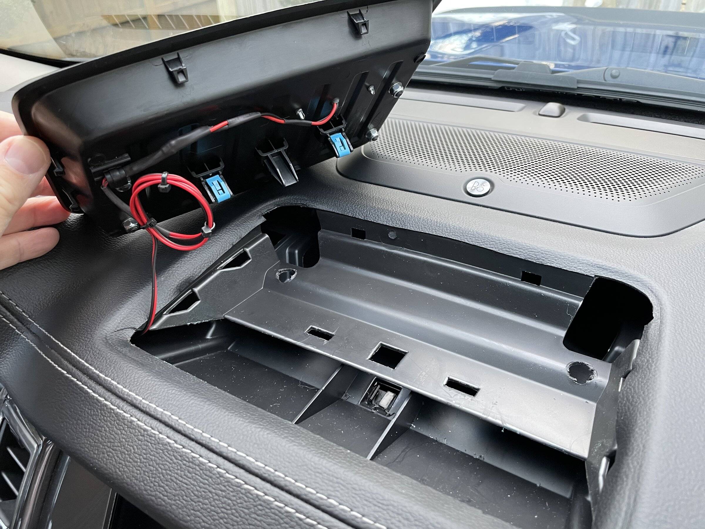

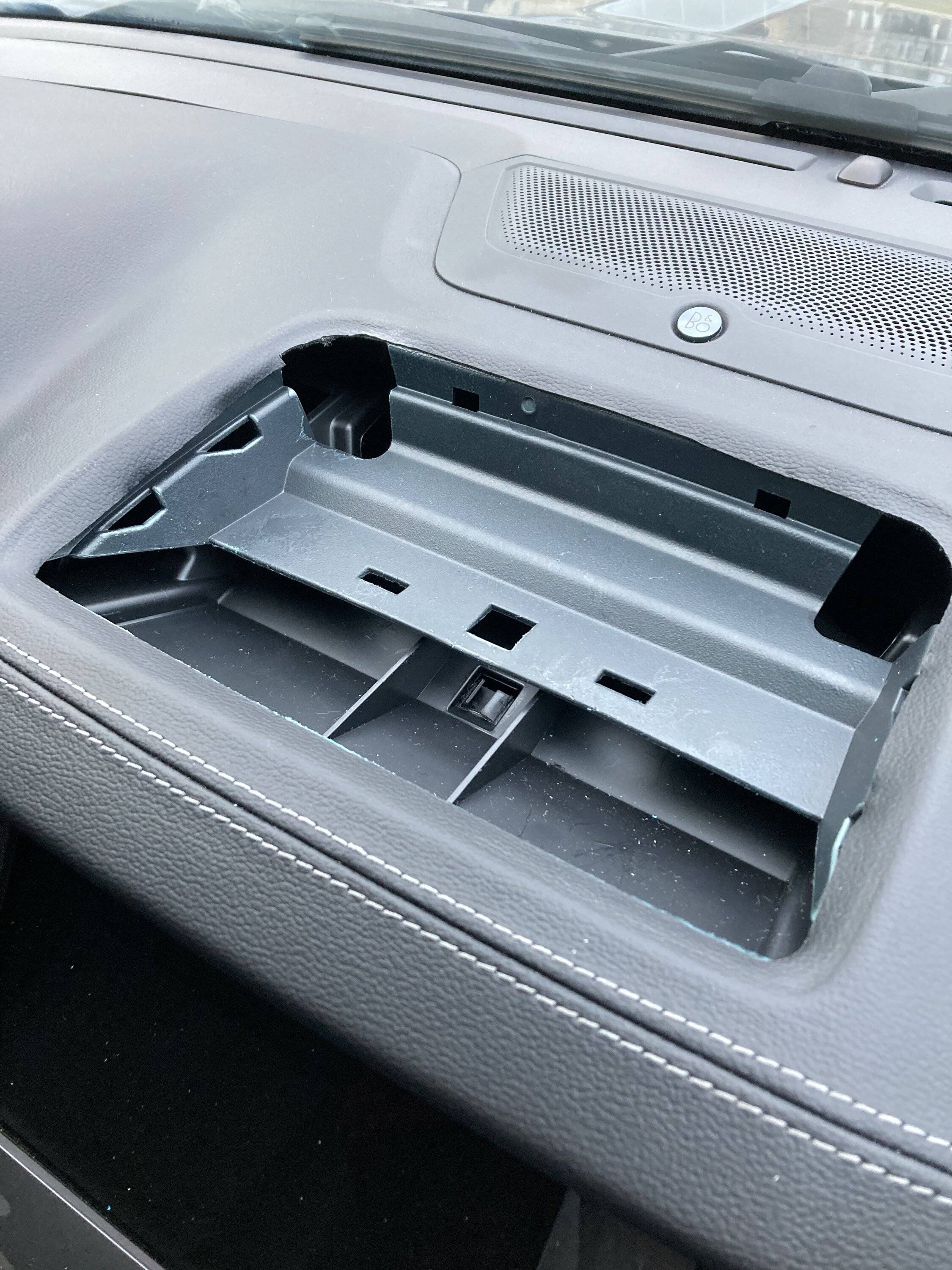

A little follow up:
Wiring shot (notice that I drilled two holes in the substructure of the dash to accommodate the rear hardware of the dash tray. There’s not a lot of clearance there.)
And a shot of the tray rack with various Ram mount hardware (in this case a phone mount and a GoPro adapter).
The whole USB in the tray idea came from the need to remove the battery from the GoPro equation during long trail time-lapse videos.

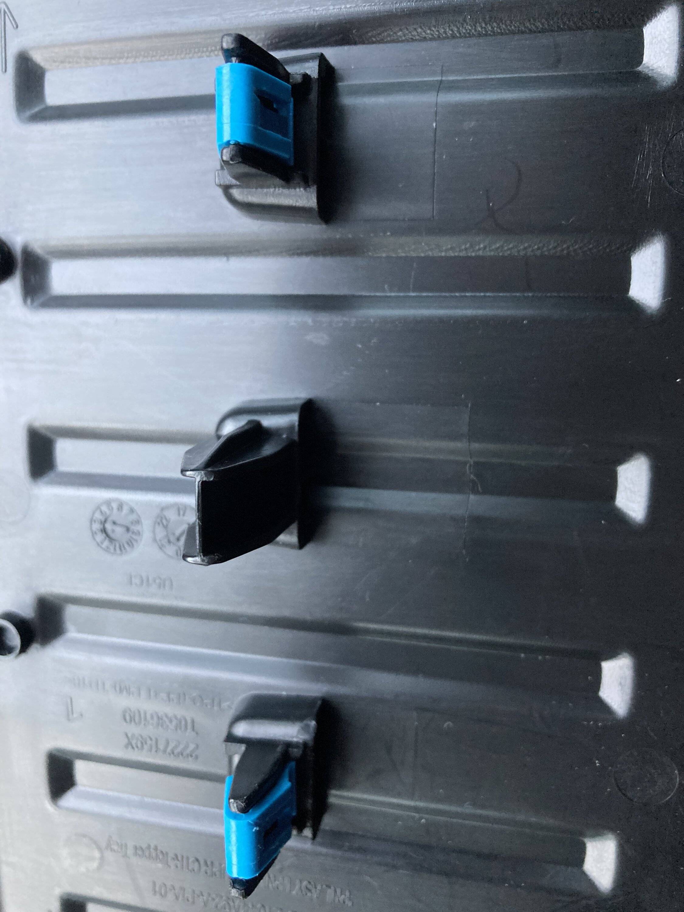

The blue clips are not popping out for me… argh!
Got it by breaking one off. Yay!
Looks like the blue clip will stay on but the black piece under it is cracked. Blue clip went back on nicely enough that I don’t want to take it off again for picture.

You should repair the black plastic ears of the tray before replacing the blue clips.

That tray, with clips is cheap. Easy to get a new one too, if you want to go that route.
Yes, they are around $15 including the blue clips. I bought one myself. Gluing the black ears is even cheaper.
