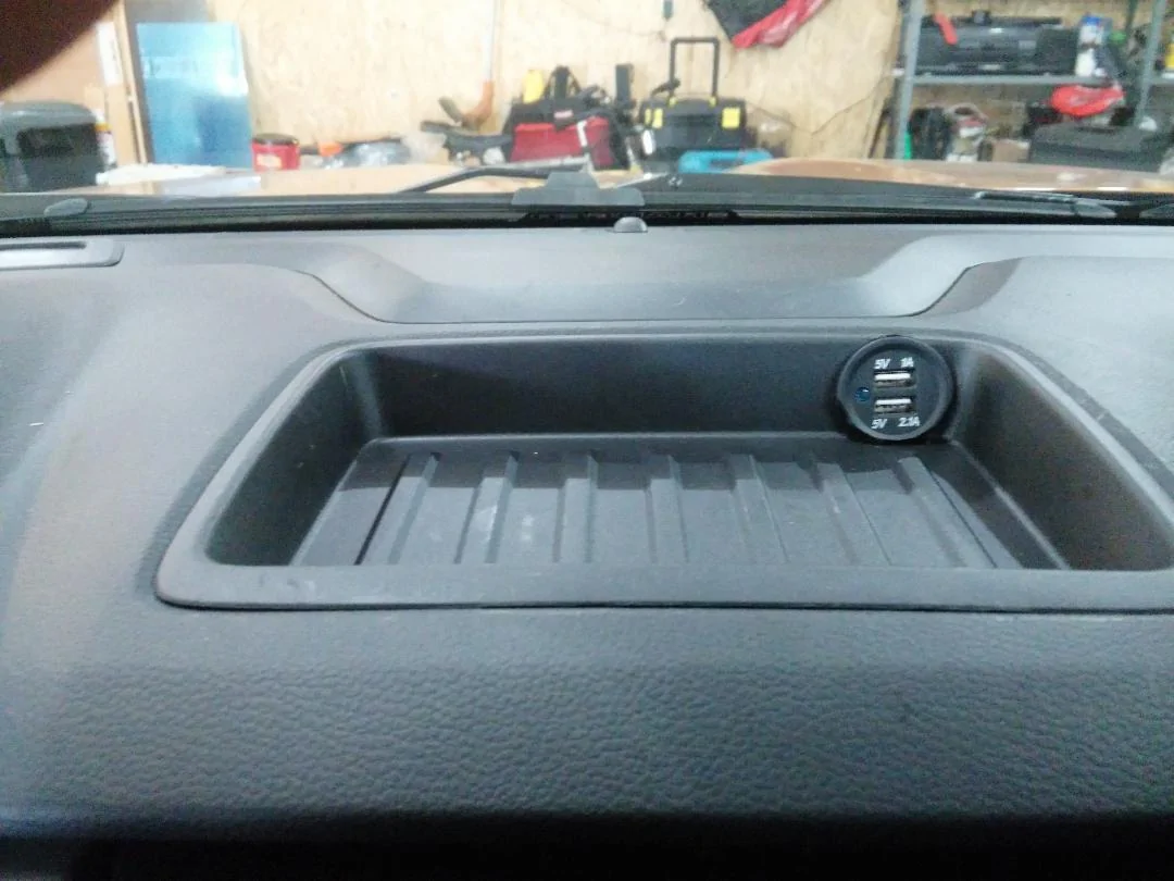

Thanks for the follow-up. I have a couple radios to choose from with detachable faceplates (Motorola XPR 5550 & CS800D, both used for DMR). I would like to explore a mic extension like you have so the mic cable doesn't have to drape across the nav screen. I like the clean look you have.
The Lightforce fascia has an RJ45 pass through as a switch option, I just ran a regular cat5 extension cable from the faceplate down to the fascia and it works great.

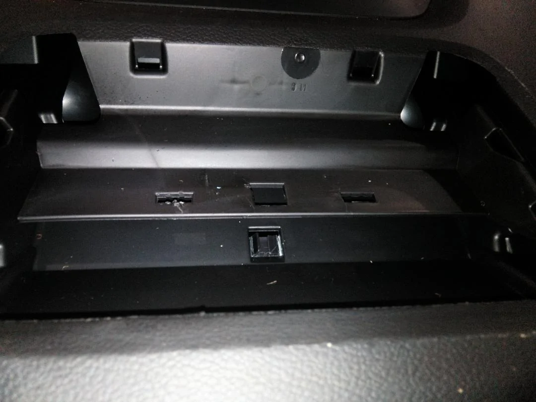

you may need to pull it rearward after the front(toward the hood) is seated just a few thousands of an inch.
I used a flat 1-1/2" scraper as a pry bar to align mine.
You might lightly heat the area with a hairdryer.

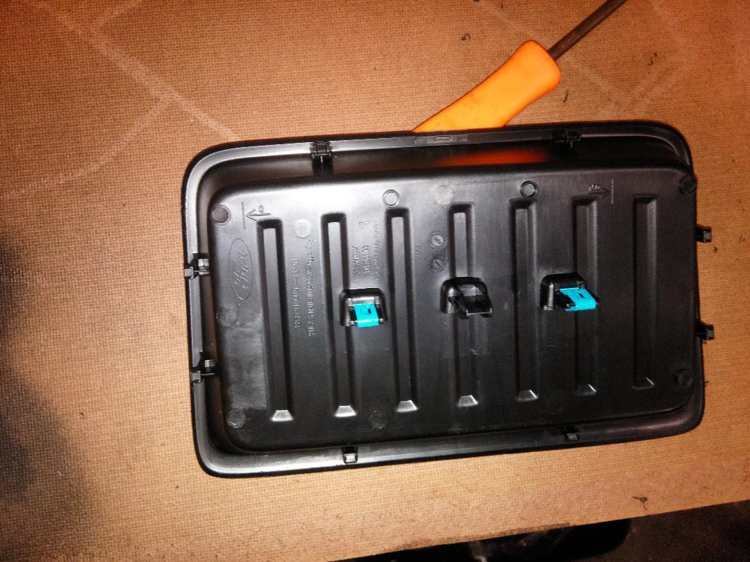

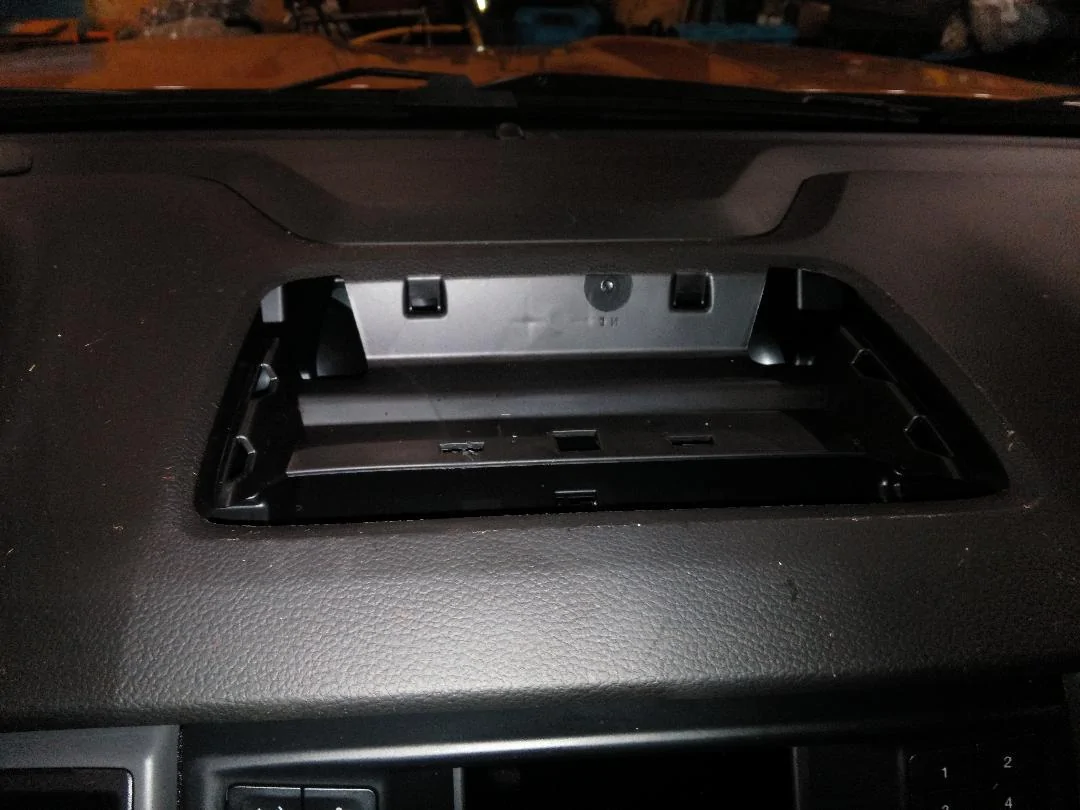

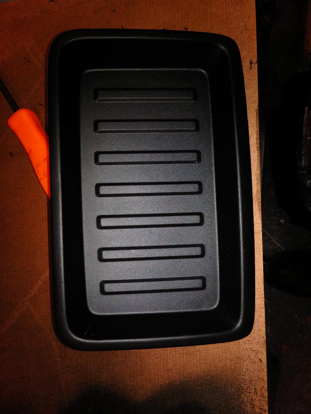

Thanks again for the photo with the tray removed. I really don't want to take mine out again unless I'm prepared to get the job done, yet I need to see what kind of room there is to run wires, etc. Any additional photos with the tray out would be appreciated!!
Floyd
Jan 6, 2019
2,064
3,132
illinois
these are the rest that I took, not much,but if you click on any of them they are pretty large.
