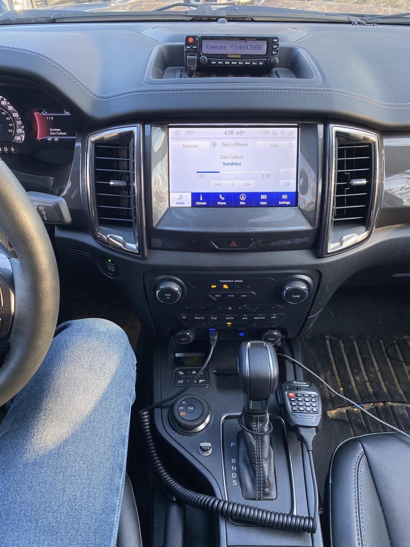

The "more finesse" way to get those tabs seated is to take a flat plastic trim tool and wedge it up above the touchscreen between the dash and the plastic that surrounds the screen. Push up against the bottom of the dash to support it and the clips will click right in when you push on them.

Once you clear the side tabs, the two tabs on the bottom are significantly sturdier and require more force. The closer you can get to prying on the bottom of the tray instead of the edges, the better.
It's an awesome spot for a radio face plate!
Also, if you're running wires down the dash to a Lightforce fascia or other spot down low, the left side vent pops out really easy and gives you a good intermediate point to aim wires around the nav screen. Use a plastic trim tool and pop them out starting at the bottom, it requires less effort to pop out than the plastic tray.

Thanks for the follow-up. I have a couple radios to choose from with detachable faceplates (Motorola XPR 5550 & CS800D, both used for DMR). I would like to explore a mic extension like you have so the mic cable doesn't have to drape across the nav screen. I like the clean look you have.
