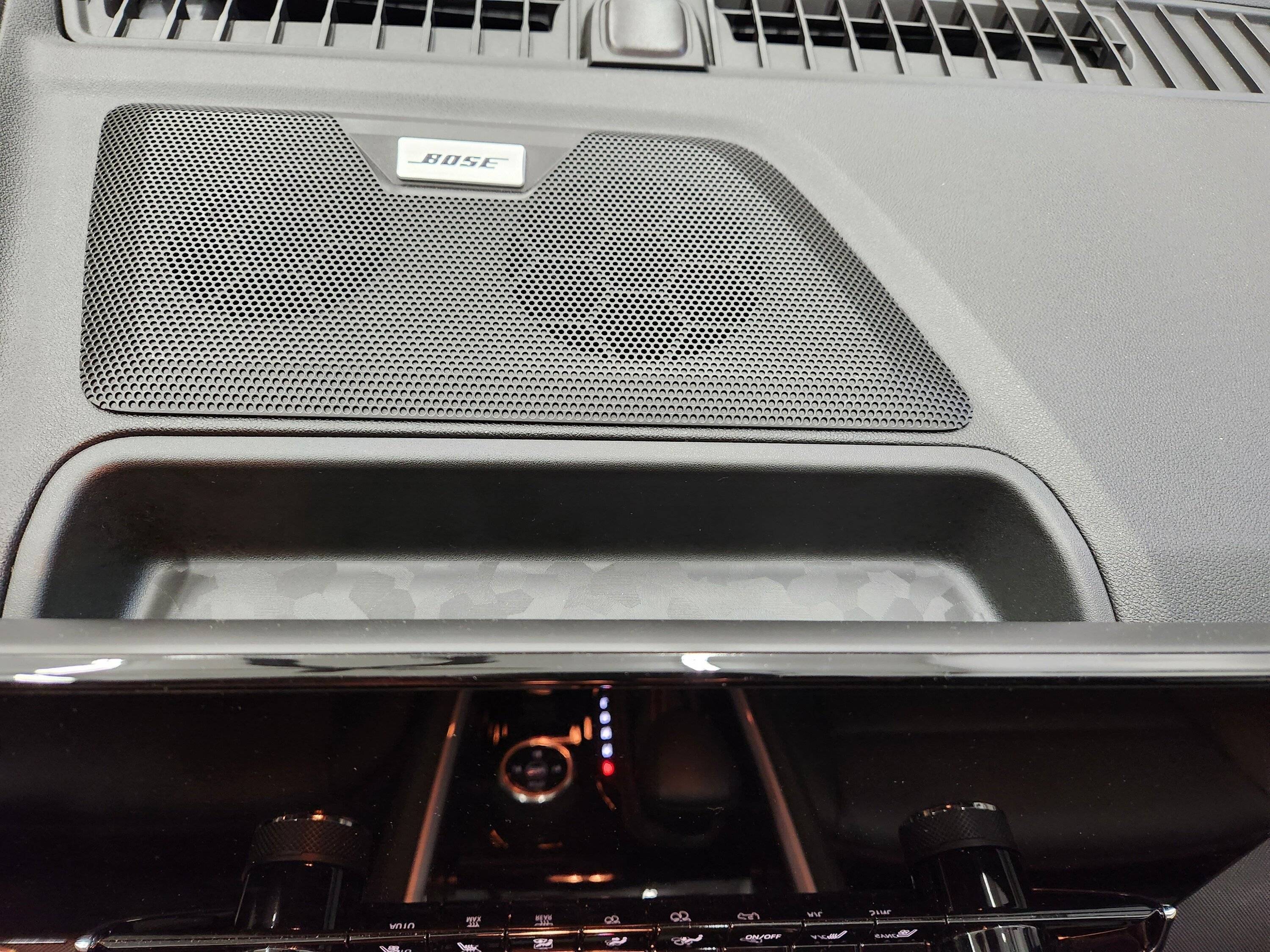

Still not as bad as the weird dash tray on the new Chevy Colorado. It’s hidden behind the infotainment screen and is quite small.
I think that’s a poor location for a chili dog tray.

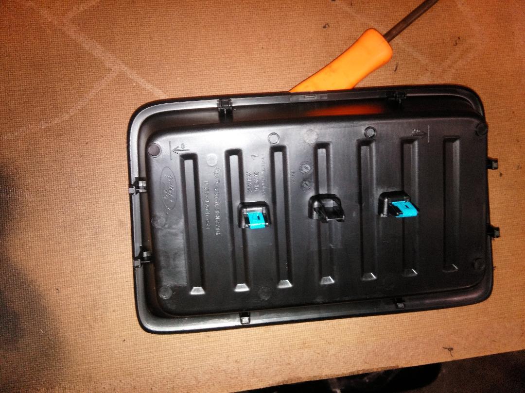

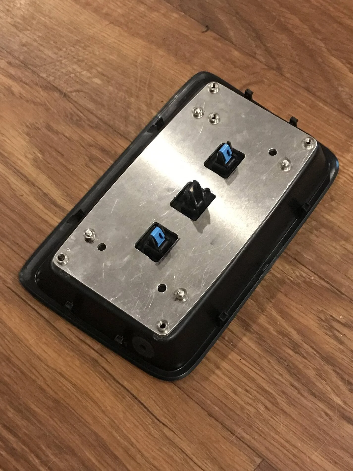

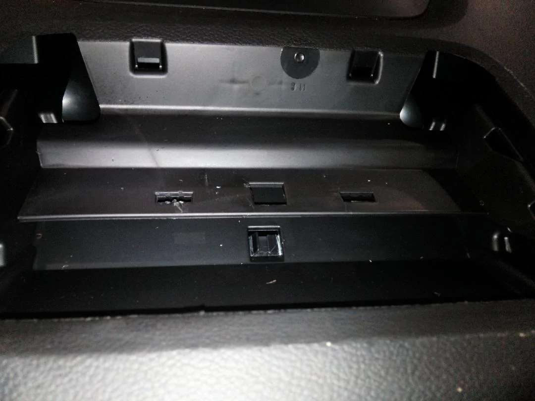

I went crazy ? Machined a back plate as I connected an arm to mine. It keeps it from vibrating. It’s tricky to get the insert back to full seating after removal. In the end with mine I decided to use threaded back blocks and fastened it down so I know it won’t pop out on its own from arm leverage. I post another of it installed with the arm on it.
Any chance you can make me one and sell & ship it to me?

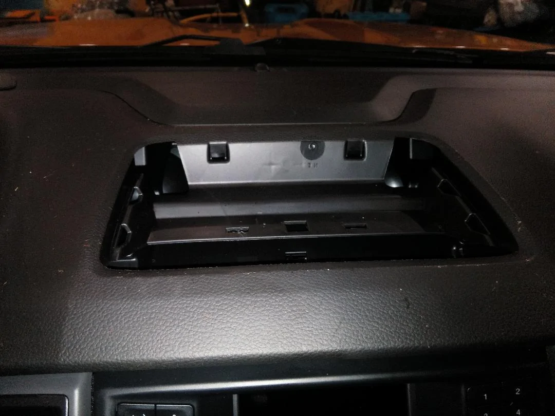

I just noticed that the photo in this post on page 3 shows the same issue I had, with a gap under the lip front & center. Just wanted to confirm if that's what you're trying to solve? The gap I had was a lot larger, though, but like I said it went away on it's own.
Before I remove my tray, is there any chance that there is a front and back for the tray and dash so that it will fit loose or tight accordingly?
