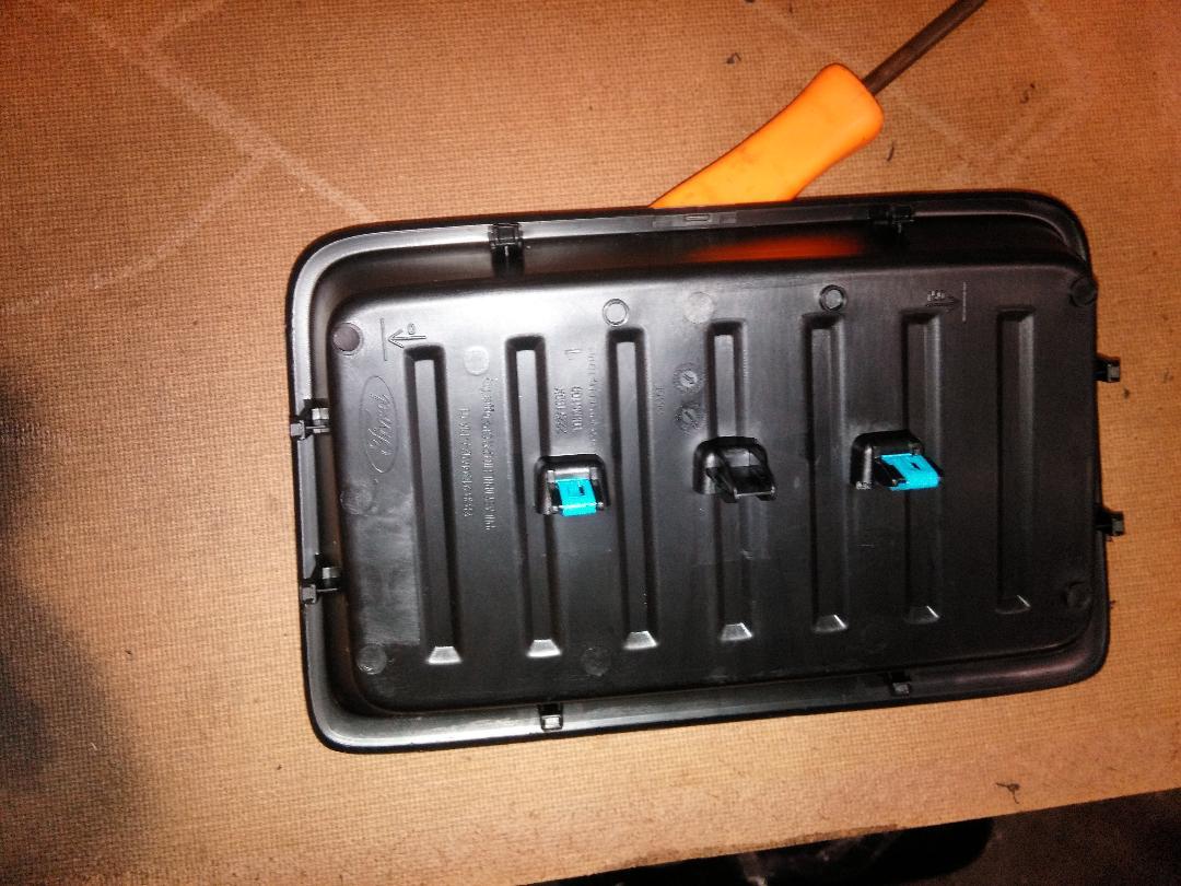

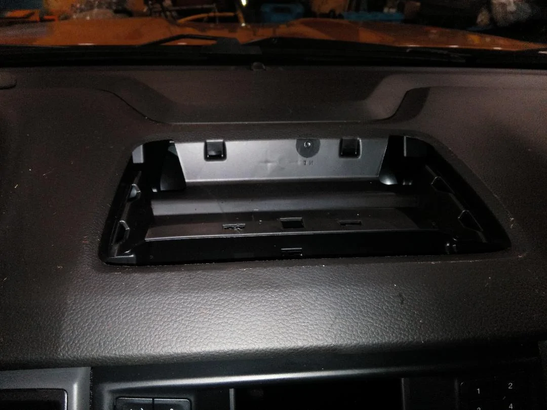

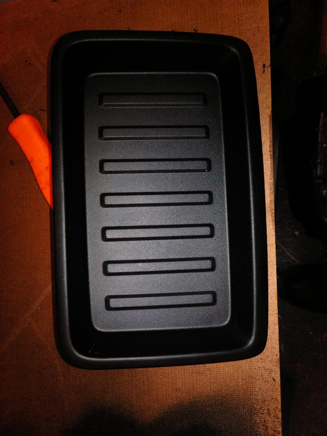

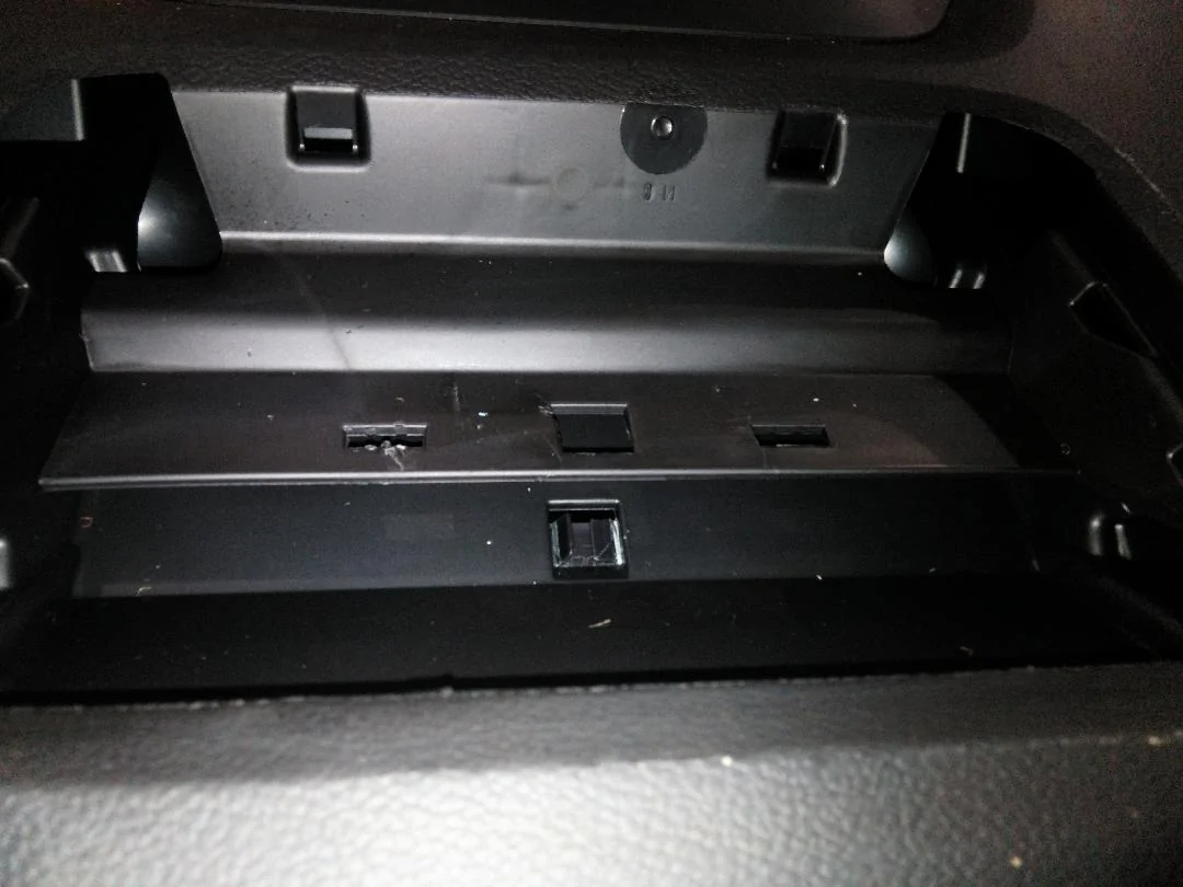

Worked up the courage and removed the tray on the Dash.
It does simply pry up!
CAUTION! the two blue fasteners are attached firmly to a flimsy part of the dash.
Care must be taken when prying them up.
Gently pry the edges up then lift the front enough to view the center fastners.
Place a long screwdriver between the fastener and the point of attachment then gently pry until they pop loose one at a time.
Mine came out perfectly without harm.

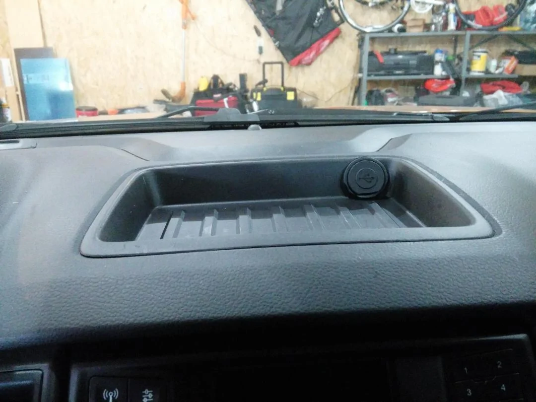

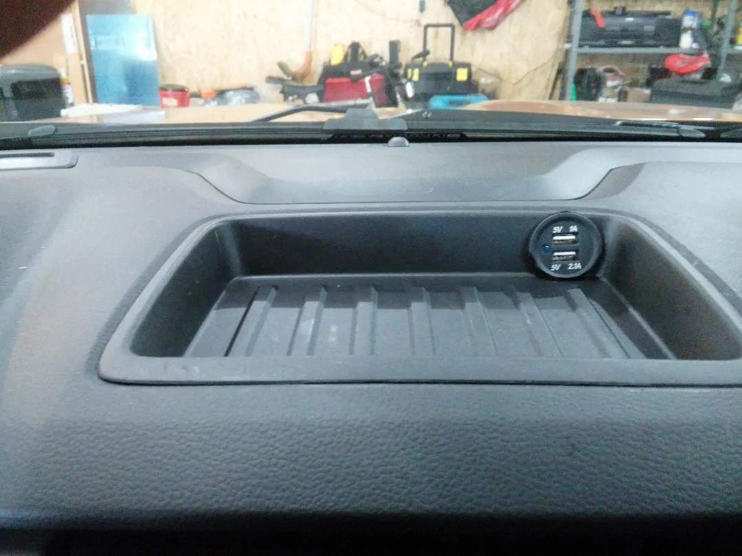

I plan to install a double USB outlet in the right rear corner.

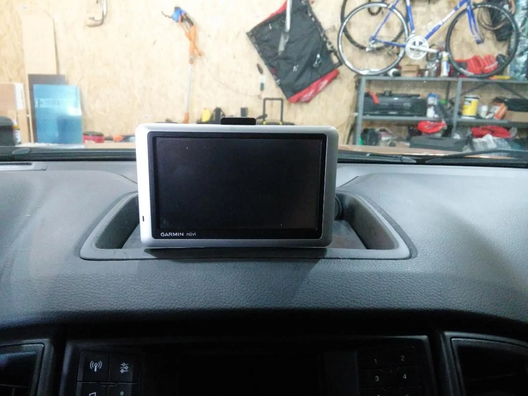

I got the USB units from EBay ( I bought a two pack with the bezels because I wasn't sure where I might use them. There are lots of them with varying power outputs on EBay)
I cut a piece of 1/8th" hard plastic to fit the tray to stick my GPS mount to.
After several tries I was able to fish the power supply wires down the right side of the opening
( corner toward the rear of truck) and along the left side of the glove box to be attached to the 12V power point in the lower dash.
