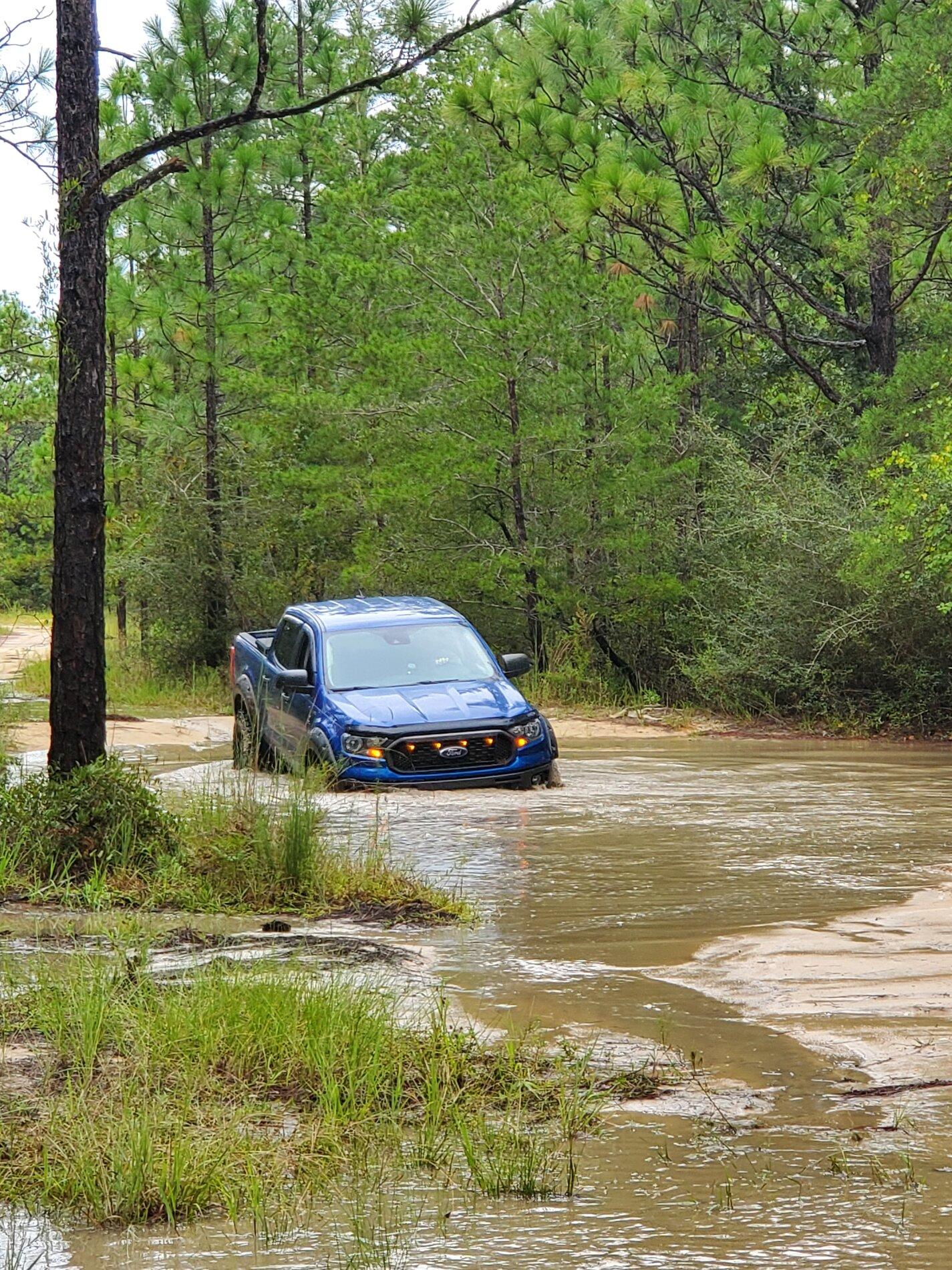

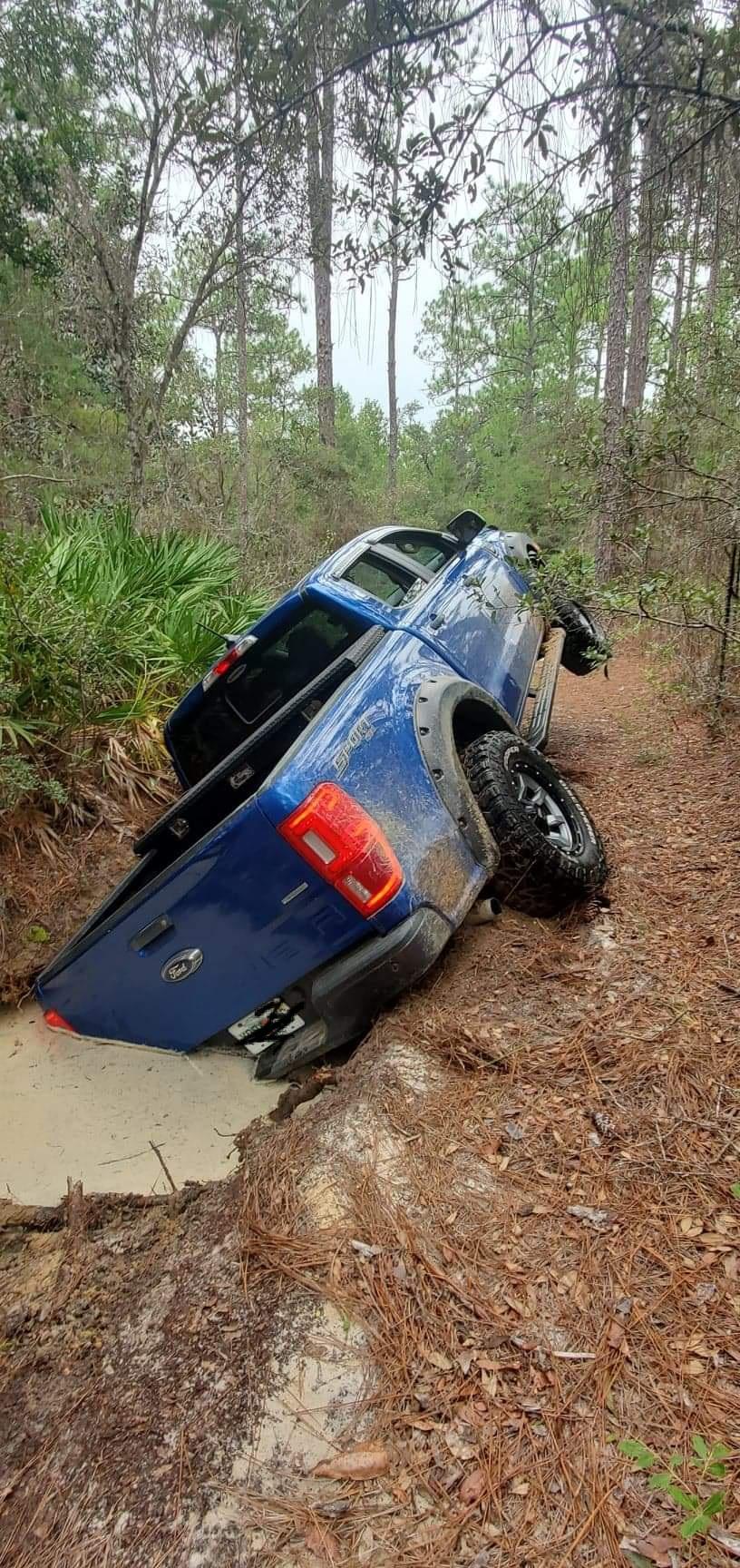

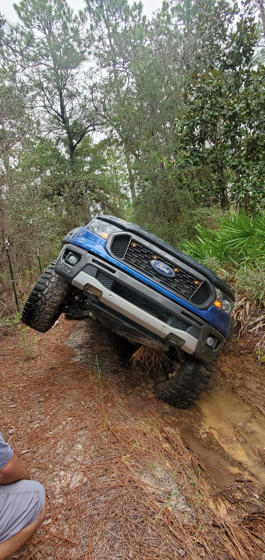

Most of you have already seen these images of my Summer adventure on other post. This is the reason to plasti dip. I try not to venture that far off the trail in the summer months. This go round I had my adult kids in their 4x4's saying, c'mon ole man lets go. Mistake, lol. I got lucky just a few minor scratches in the clear coat that buffed out.
Did anybody say that this would make a good Built FORD Tough poster. :clap: :thumbsup:
