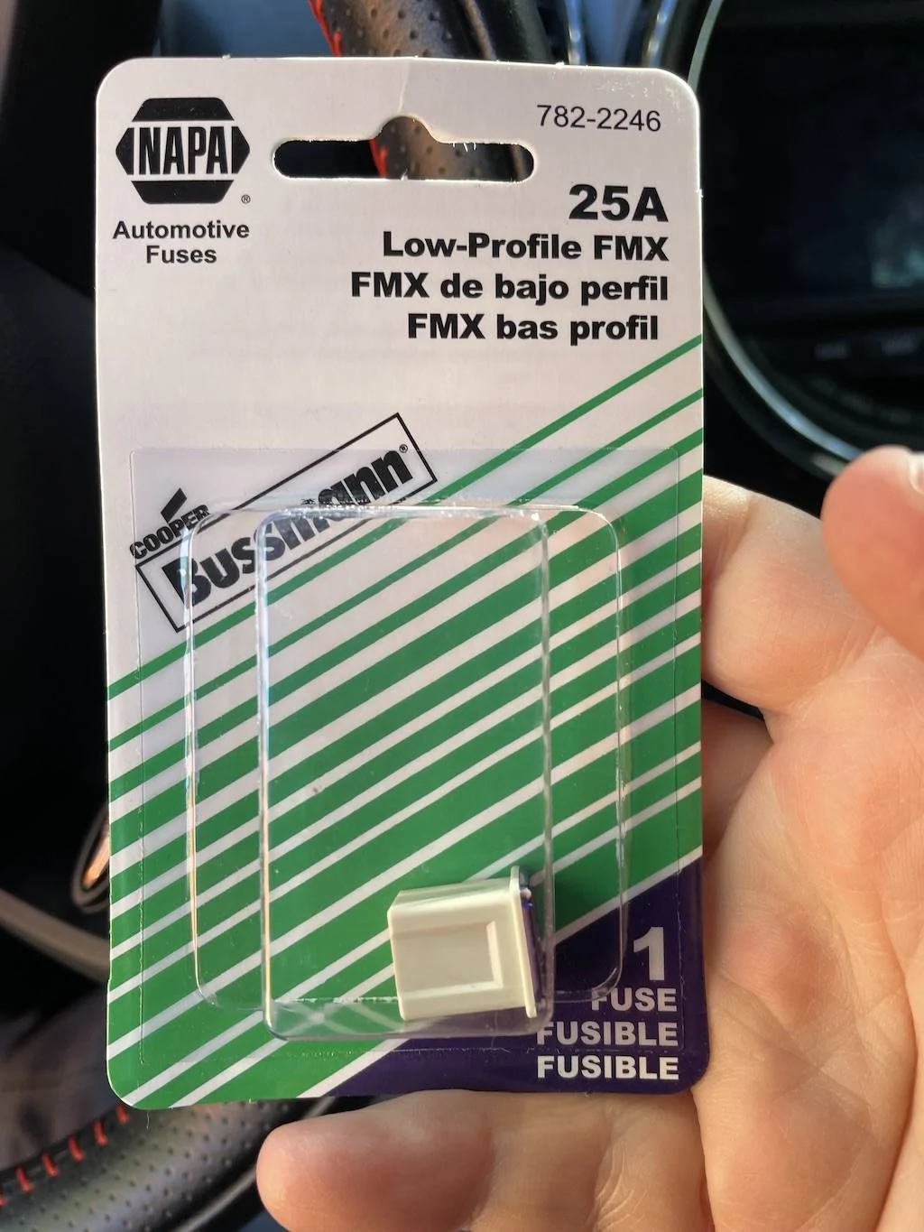

Old thread but I have a very related question: what exactly is "LPJ-type fuse" specified for fuse 71 from the owner manual? I'd like to order a replacement for fuse 71 because I suspect mine is either blown or missing. I'd like to have one on hand since getting the fuse box apart seems like a bit of a hassle. When I google for "LPJ type fuse" though I get some old 1920's glass tube fuses and I'm doubting that that is what is inside the fuse box...
Is it maybe like this kind? https://www.ebay.com/itm/225155276414 .

Talking to myself time, but rather annoyed at the user manual.
I guess "LPJ" is the same as type G on Page 261 of the owner manual: "J Case Low Profile" ("Low Profile J-Type"?). Wish the user manual would just say "See Callout G, in Figure Whatever", or that the figure on page 261 would say "LPJ / J Case Low Profile" or something. Anyway the dimensions match up to the fuse I pulled, so I guess that's it.
Now just waiting on the mailman, and hoping that it doesn't blow again -- getting to the bottom fuse box is a pain, getting the fuse box back into its socket is even more of a pain. Seems that these are slow-blow fuses so I do wonder why it would blow when there is no apparent short on the trailer...bought my truck used though, maybe it was blown when I bought it?

And, the final post.
NAPA has the fuse in question, but of course they call it something else. A "Low-Profile FMX" fuse, part number 782-2246. It is a slow-blow fuse, it fits in the socket in the fusebox, and luckily the parking/running lights are now work correctly (at least, on my magnetic lamps; I guess we'll find out later if the trailer has some fun intermittent short circuit that only reveals itself when it's actually moving). I think the 'slow blow' is important because trailer plugs may sometimes spark when you're plugging/unplugging them with the vehicle running, and a fast blow fuse would...blow, if it sparked, probably. But yadda yadda consult your Ford Dealer because who knows, maybe I'm wrong.
Anyway, hopefully the above photo helps save somebody a few minutes of fiddling with the lower fuse box, so they can just buy the spare fuse and have it on hand.
