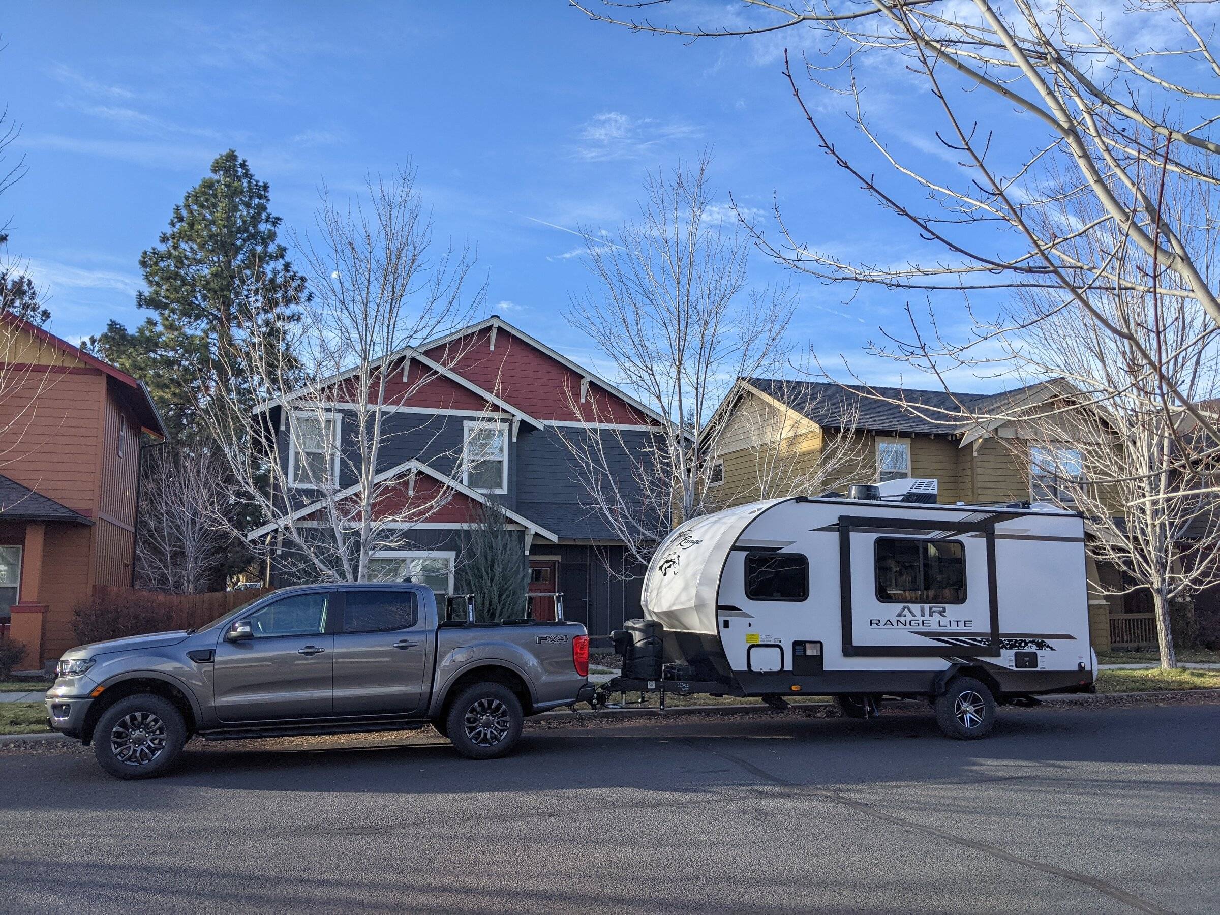

I tow a smaller version of that trailer, a Highland Ridge Range Lite Air 16FBS (which is a clone of the Jayco Jay Feather Micro 166FBS, the next size down from your 199MBS). Specs below:
Dry Hitch Weight (lbs)440
Unloaded Vehicle Weight (lbs)3,830
Cargo Carrying Capacity (lbs)1,165
Gross Vehicle Weight Rating (lbs)4,995
My Ranger tows it great. I have a 6,000 lb Fastway E2 WDH. Granted I have only towed 200 miles, but most of that was through the Cascades. I averaged 12.8 MPG according to the truck. Not bad considering I was crossing mountains.
I would be concerned with the tongue weight of the 199MBS. You are pushing the limit. A WDH will add ~100 lbs to the hitch weight.
I"m guessing the next size down for you is the Micro 171BH? I have a friend with that trailer. All of these series trailers are awesome, about the best you can get for a single axle. Not to spark a debate, but I believe the Feather Micros are nicer than GeoPros and other options mentioned. Some of the Rockwoods are nicer, but you are getting bigger with that. Between my friend with the Micro 171BH and myself with the Micro 166FBS (mine is a carbon copy made by Highland Ridge, manufactured by Jayco), I can give you an idea what to look for on your delivery inspection. I am happy to talk. My wife and I took about 3 hours to thoroughly check the trailer prior to driving home. The manufacturing is so rushed and hit or miss, you'll want to chat with me before you pick it up. Good Luck, Ed :)
Here is my setup. Note that I have since lowed the hitch ball height to level the trailer. The dealer did a half ass setup :(
