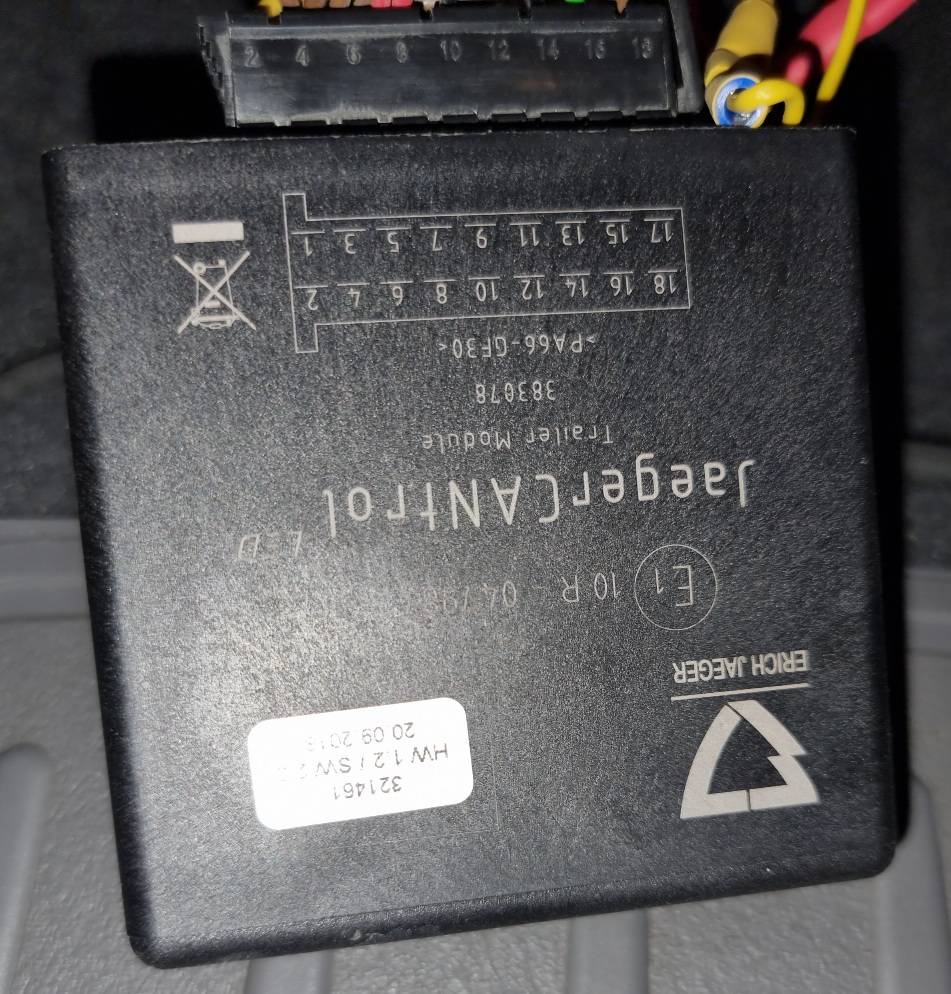

Found out it was the control module, local dealer is useless can't trace the part number, can't find it listed for sale online. It's a small box with 18 pins, was completely flooded and corroded.
