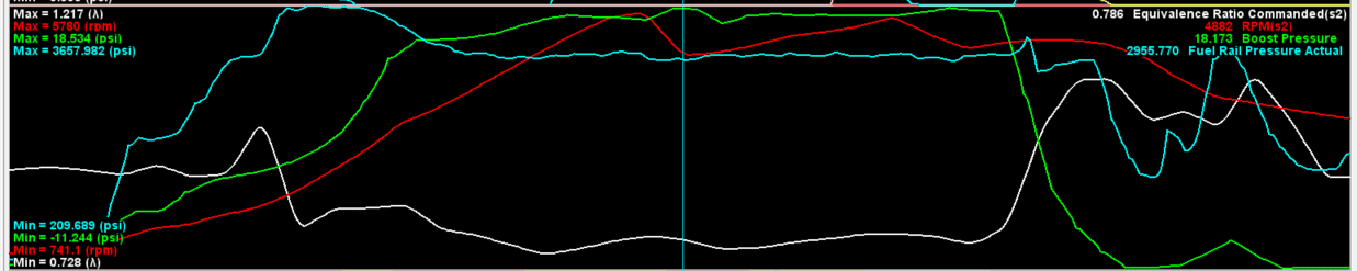

I've logged over 3,600 PSI of fuel pressure on my Ranger.
Ethanol will more likely clean the injectors, not clog them. Now, if they clean deposits in the fuel system (that is unnecessarily dirty), it can carry that particulate to the injectors.
