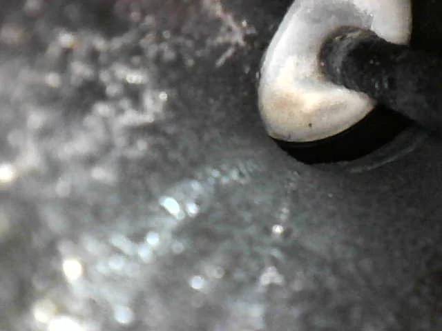

I thought the valve stem looked pretty crusty, too. backside of the valve looks good, however.
When I did the ones on my wifes old Tiguan at 83k that's how it grows, almost all of the carbon will be glued to the valve stem creeping down on to the face. I hope when it comes time to do the nasty on the Ranger the intake manifold is easier to remove than that POS FSI 2.0 turbo in the VW.
Hopefully when I take another picture at 50k we'll be able to see if the stem is building up more carbon or not. At the rate i'm driving that'll be sometime next spring.

Happy Labor day Ladies and Gents,
I've read way too much about intake valve buildup over the last few years and I was curious what my valves look like at 25k. I was able to
get my borescope into the intake manifold and get a picture of one of the valves. IMO it looks pretty good. I don't really see any point in wasting money or time on any extra preventative measures at this point. See below for my driving habits/maintenance.
I will try to get a picture of the same valve every 25k miles...
Maintenance / Habits
- Full synthetic 5W-30 (Valvoline) from the first oil change. No more than 5k intervals.
- Lots of towing (often times at max cap.), I would guestimate around 10k miles
- Most trips are at least 20 minutes
- I have not noticed any fuel dilution issues with oil
Thanks for posting this. Just the kind of real world data that is needed. Well played.
I'm curious what grade and type of gasoline you are using?
I use Regular 87 octane. I don't have any sort of preference towards brand.
HenryMac
Sep 14, 2019
2,783
5,360
Mech. Engineer - Retired
And that's good news. If you ran top tier premium fuel, the buildup would be even less.
I'm not really sure if running top tier fuel would make a difference in regards to the intake valves. The whole issue being that they're not washed with fuel like a port injected setup would be.
