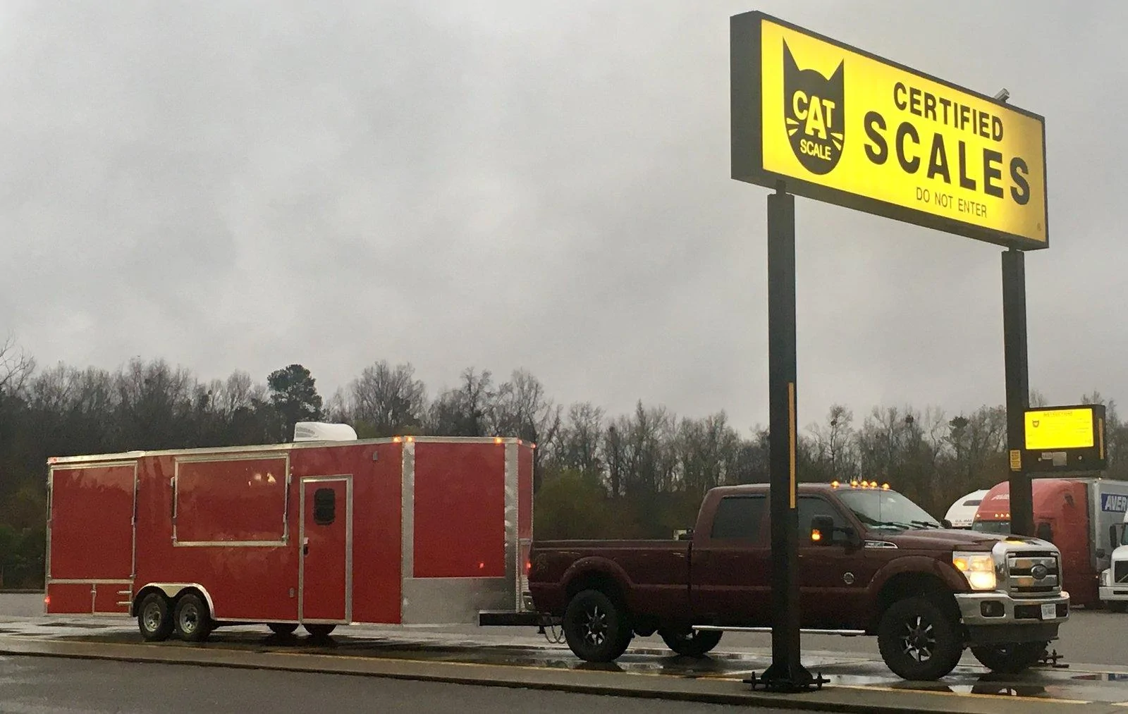

I have a cargo trailer that is 26’ long and enclosed. Fully loaded weight is 6,750. I only need to tow it a couple of times a year, and only like an hour or two each time. I live in the midatlantic at sea level nowhere near any mountains. Do you think I could tow it with the Ranger as long as I have a robust weight distribution hitch and anti-sway and trailer brakes/controller? I know the tow rating is higher than that but I dont know if it’s a bad plan anyway.

I wouldn't do it. I use to tow a 24' enclosed car hauler with a 3/4t Dodge Ram QC with a Cummins. Even with sway control that high profile trailer would push the truck around in cross winds and while passing 18 wheelers.

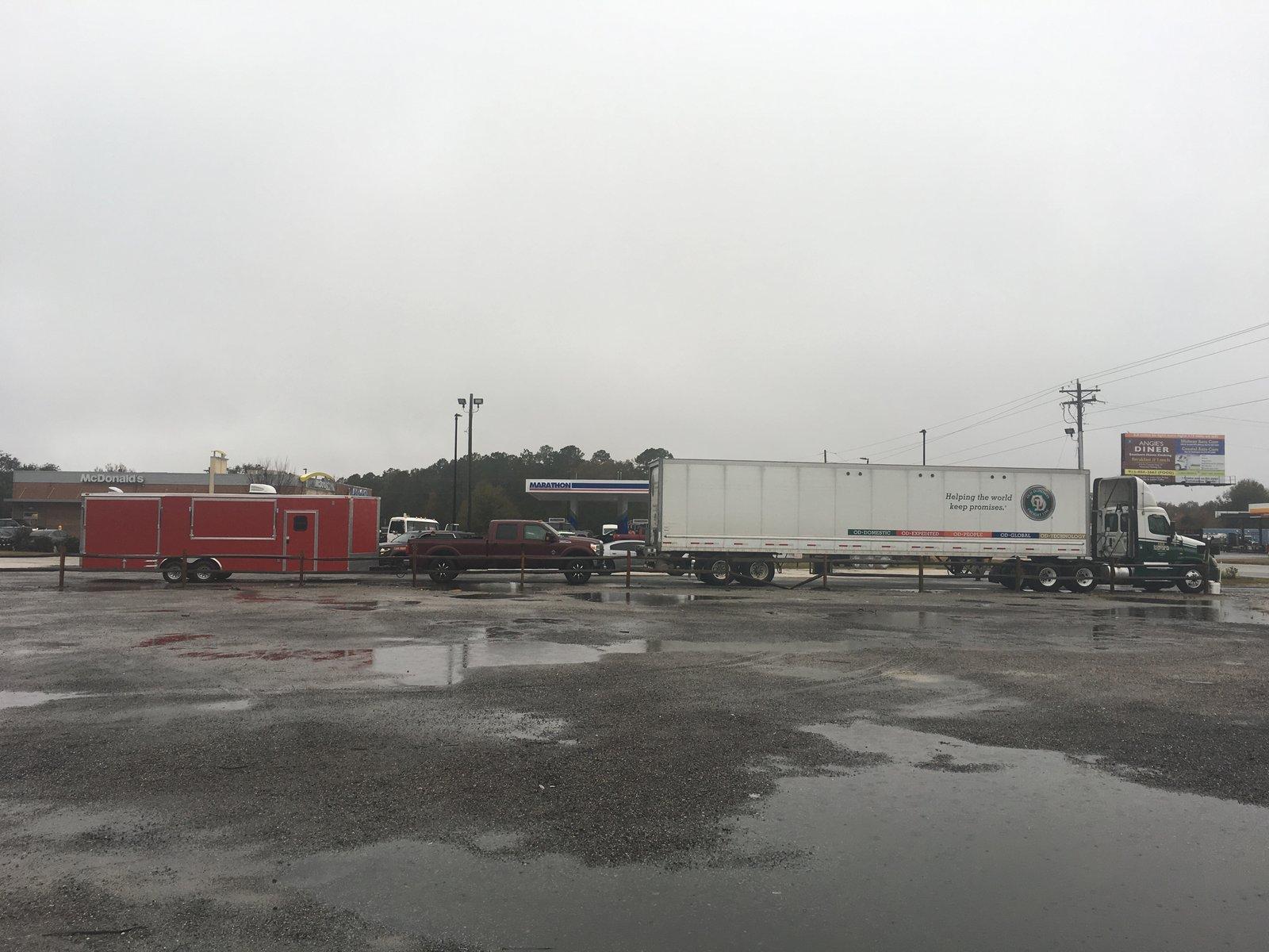

Yea. We pulled it empty with an f350 from Florida to Virginia and the semis even tugged on the f350. After that experience I’m pretty sure I’ll only tow it with a 3/4 ton. Especially on the interstate. We didn’t have sway control hooked up yet though so hopefully that and some weight inside the trailer will settle it down.

Yea. We pulled it empty with an f350 after my previous post from Florida to Virginia and the semis even tugged on the f350. After that experience I’m pretty sure I’ll only tow it with a 3/4 ton. Especially on the interstate. We didn’t have sway control hooked up yet though so hopefully that and some weight inside the trailer will settle it down. Even if it’s within the weight limits of the Ranger it’s the wind and tug from semis I’d worry about.

The truck is rated to tow a trailer when all acronyms fall in spec. The GCVWR, GVWR, FGAWR, RGAWR, maximum tongue weight all have their spec. You can have all of those covered with a properly weighted trailer and still dread the pull. It might pull great on a flat windless empty road. It could become an e ticket ride when you add in wind gusts and a flock of semis.
I haven't seen any videos of Rangers getting into trouble pulling barn doors like that trailer. Get a friend with a GoPro to follow in another vehicle. You could settle this argument once a for all. Is Mythbusters still in business?
